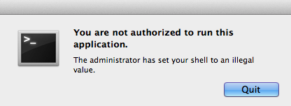

I've never had an issue opening Terminal until I upgraded to Lion about a week ago and when I try to launch the terminal, I get the following error "You're not authorized to run this application, shell has illegal value" (screenshot). I seen some posts dated back to 2009 but nothing is working for me. Any ideas?

I just did a comparison with my computer at work and it looks like /bin/bash is correct and I tried repairing permissions but still no luck. Is there something else that anyone knows of that i can try?
The link from the Apple board mentions /private/etc/shells. That file has a list of "allowed" shells. Have you checked that file? Mine looks like this:

I also have /etc/shells. Both of my files look the same.
Ironically, the easiest way to check this stuff is probably with a terminal. You can possibly get to one directly by opening Finder, hitting command+shift+g, and the going to /bin. From there you can double-click bash to launch it (unless the permissions issue stops you -- not sure).

Problem Solved
I found this solution on another website and it worked for me:
  • Use Go > Go to Folder to go to "/private"
  • Select "etc"
  • Command-I to bring up the Information pop-up (don't close it again till the end of this procedure)
  • Click the lock symbol in lower right corner to unlock permissions
  • Make a note of the permission setting for "Everyone"
  • Click the permission setting for "Everyone" and select "Read & Write"
  • Use Go > Go to Folder to go to "/private/etc"
  • I found that "shells" was empty, but there was a "shells~orig" with a good list of shells in it
  • Delete "shells"
  • Select "shells~orig"
  • Command-C, Command-V to copy-and-paste it; this creates "shells~orig copy"
  • Select "shells~orig copy
  • Click again to enter rename mode and change name of "shells~orig copy" to "shells"
  • Return to the Information pop-up and change the permission setting for "Everyone" back to its original value
  • Close the Information pop-up
  • Restart computer
  • Enjoy Terminal!
Thanks a TON everyone for your help on this. Much appreciated.
