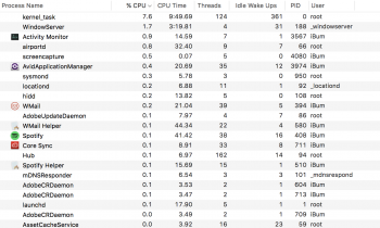

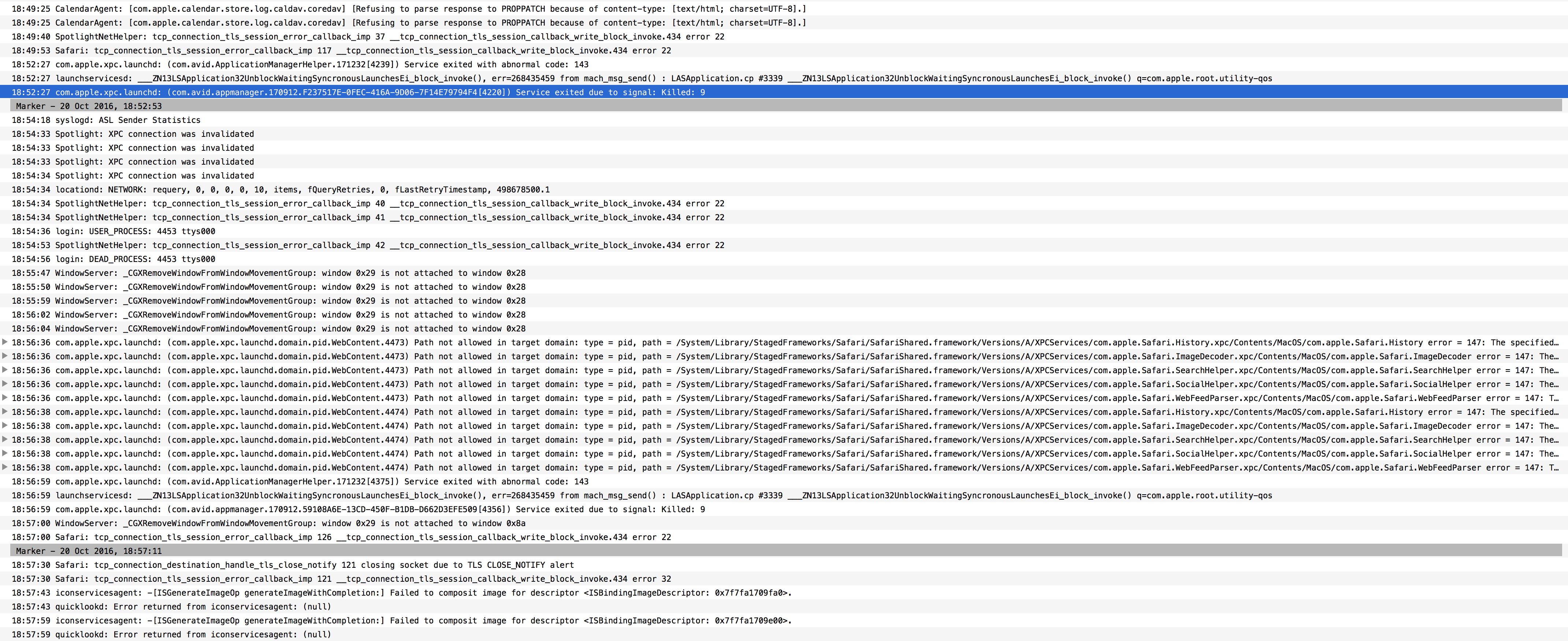

[doublepost=1476986498][/doublepost]I've taken a shot of the Console and marked each time the loss of control happens. You can see each time it happens by the greyed Marker line
If the blue line in your screenshot is when the problem occurs, it looks like the problem may be the Avid Application Manager. You can stop it from running at startup by following these instructions:
http://www.pro-tools-expert.com/hom...ger-from-launching-at-startup-mac-and-windows
You seem to be right! I have quit the app and am no longer experiencing the issues. Thank you very much!
Very strange though, I can't seem to find anyone else having the same issue with it. I'll be contacting Avid.
