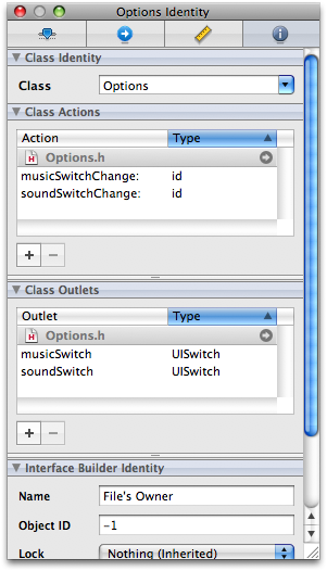

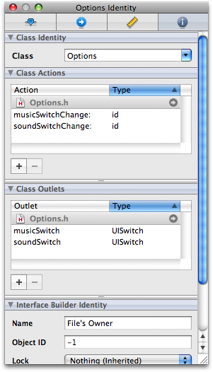

My app has multiple views but the screen that isn't working is the options one. The Inspector says everything is correct :S

What is the class called Menu?
So this happens when you are pushing a view controller not when the app starts up?
The nib-loading machinery thinks that the class called Menu should have the musicSwitch outlet but you show that the class is called Options.
Menu is the screen that links to the other screens via the switchViewConroller class.
OK. So that class doesn't have the outlet musicSwitch. That is the cause of the run-time exception. You need to look at your code and your nib file and see why the system is trying to make a Menu object when it should be making an Options object.
