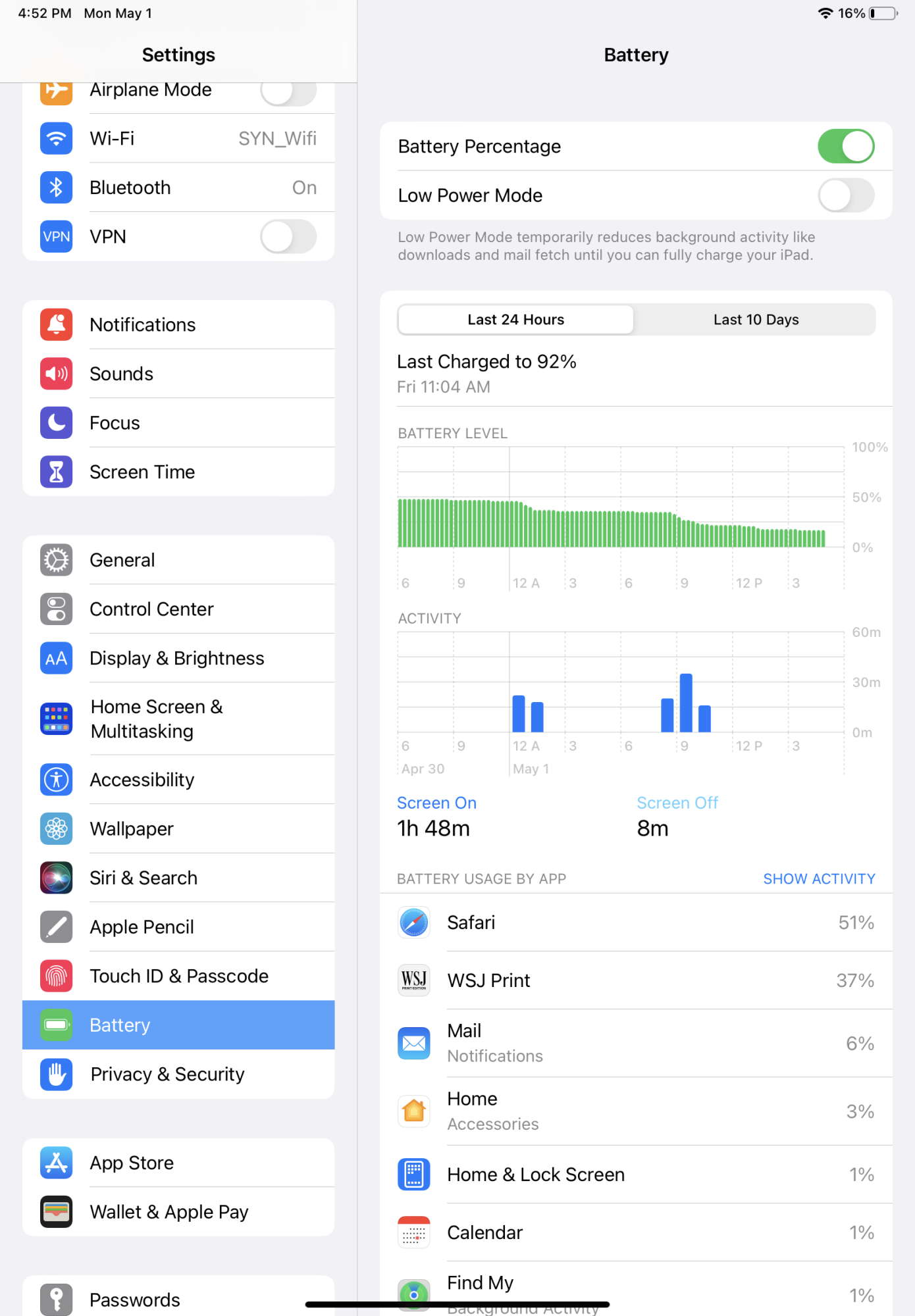

I charged it up to 92% Friday and now down to 17% after less than 2 hours of use. Any advice? I use my iPad for reading and I bare get a few hours! So disappointed while my 2021 M1 macbook pro easily gets close to 20 hours!
Check my numbers, not even 2 hours of on screen and 8 minutes of off screen time. I checked it at an Apple Store and they said no issue with it.
I have the latest sw and I think I have optimized it but anyone else seeing the same? Is there some settings I need to change?
The chart is showing from approximately 6pm the day before to now and is showing decline from that point, not just 2hrs. Seeing that WSJ and Safari are using the bulk of the battery, did you have anything downloading on Safari in background. I’m not familiar with the WSJ app, but does it try downloading and caching articles in the background? Also, did you click “Show Activity” to change those percentages to minutes? That will give you perspective on time used by those apps.
With so little screen-on time and so much standby, it’s honestly difficult to tell.
As far as standby goes, it hasn’t been good on iPads since iPadOS 13 (and it hasn’t been good on iPhones since iOS 12). For a very clear example, see: https://forums.macrumors.com/threads/what-happened-to-the-legendary-standby-time-of-ipad.2376100/
I’d suggest you try to use it with less standby. If the cause is standby, I don’t think there’s anything you can do. You can try the usual standby drain culprits like push Mail (unsure whether that’s on, but mail shows up on your screenshot). Apart from that... yeah, standby is abhorrent for any and all iPads since iPadOS 13.
Are you sure? From what I can tell, even though you charged it to 92% on Friday, you probably used it on the weekend, because on Monday at 6am the battery was down at 50%. So you went from 50% down to 17% in 1 hour 48 minutes. If you had started at 100% the battery would have lasted over 5 hours with the screen on.
Or did the iPad really drain from 92% to 50% over the weekend on its own? That would be too much. If you switch the graph from 24 hours to 10 days we could see that.
