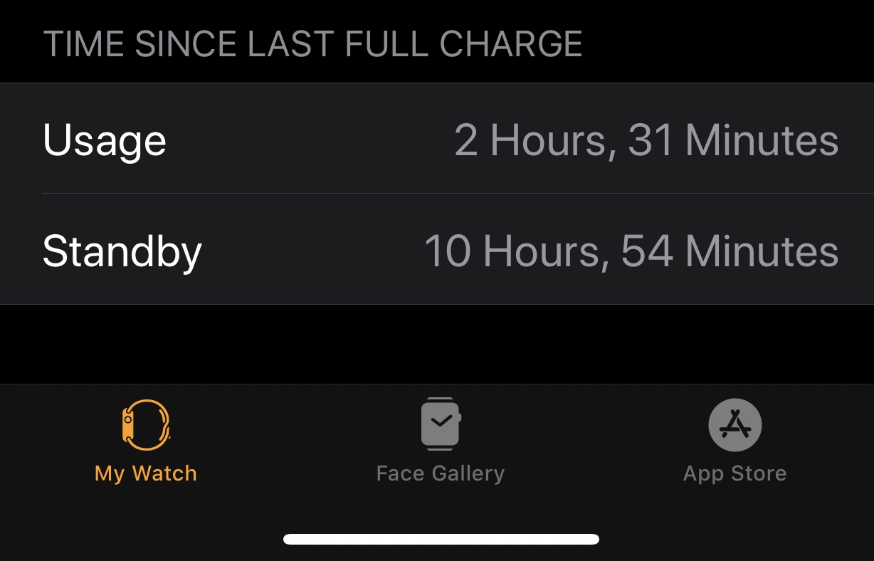

Got 63% left at 14.15pm
2 hours, 54 mins usage
6 hours, 43 mins standby
Just hope the workout at 6pm will not make the battery die too early

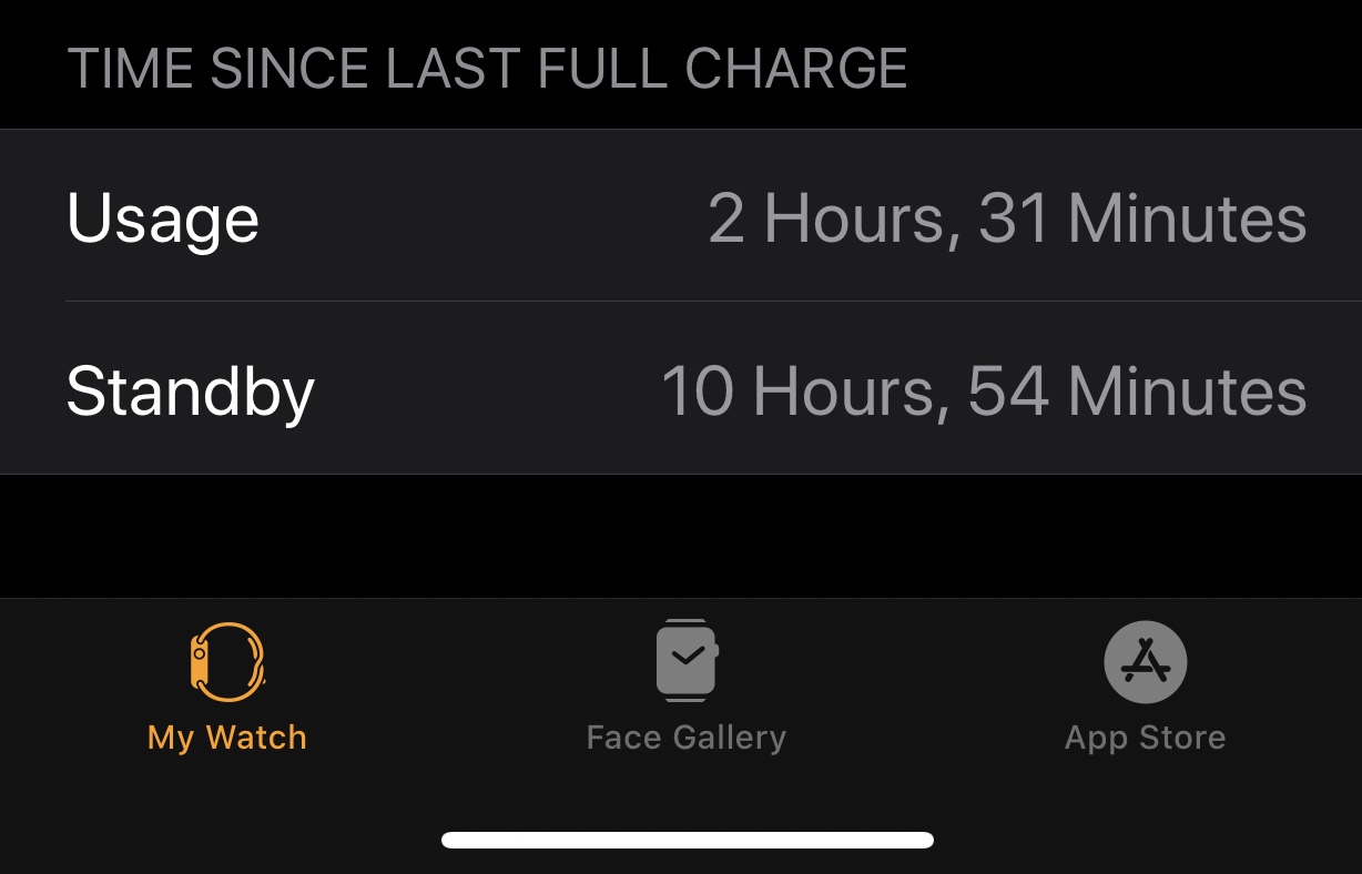

So almost 5.5% per hour. Thats 16.5 hours to low battery warning @ 10% without any workout.
