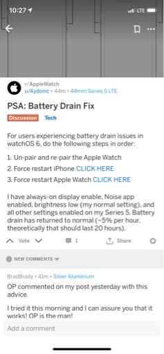

After testing from 100%, just turning off AOD, noise sampling on, all apps fetching data in the background I'm only loosing about 5% every 3hrs which should get me two days easily. With AOD on I'm losing 5% an hour.

Seen on Reddit

FWIW, I had issues after installing OS6 on my Series 4. Unpaired, then paired again. Restored from backup. No more issues. I’m thinking there was a hiccup as it upgraded on wi-fi while I slept. :apple:

My 44mm SBSS S5 is also suffering with poor battery life. AoD and sound monitoring are both on. I got 12.5hrs yesterday (1st full day) and it was down to about 40% after about 8hrs use by 5pm today when I un-paired it, re-paired it and then force reset both the iPhone and the Watch. This hasn't helped - it lost 15% between 5:30 and 6:30pm!
