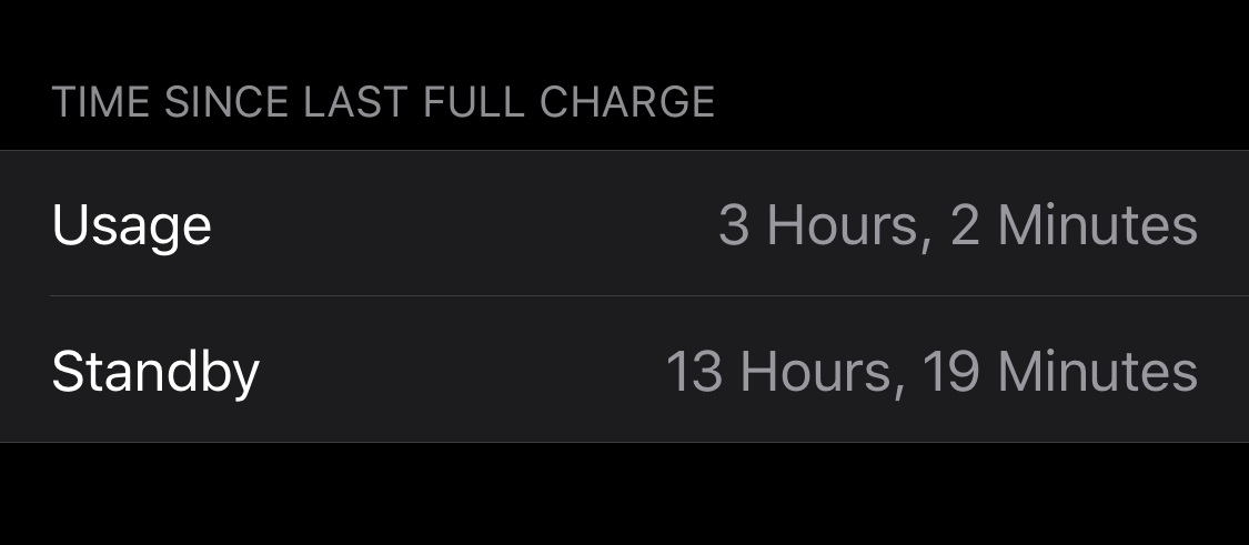

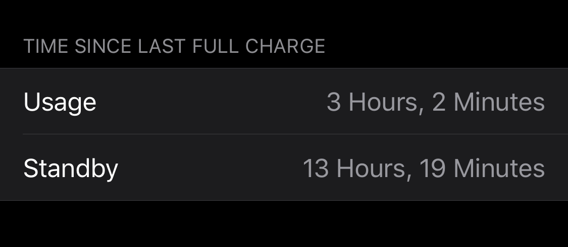

Just got my s5 Apple Watch. On the first charge - 4 hours 33 minutes of usage and 25 hours of standby. Still had about 7% remaining. One workout for about 30 minutes.
Settings:
hey Siri off
backgournd refresh off
rasise to wake on
always on display on
noise off
Reactions: techno-Zen
So this is about 3.7% per hour of standby. I think it might be more useful to report battery drain this way, so that people who don't wear their watch for 24+ hours can still compare their drain, to see if it is in line with what others have.
My battery drain each day is between 3.2% and 3.5% per hour.
For the people who have watches that last 28 or 39 hours, what is your actual per hour battery drain?
Reactions: Otflyer

Just got mine yesterday, today is the first day of full use after a battery charge. I have AOD and everything else on. From 9:30am to 12:30 I'm down to 88%, is this typical? Doesn't seem terrible, although I would worry about my morning workouts which I didn't do today.
sounds fine to me
Exactly how much I get. Around 4% per hour discharge.
So maybe my watch is better than I think it is then. I get a drain of about 1.5% the first two hours, then 2 and after 4 hours it is 2.5 to 3% and by 6 hours it is 3%. So my concern is the drain is accelerating without me doing anything different than checking the time and looking at the occasional notification. is this a good battery? I checked it out in an Applestore but the measurements showed battery was ok. I have most things turned off except AOD. No noise, RTW, no cellular, lowest display intensity, no Siri unless I use the crown. Don’t understand why it doesnt show a steady drain instead of an increasing one,
Seems fine to me
From 7.30am to 2pm mine is on about 76% left
This weekend I've done a bit of an experiment. I charged my watch completely just before bed on Friday night, wore it all night (theater mode), all day Saturday (including about an hour workout at the park), and all Saturday night (theater mode again). When I woke up Sunday morning it was at 11%, and it had been off the charger for 1 day 9 hours. So that is 33 hours - 16 sleeping (2 nights) and 17 awake.
The watch is a 40mm aluminum GPS, I've had it about 5 weeks. I have everything turned on except the noise app - so AOD is on and RTW is on. I used at least 4 different watch faces during that timespan. I didn't do anything to try to conserve energy at all.
Battery life seems all over the place and I can't really figure out why. The past couple of days I'm seeing about 4%/hour. But today, nothing changed in use or settings, after 4 hours of use it was a 99%. Currently it's been on my wrist for about 7 or so hours and it's at 92%.
92% after 7 plus hours is not bad at all.
