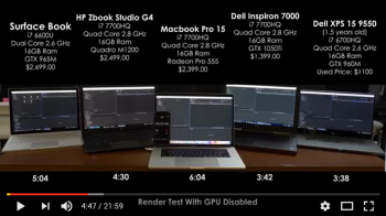

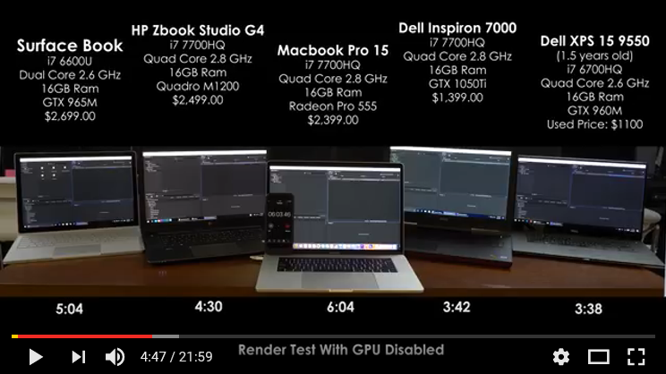

Do you know about this: "Kaby Lake Macbook Pro VS 4 Windows Laptops, Way Slower", see here
The shocking result of a rendering test can be seen at about 4:40 into the video
I found this very strange, but there are many similar tests to be found on you tube.
