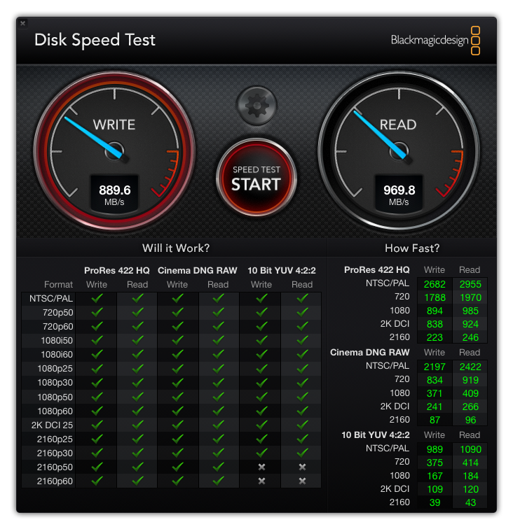

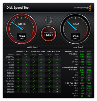

I'm gonna hijack this thread as well. A year ago I successfully set up my MBP 15" with two Samsung 850 Pro 512GB SSDs in RAID 0. Those were my read/write speeds:

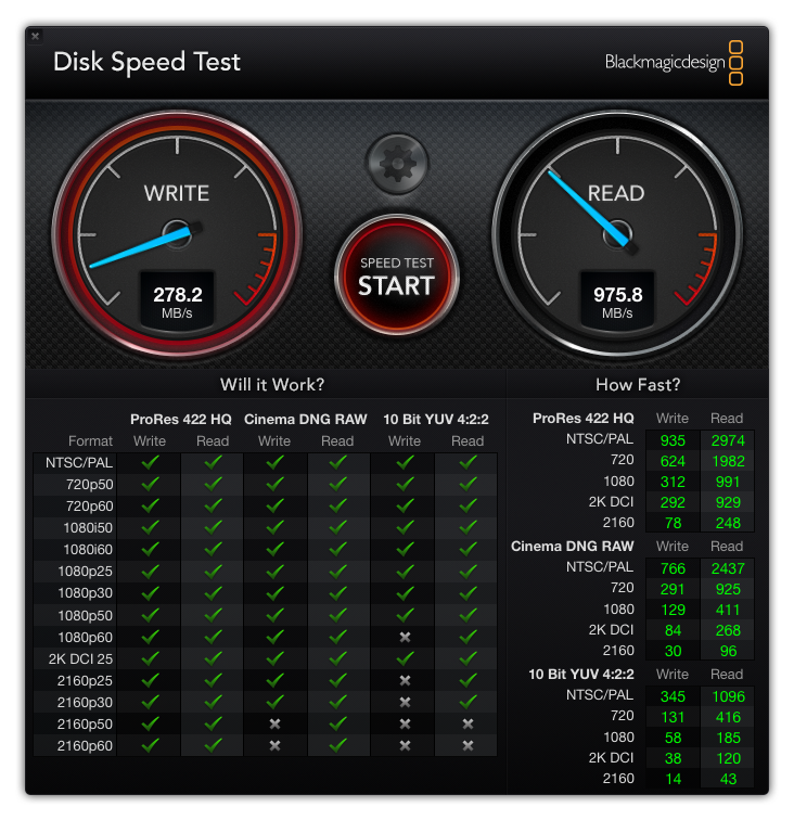

Now, a year later, I get these write speeds:
I haven't found a solution yet. If anyone knows what to do, please share your insights. Help is much appreciated. Thank you.
I actually fixed my problem on both of my Macs by 1st Un-RAID'ing the two Samsung 850 drives, then re-formatting by writing zero's to the entire drive. This restored the original read write speeds I got when I bought the drives. I reformatted with zero's using a program called SoftRAID.
The cool thing about softRAID is it is free if you only want to do RAID 0 (and not RAID 5 etc). This gives you the utility function to write all zeros do you drive. I actually switched from hardware raid to software raid with almost no loss in performance
The other problem you have is it with normal hardware raid you cannot utilize Trim Enabler. However, with softRAID you can. I am hoping with soft raid and a trim enabler, I can avoid this problem in the future. Time will tell.

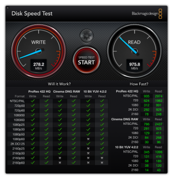

I would fault the testing software, personally, and would check with different software. The read speed looks about right mind you.

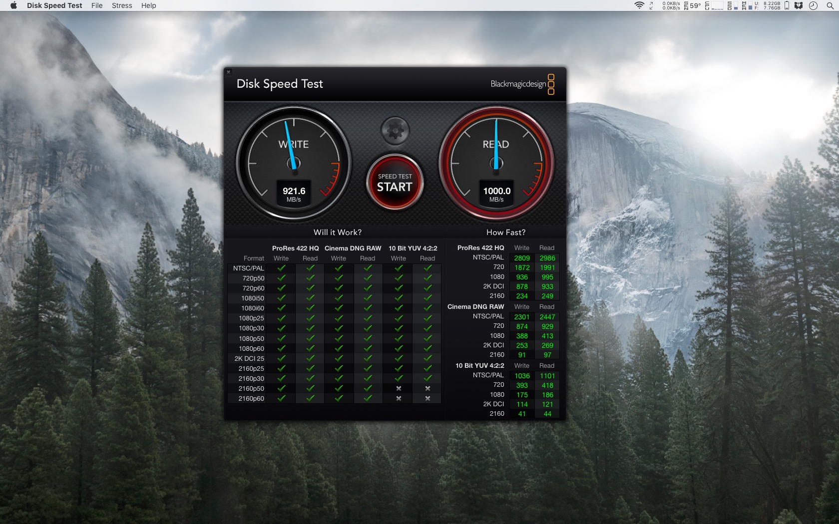

back up and running fine:

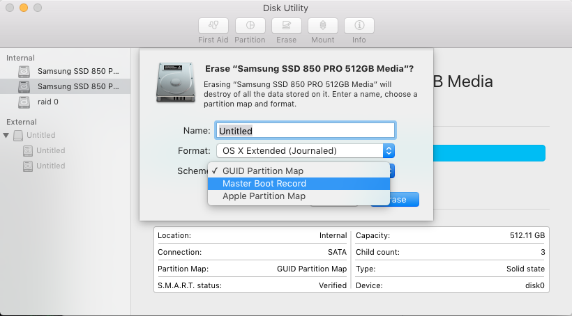

3. Open up Terminal and destroy RAID settup (diskutil appleRAID delete diskidentifier)
4. Go to Disk Utility and reformat one of the drives as Master Boot Record – the other as Apple Partition MapScreen Shot 2017-11-13 at 14.09.29.png
5. Create RAID in terminal
6. Reboot while holding down option
7. Boot from your bootable backup drive
8. Open up DiskSpeed Test to determine whether your speeds look a-ok.
9. Copy files from backup to your main drive. Done.
