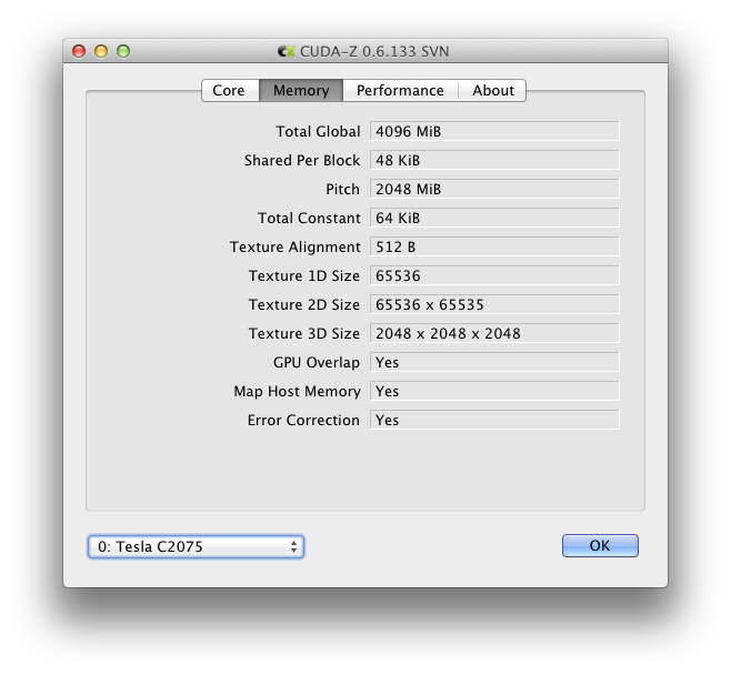

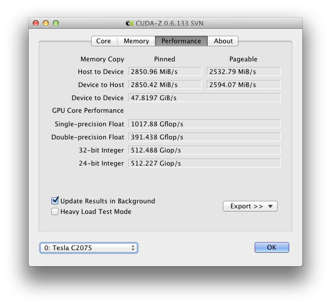

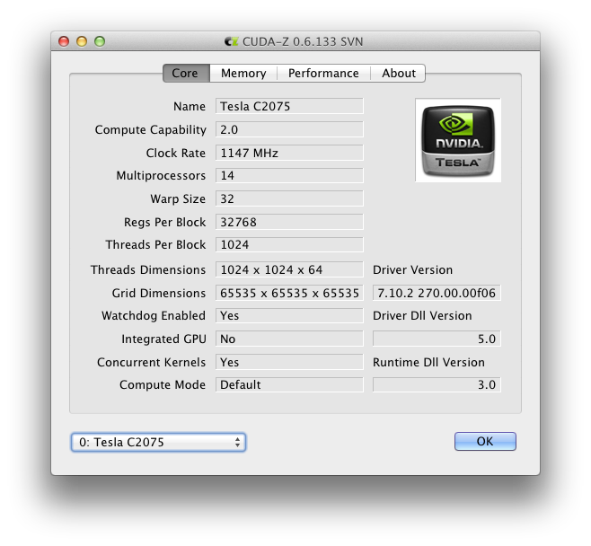

Just plugged in using existing power cables (only requires 2 x 6 pin).
Haven't run any benchmarks yet but CUDA-Z screen shots attached.

CUDA-Z is showing 4096 MB, you will find that openCl can see all 6GB.

Will be nice when the 6GB shows up everywhere.

All 6Gb is available in GPGPU apps, though as noted by OP, Mac OSX can't see it all. Simple cosmetic issue, the RAM is there.

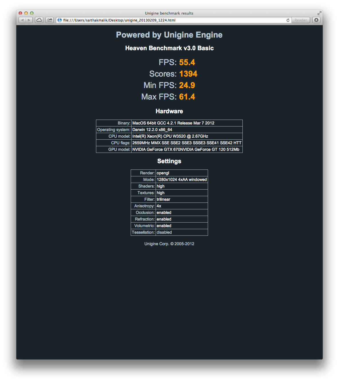

Benchmark attached.
The GTX 670 seems to be equal in performance (at least by Heaven). But the Tesla is one awesome card!

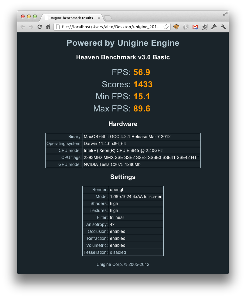

Just ran a test on my MP with the same settings.
