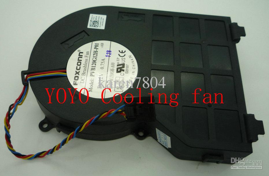

I've been thinking on put an axial blower on the end of the card casing. Don't know how to deal with cfm or noise, but I think it could be done.
