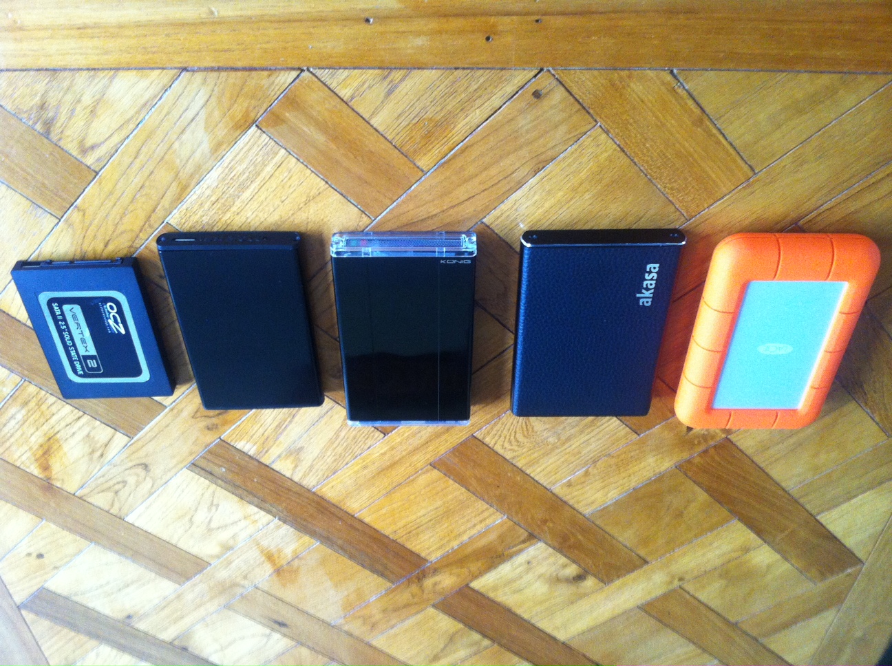

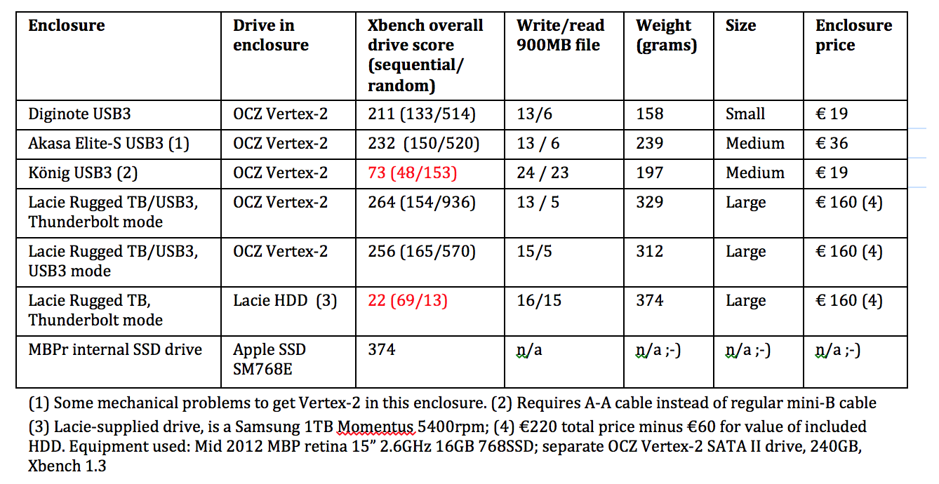

I took an OCZ Vertex-2 240GB SSD that came from a previous computer and tested in in several enclosures I had available. I also compared these to the internal SSD of the MBP itself. These are the results (for whatever its worth, I’m not a professional tester, but want to see myself what works best for me):
My tentative conclusions:

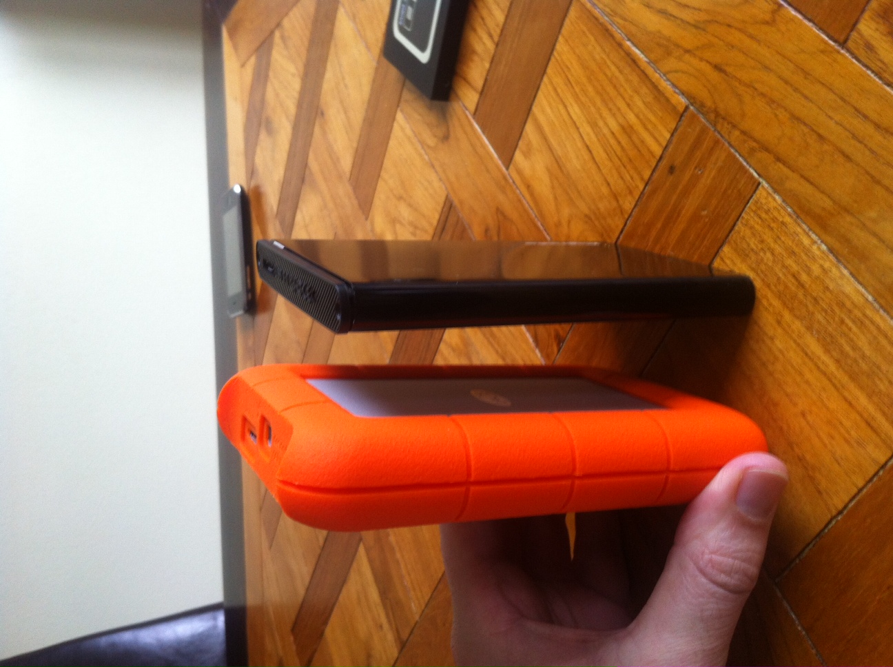

  • The Lacie Rugged in TB mode is hardly faster than USB3. This is true for cheap USB3 enclosures as well as for the Lacie’s own USB3 mode. The enclosure is well crafted and sturdy, but also big and heavy – adding almost 20% of the laptop’s weight in to bag.
  • The cheapest USB3 enclosure I tried, called “Diginote USB3” had a very good performance but also is very portable and solid made.
  • One of the cheap USB3 enclosures I tried (König CMP-MOBSTORE96) had an abnormal slow performance. It also required an unusual cable (USB3 A-to-A).
  • Not surprisingly, the only HDD I used compares bad to the SSD. However, in the real life copy of a 900MB file he did quite OK, confirming me that such drives are still pretty well for backup purposes.
So, I’m going to stick to the Diginote enclosure for a while!
Now, my test certainly has limitations. I did not consider Native Command Queuing, which I believe USB3 has not, and which the TB configuration I used might have (not checked). And perhaps all sort of other things.

Bare Feats just did a similar test with the same results you had. Makes it hard to justify the added cost of a TB interface for these drives.
The Vertex 2 drive is a SATA2 unit. The USB3 and TB rates you're getting are in line with what you should expect from a SATA2 drive.
I would be curious to try the same tests with a SATA3 drive. The single drive will probably still be the bottleneck. You'd most likely have to start doing RAID to see the benefits of TB for speed. Daisy-chaining is also another benefit you don't get with USB3.
However, if a single drive setup is all you need, then it's practically a no-brainier, based on cost, to choose USB3 over TB.

Thanks throAU and duervo. You raised valid points, and indeed I have no doubt that for a large RAID set-up like the Pegagus stacks, TB will outperform USB3.
But the little test that I did was purely for the intended application I described: having an external, very portable drive using an SSD unit I already had lying around.
Having that said, whether even a modern SATA-3 drive would be faster in this particular LaCie enclosure, might also depend on the particular controller/drive protocol that LaCie adopted for this device.
Perhaps other people have posted something on this, or perhaps the LaCie factory configuration with 128 or 256 SSD have SATA-3 drives - don't know, I don't have any of these.
Random benchmarks score TB: 936
Random benchmarks score USB3: 570
That is 60% difference! And random access is what makes SSDs feel fast in the first place. Sequential tests are only interesting if you are copying large amounts of data which also happen to be well-ordered on the disk. So basically never.

My own experience with USB 3.0 enclosures and the Seagate Thunderbolt adapter is that the USB enclosure is slightly better with the HDDs I have tried it with, and the Seagate Thunderbolt adapter is slightly better with the SSD. The differences are not noticeable, though (less than 5% in terms of throughput).
This. USB3 realistic speeds run at about the same as SATA II. Therefore, there isn't likely to be a huge difference. SATA III SSDs would should very different numbers.
