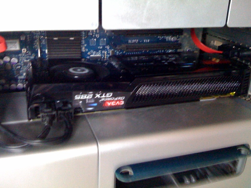

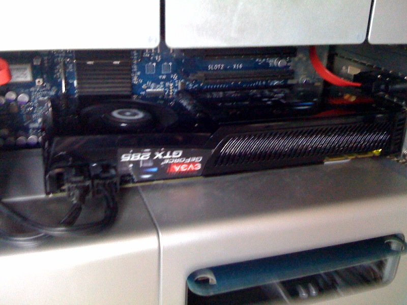

Houston We Have Liftoff !!! Gtx285 Victory !
TEECK2000 just left my place with his Mac Pro Early 2008..........and a shiny new GTX285 !!!!
The flash worked !!!

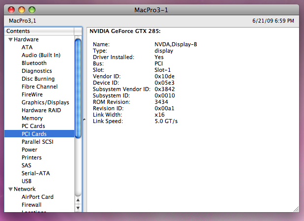

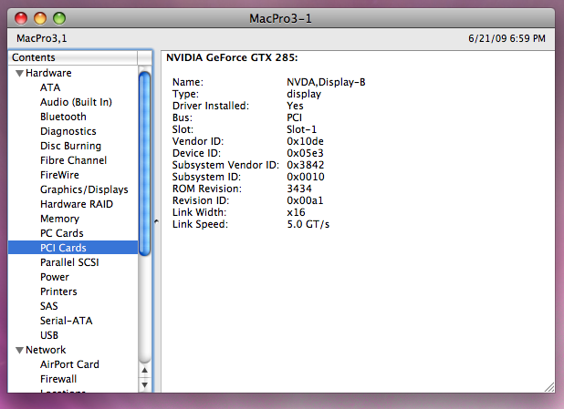

We tested multiple things, all A-OK. Even a 5.0 GTs link speed.

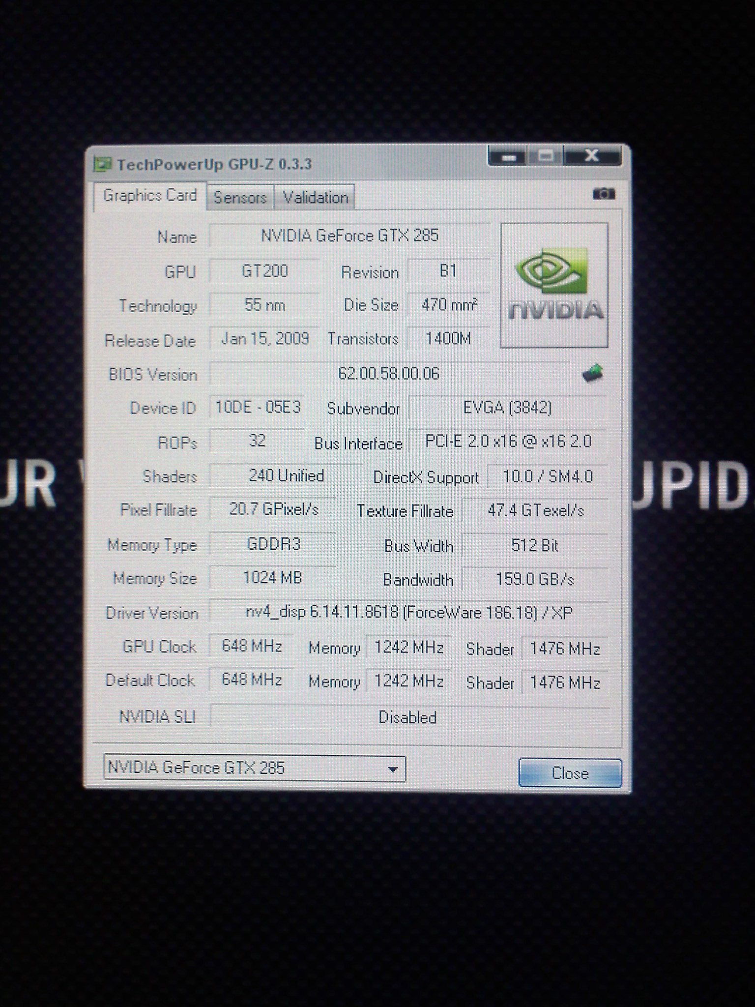

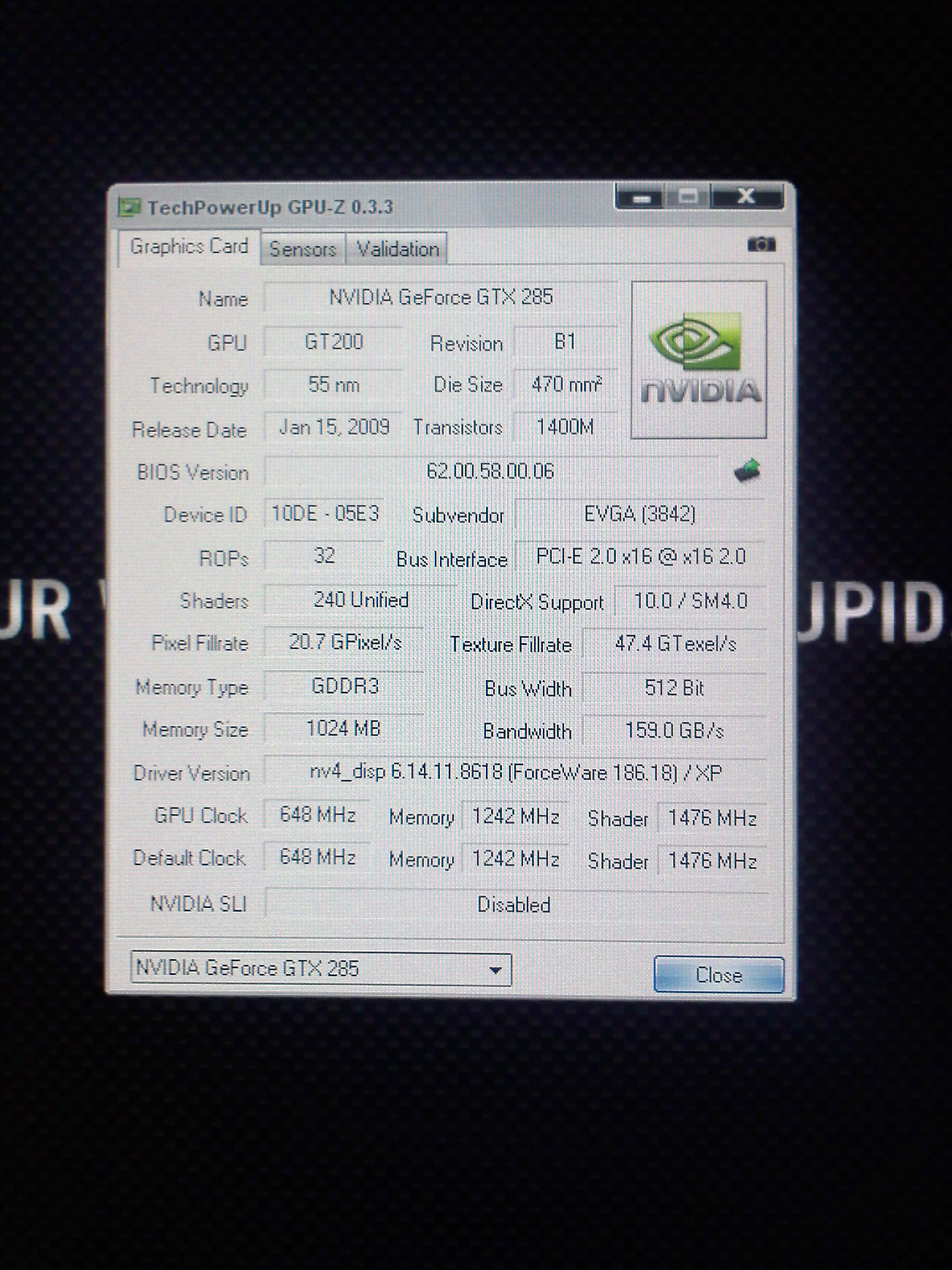

Windows was good too. He tried XPlane in both and said it was smoother than his 8800GT had been.
So a RESOUNDING SUCCESS.
Thanks to TEECK2000 for dragging his Mac over here. He decided to keep the GTX285 that I had already done the surgery to...I'll be ordering another one.

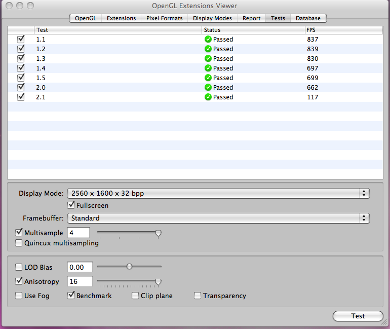

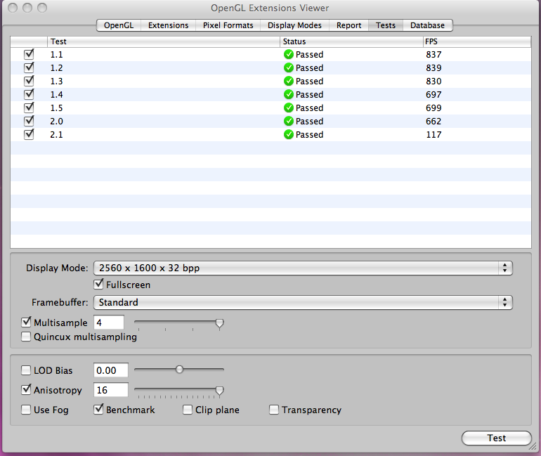

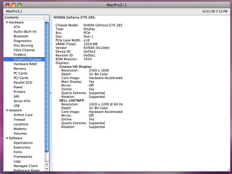

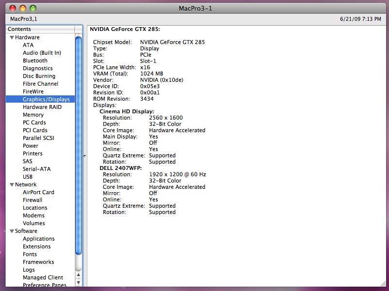

BTW.please note that I forgot to change OGL test to 1920x1200....and it scored beautifully anyway.
