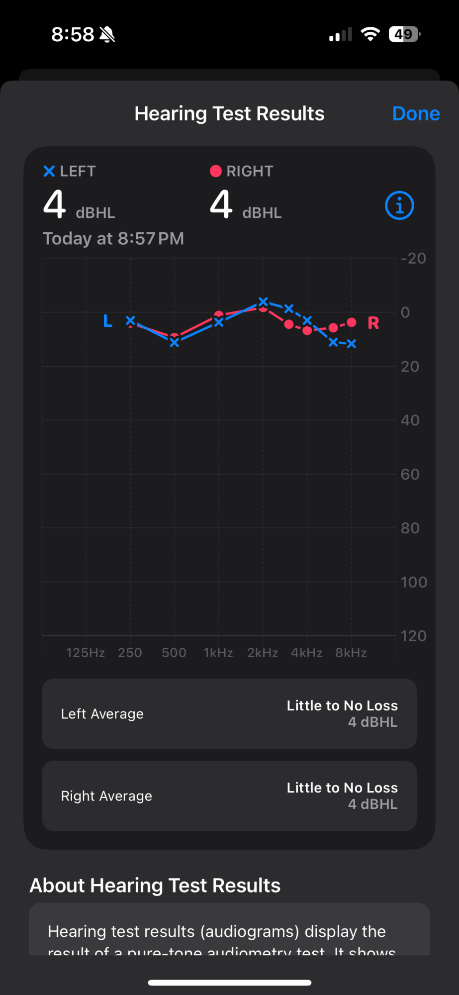

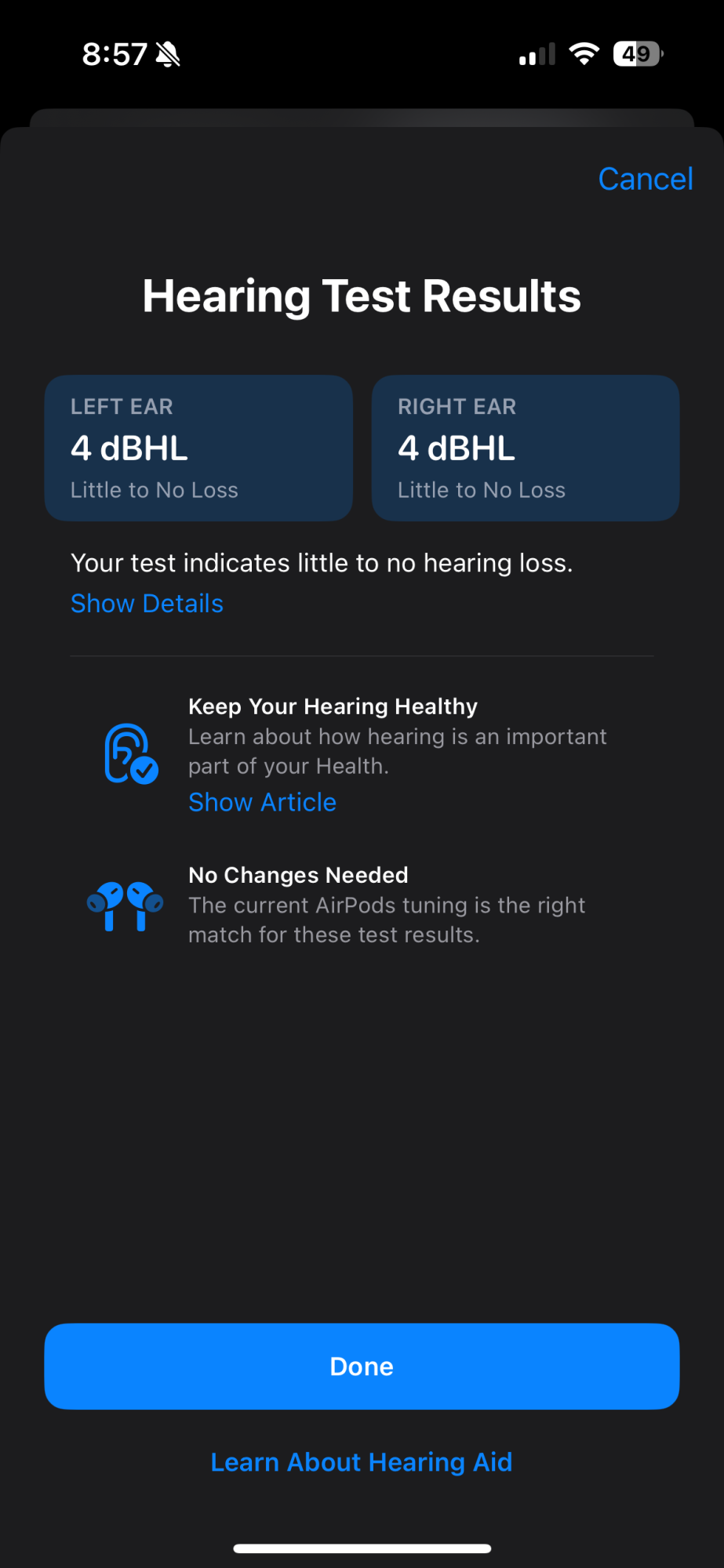

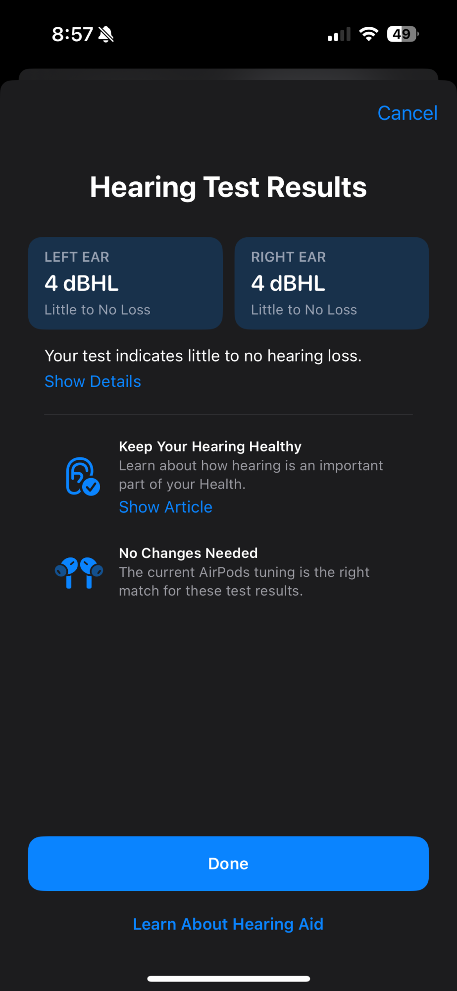

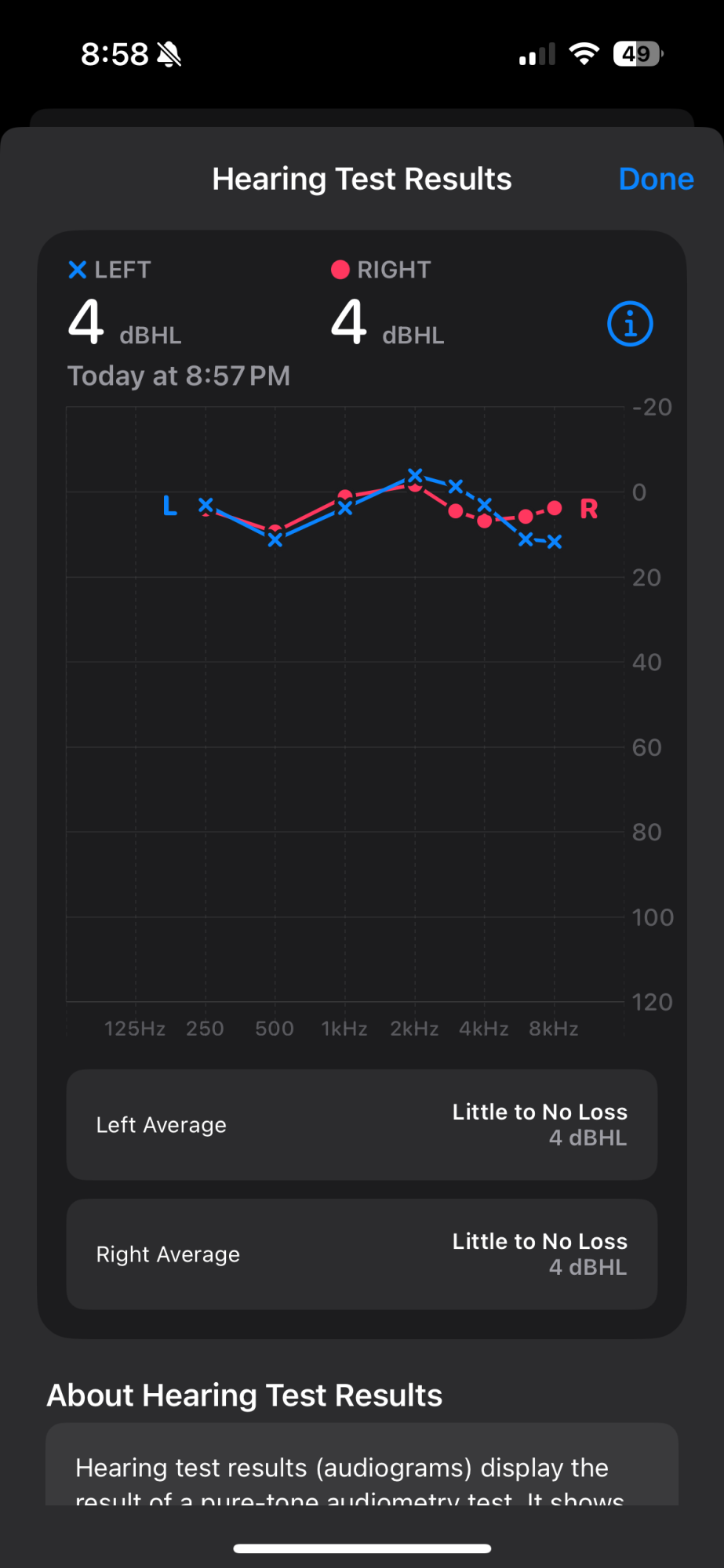

Gave it a shot myself. I always figured my hearing was good, but it’s nice to see it confirmed with technology!
