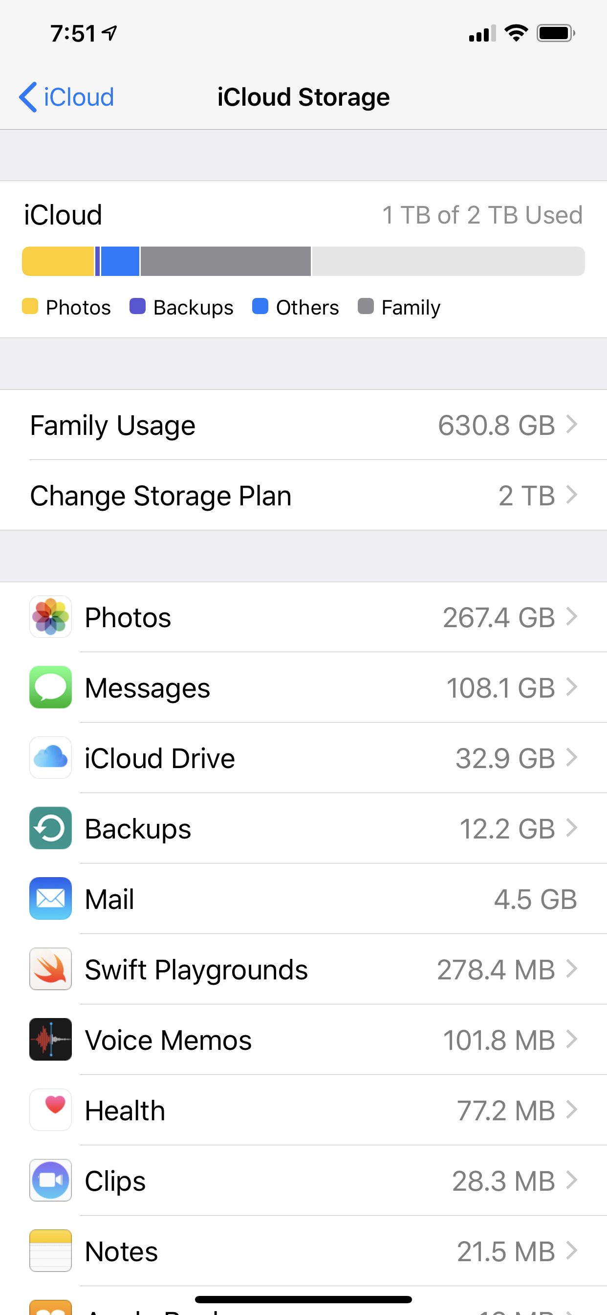

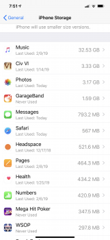

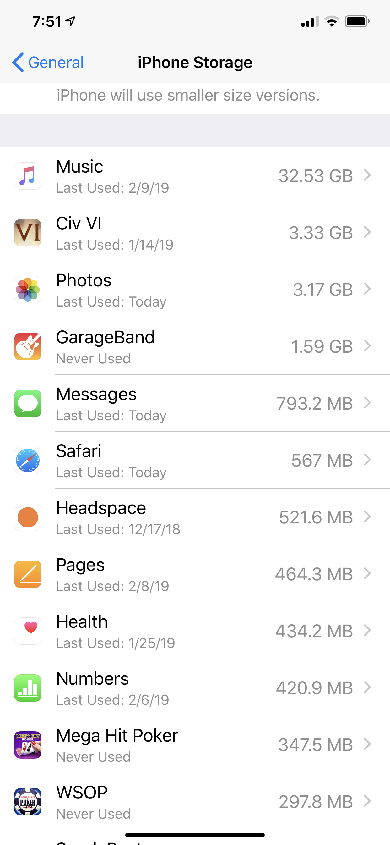

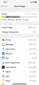

iCloud messages won’t download all your messages and attachments. It just loads it as needed... if you turn on iCloud messages on the device that has everything after 2017... it’ll combine the 2 databases... (I’ve done it).
And you can see the difference between my iCloud message database in the cloud and the space it takes up on my phone
View attachment 821389 View attachment 821390
