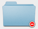

Yep, I can report the same fix worked for me. Interestingly, my icon for the folder had a little red circle with a dash on it (see attached image). That went away after I added my user name to the permissions. (Repairing permissions had not worked for me either.)
