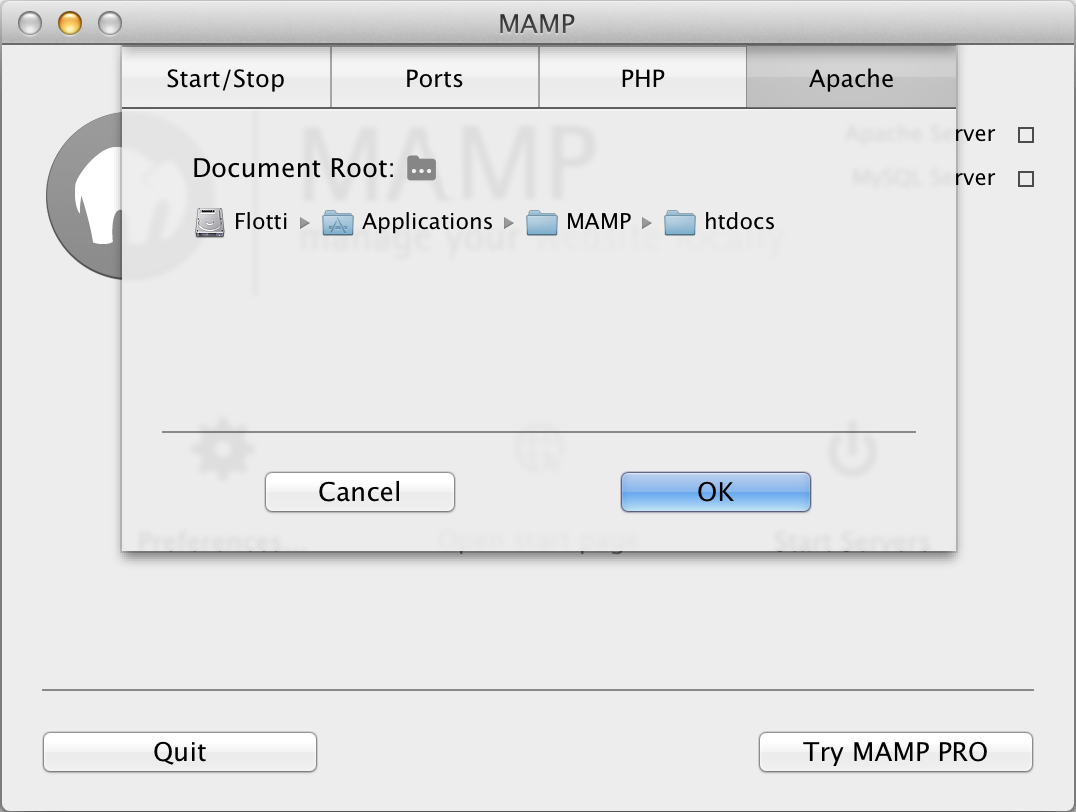

Okay, where do I put my .php files so I can browse through chrome? I looked through the MAMP folder and I don't see a root or www directory
When you run MAMP there’s a small UI that fires up (in addition to the AMP admin page you’re directed to). In that UI, go to Prefs, Apache, and that will define the document root:

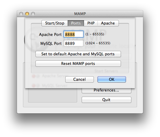

... and that same UI/config will show you the port the web server is running on, so in this example, it’s http://localhost:8888

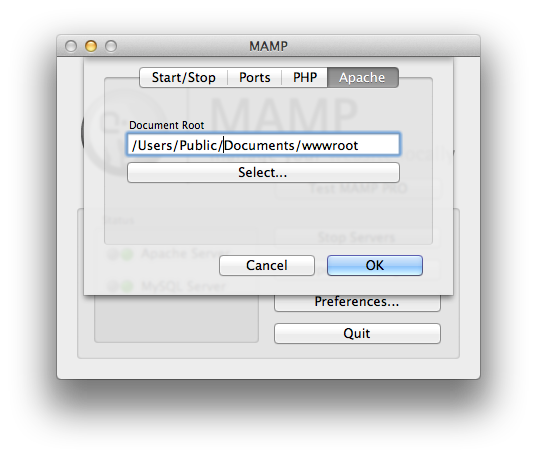

I have it set to default.. but for some reason I can't browse to the file through chrome.. can you help me construct the URL?
OK, so you’ve got your webroot, easy enough, and your port should be on that PORT tab in the screenie you posted. Since it’s local, if you haven’t done any custom hosts or anything, you can use localhost:<port>, or 127.0.0.1:<port> (where port = the value on your port tab, that I believe is 8888 as a default).
If you point a browser to that URL what do you get? Some browser message like a nonexistent URL, or a PHP error? If directly browsing is on, you should see the root of your web server and the files, or if you’ve got a default document (index.htm, index.php), you should see that file.

I got it.. silly me.. I was using the wrong ports. I did "localhost:<Apache port>" .
