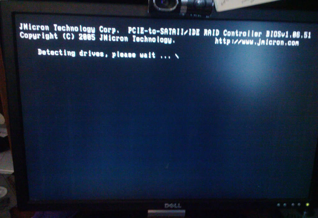

Can you post a picture of the box that pop's up during the 2min wait, it would be really helpful.
Here's the first thing I see when I boot into windows. Whether from my Boot camp partition or an install dvd.

Is that where your waiting 2 minutes? Because that has nothing to do with drivers or Windows, that's cards Option ROM running through drive detection. I bet if you disconnect the Blu-Ray SATA cable from the card, the 2min delay will drop down to a few seconds.
Like I said though Jmicron are not the best controller cards. It's most likely hanging up because its waiting for a Hard Drive to identify itself (because you only have a optical drive connected).
The reason you don't see this when booting OS X is because it uses EFI, and BIOS Option ROM's don't load on EFI (this is the same reason you need special video cards for Mac's).
There is a updated Option ROM (v1.07) for JMB363/366 based cards and that might fix the long delay. But you still haven't told me what card you have, it should be printed on the card or box somewhere.

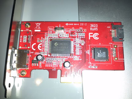

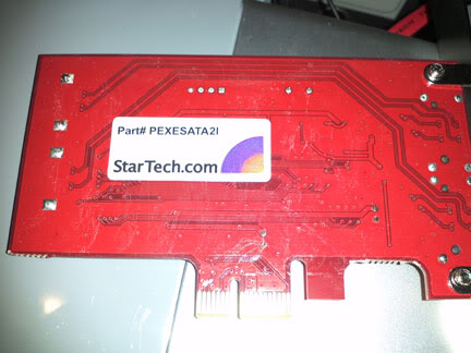

Yes this is where I it takes 2 minutes to time out. The silk screening on the card reads on one side 3623 RoHS. And on the other Startech.com Part #PEXESATA21. And this is the driver I have installed JMB36X_WinDrv_R1.17.62_WHQL.

Awesome, I can actually look up the card on Google now. 😛

Hi TheJazzy1, I can't seem to find a manual for the JMB366 (the chip on your card).

  1. On the black JMicron screen, the second it pops up, try pressing Ctrl+J. Hopefully this will give you a options menu.
  2. Update the Option ROM on the card.

The ctl J thing didn't work. I'm looking at Jmicron's site to find a new rom I can flash.
