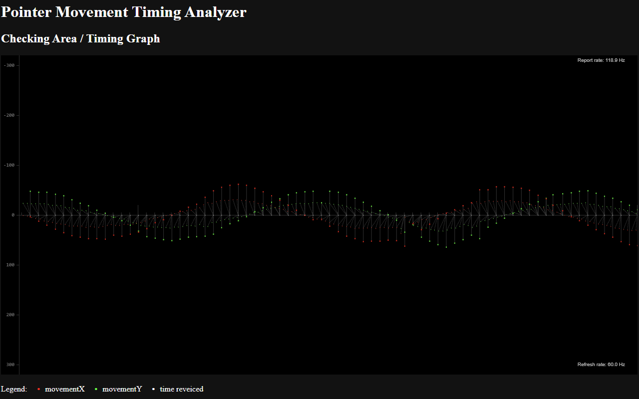

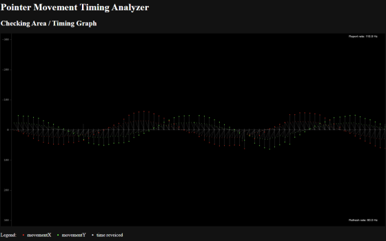

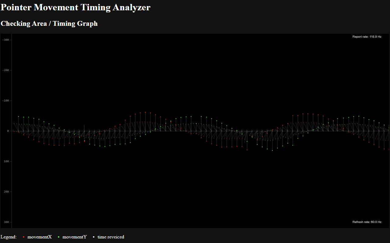

I made series of testing apps for pointing devices, if anyone had a MacBook Pro (M1 2021 or newer), please take a test and share the testing result with us:
In my experience, exquisitely designed touch sampling rate helps for better UX:
+ touch sampling rate SHOULD NOT be less than 60Hz thus to avoid flickering when scrolling/dragging/zooming/rotating
+ touch sampling rate SHOULD be integral multiple of screen refresh rate thus to ensure VSync coalescing evenness (those rates won't exert a negative impact to VRR frame pacing if high enough)
+ touch sampling rate is NOT RECOMMENDED to be more than 2x rate of screen response time, as that can just gain marginal benifit
