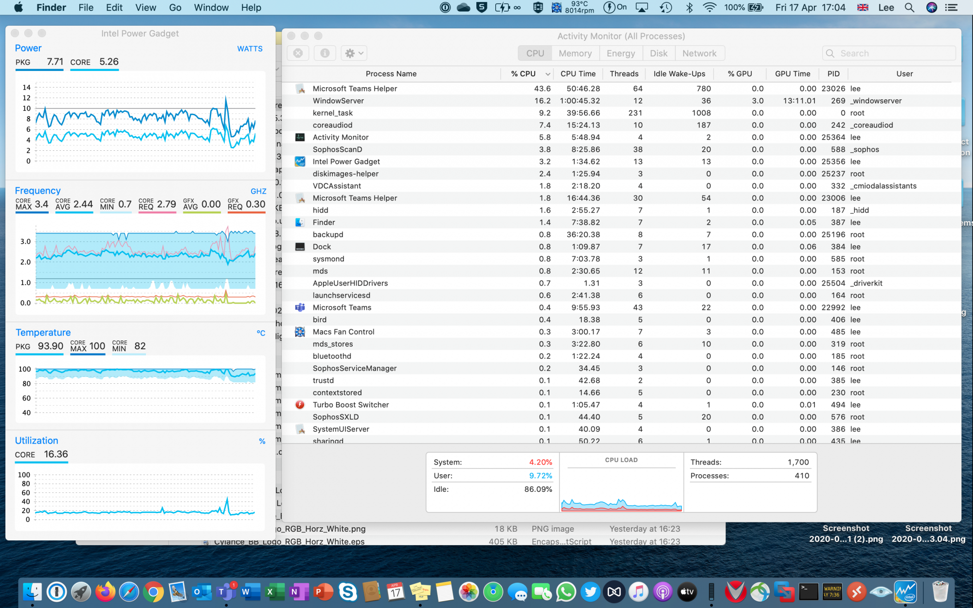

MBA 2020 i7/16GB/1TB, too hot too noisy and I sent mine back. Coming from the MBA 2018 i5 which is near silent all the time this was quite a disappointment. Am I a Pro user? I'm certainly not, asking too much of the device, I didn't think so, I used this in the same way as my 2018. I'm pleased to see there are more people without issues on this thread.
what were you doing when the laptop was getting too noisy and hot? I guess you are a pro user now.
I was just using MS teams during lockdown, I reverted back to my 2018 MBA. See the screen shot 30 mins into my call, the only app running, 16% CPU, temp 90deg+ and fan howling at 8000 RPM. Perhaps mine was faulty ... either way I don't get the same experience from the 2018 so I reverted back.
