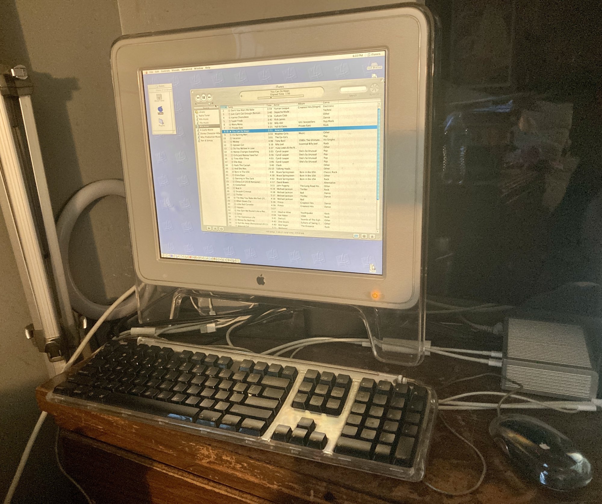

I'm now a member of the club! Yesterday at my workplace's satellite warehouse I picked up a 17" Apple Studio Display with ADC connection!
It's missing the back stand, but I'm sure I can find a replacement stand. Until then I've got it propped up against a few things when it's hooked up to my Mirror Drive Door G4 tower. ADC is pretty convenient, how I don't need to plug in an extra AC power cord.

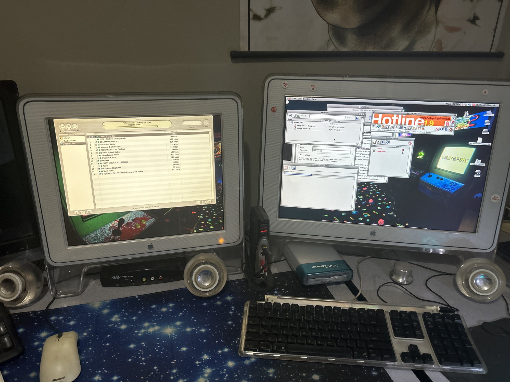

i picked up a 17" at my local value village back in december and i have it running alongside my 22" using an apple dvi to adc adapterView attachment 2359758
The “like” became ”love” the moment I saw the bondi-themed Imation Superdrive. I used to own one of those, and there are the rare times when I wonder why I didn’t keep it around.

More pics of my 17" Apple Studio Display in action:

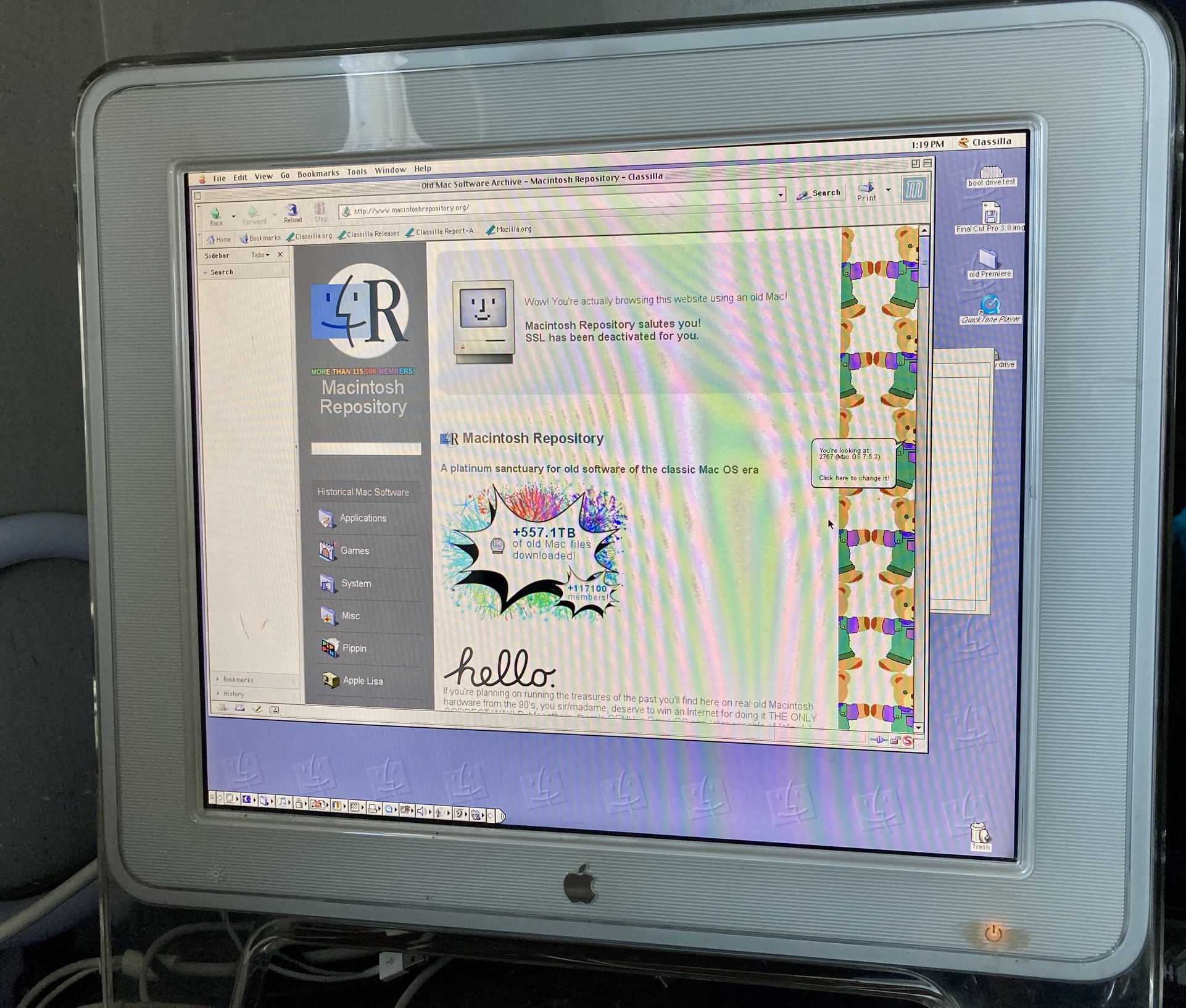

Browsing Macintosh Repository via Classilla! I love seeing that message of the site saluting me for running it on an old Mac.

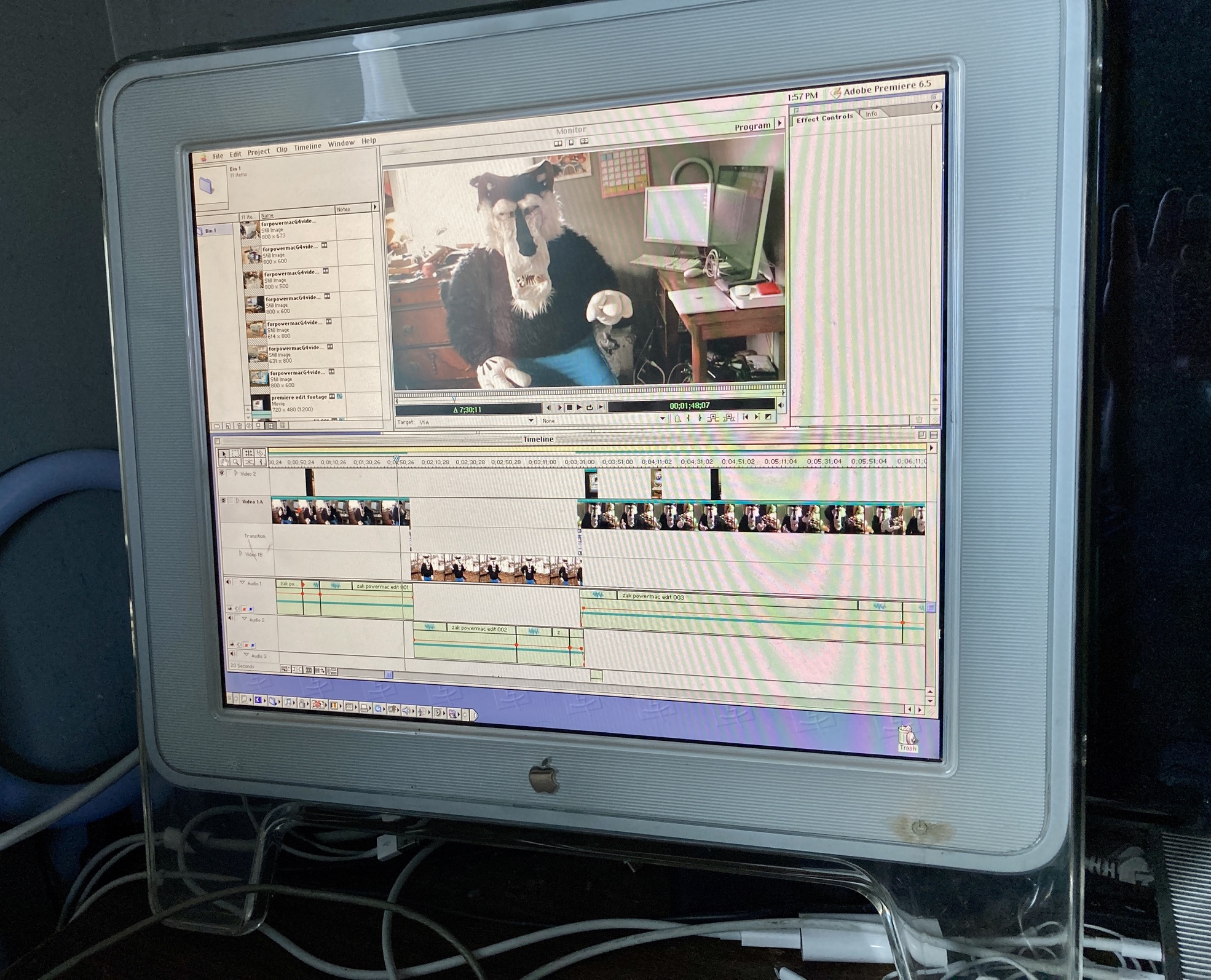

Adobe Premiere 6.5 on Mac OS 9. Like I said, this was the last version of Premiere to work on PowerPC Macs, and was a a decent less-expensive alternative to Final Cut Pro for multitrack Mac video editing, until Final Cut Express came out. (Though some things on pre-Pro versions of Premiere were harder to do, like panning and cropping and chromakey.)

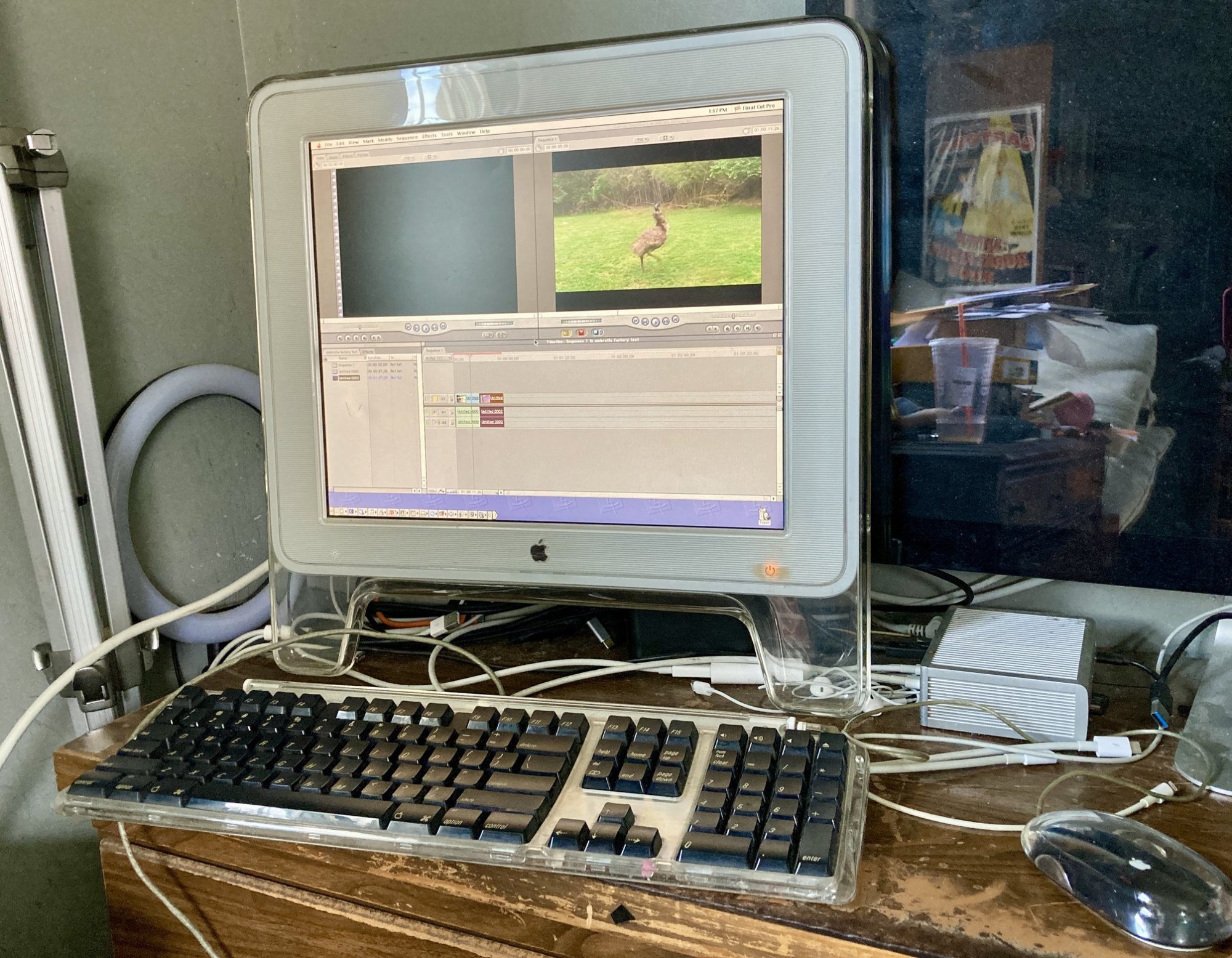

The older versions of Final Cut Pro that ran on Mac OS 9 were also considerably more complicated, but I can see why this was so popular with professional video editors in the early 2000s (this is FCP 3).

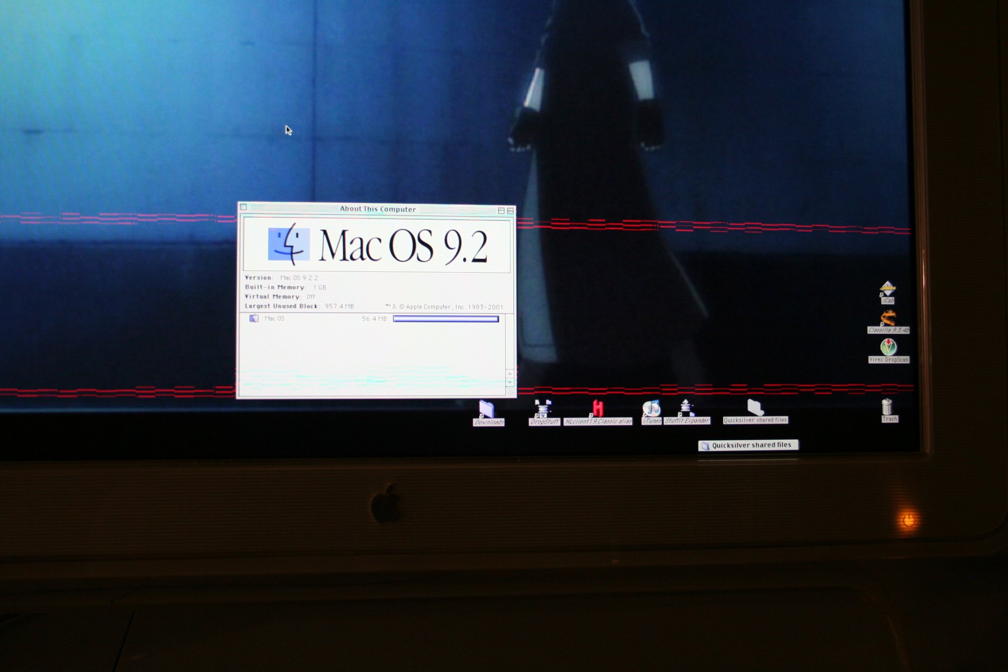

These are just a couple of my several PowerPC Macs. My Quicksilver has some minor glitch in the video card, but it's not bad enough for me to replace it yet. If there is anything in the lower half of the screen, it shows pink lines across the screen horizontally. I confirmed it's the video card because it does it to other monitors.
