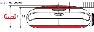

Due to Apple posting their specs for wrist band makers, we finally have the schematics, which tell the true story. The Apple Watch is actually 12.46mm thick in total. Making it almost 1mm thicker than the Moto 360, not 1mm thinner as many had supposed.
Apparently Apple is only counting the metal case. But leaving out the sensor pod and display bulges (marked in red above) is a bit disingenuous, especially since the other two dimensions follow normal watch rules.
The thickness of a watch is normally defined as "the width between the case back and the top of the crystal." In other words, the entire watch, not just the middle section as Apple used.

Here is an article posted Sept 10, 2014. Link
And in that article the writer lists the specs as:
42 mm Apple Watch dimensions
The body including sensor: 36.2 mm x 42 mm (12.46 mm thick)
The body without sensor: 36.2 mm x 42 mm (10.6 mm thick)
The sapphire part: 33.0 mm x 39.1 mm
The screen: 24.3 mm x 30.5 mm (about 39 mm / 1.54 inch diagonally), that makes the aspect ratio about 4:5.
So it obviously wasn't hidden.

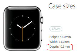

No, you are wrong.
It clearly says in the ad which YOU have a picture of that the DEPTH is 10.5.
It does NOT say the THICKNESS is 10.5 (which is what you said in your headline).
Words matter.

No, you are wrong.
Words matter.
Lolwut? Since words do in fact matter, please point us to somewhere, anywhere, that reliably defines the difference between the words "depth" and "thickness".
The depth of a shelf is the front of the shelf to the back (such as a wall). Maybe 8-12 inches depending on the shelf type. For instance, a waitress would know not to put a 12 inch plate on a shelf whose depth is only 6 inches.
The thickness of a shelf is the top of the shelf to the bottom, usually 1/2 to 3/4 inch thick for a wood type shelf. That same waitress would know not to stack too many plates on a shelf that is only 1/2 inch thick.
It's ok to admit you're wrong. Really.
