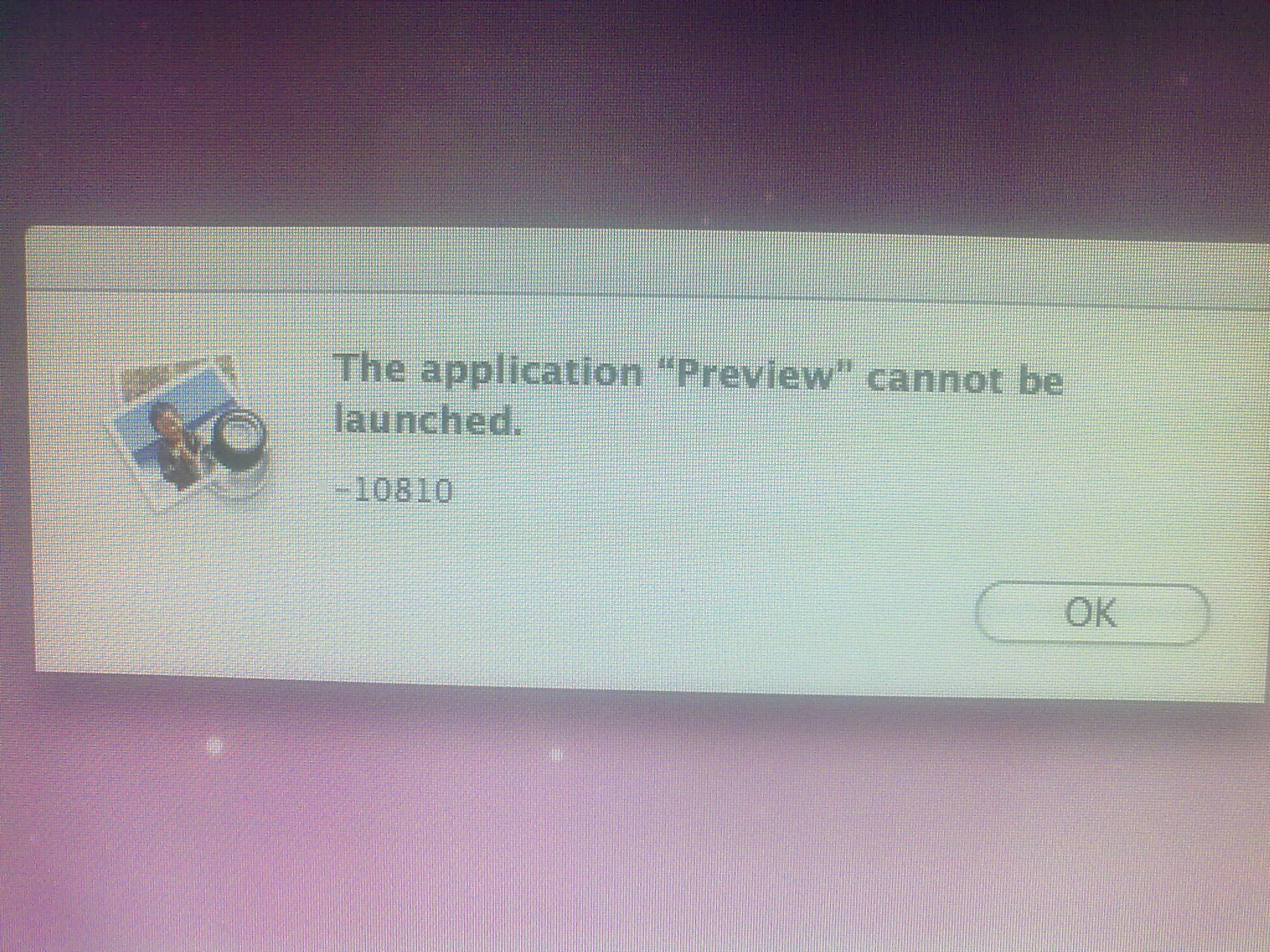

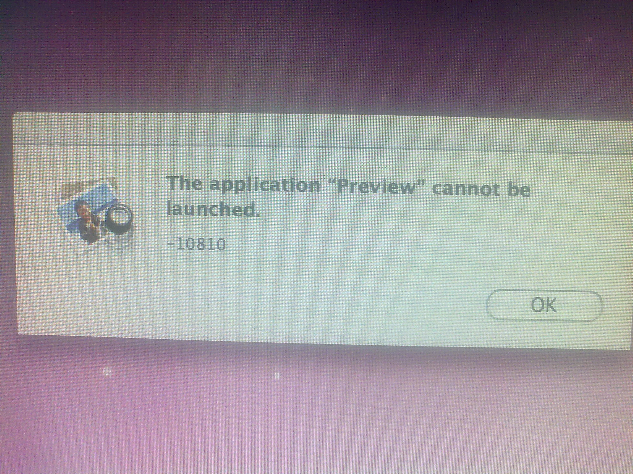

The application "" cannot be launched -10810
For some reason this message keeps appearing, and ever-time it does, i cant launch any application, cant use my keyboard shortcuts. The only way to get rid of it is to restart my computer
I tried finding something regarding this issue, but couldn't come up with anything.
Would really appreciate some help
Thanks
