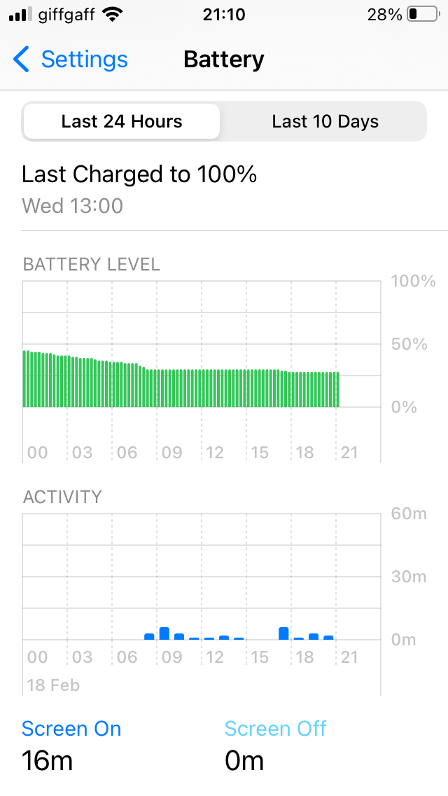

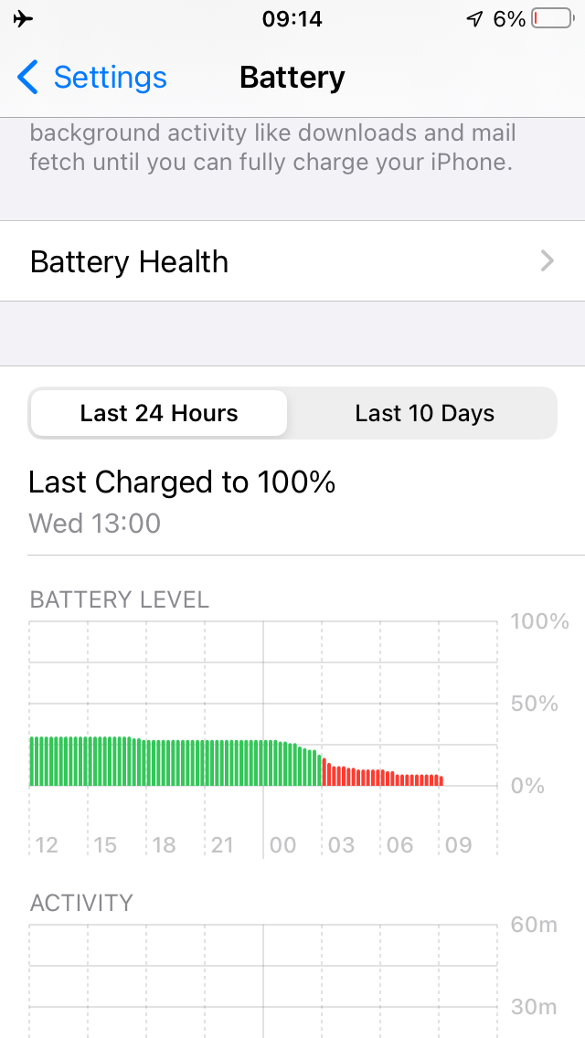

I don't use my phone much. It sits by my side barely touched for days on end. When using iOS 14, it used ~20% battery per day. After four days, at ~20% I'd recharge it. Life was easy.
iOS 15 stomped on that. iOS 15 uses ~33% per day. Here's the battery this morning. Charged at 13:00 on Wednesday, which by midday Thursday was at 66% with 33 minutes of use.
What is using that much energy? Who knows? Who is using it overnight? Who knows?

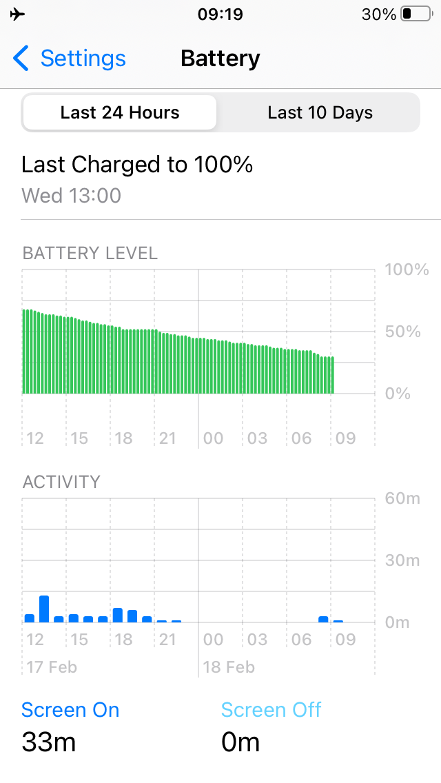

So, this morning, I switched on Airplane Mode. The result:
What is going on?
fwiw, I've already turned off Find My iPhone and System Customisation under Location Service/System Service because it was making so many location queries the indicator never turned off, and as a result draining the battery even faster.
Any ideas? And nope, I'm not holding it wrong.
Edit: In all cases, Bluetooth is off.
Edit 2: Battery health is 93%
Update: This is what happened overnight: 28%->6%. Phone left in Airplane mode:

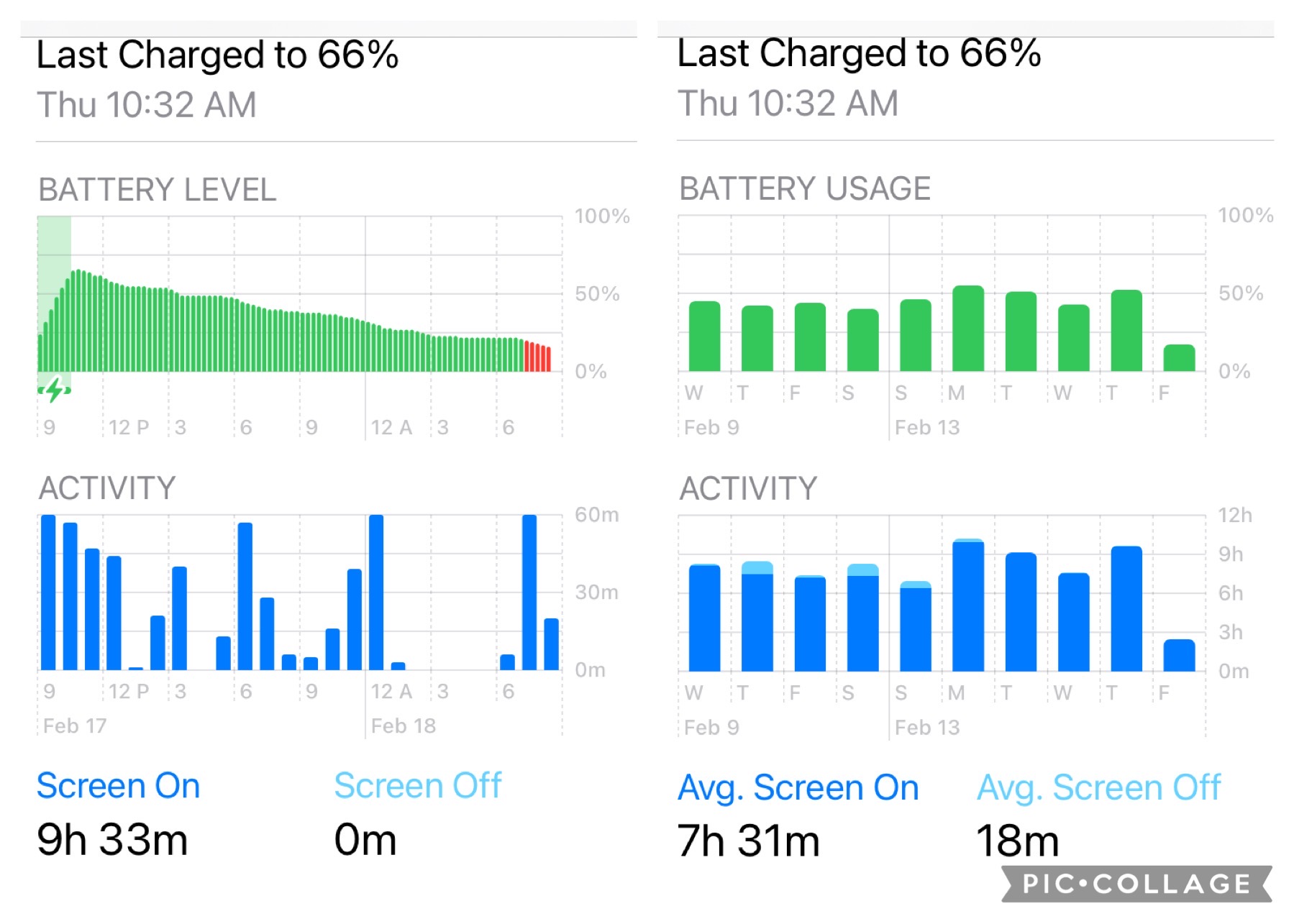

I updated from 14.8.1 to 15.3.1 last Sunday (I try to wait til version .3 or .4 of major IOS updates, based on all the horror stories). Got lucky - seems to have no impact on my batt life.

I added an additional data point showing overnight behaviour.
Additional point from observation: this behaviour seems not to affect those who make a great deal more use of their phones.
Anyway, my question is about how one might diagnose this rather than counter-examples, which are lovely but don't help with the issue itself.

I'm not using any apps. As I said, the phone is just sitting by my side (almost) unused. fyi: the top apps are Home & Lock Screen, and Settings (because all I'm doing is going in to Battery to take the snapshots).

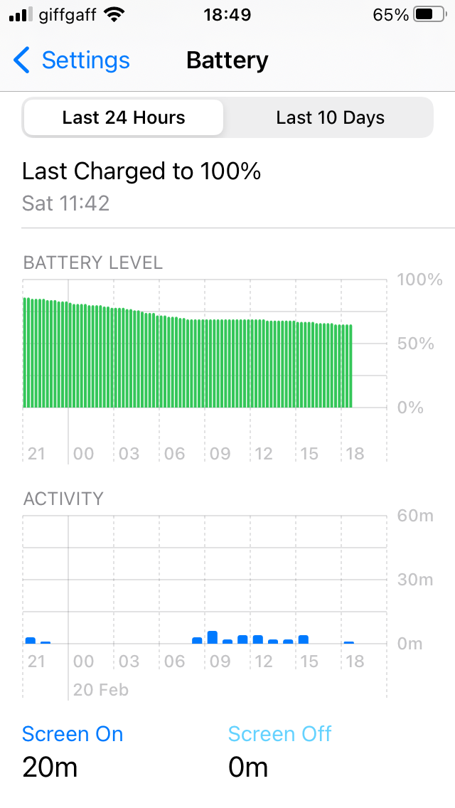

To reiterate: when using iOS 14, the phone used ~20% battery per day. The update to iOS 15.3 (and subsequently 15.3.1) increased that to ~33% per day. No change in behaviour. No change in apps. Same phone, same setup.
The question I asked is: what is the cause?

I don’t have the standby drain problem when I’m on Wi-Fi…. But when I’m on cellular 4g/5g, it is maybe twice as much battery usage overall. My theory is the 5g chip in the 13 isn’t as battery friendly as they say it is…. So I’m wondering if the OP has their battery drain on standby on cell service and not Wi-Fi?
I have Mobile Data and Wireless switched on – as I always have. But clearly the phone is using wireless, since it's only a few metres from the router. I'm on 4G.
I will switch off Mobile Data today to see if this has any effect. However, as shown above, when in Airplane mode very little power was used until, suddenly, it virtually drained the battery overnight, while still in Airplane mode.

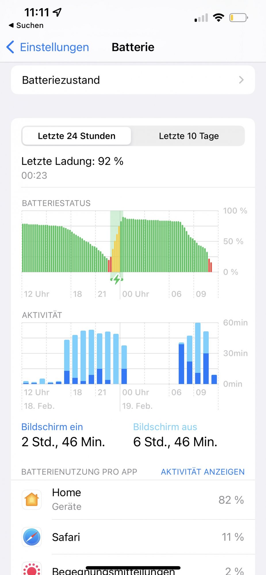

Same problem here.
I detected, that home app is usk g 82% of my battery and causing a high load.
There seems to be an issue with thread implementation, hammering the AppleTV with thread dns requests..
Or on reddit
https://www.reddit.com/r/HomePod/comments/rrepay
Seems that there is a major issue, happening on some setups only… maybe caused by a bug together with UniFi hardware? Not sure.
Startet with iOS 15… 14.x did well.

Draining with airplane mode “shouldn’t” happen :(
I read on a thread somewhere that I had a lot of logs on my phone that build up, and after connecting to iTunes it dumps them. Also the backup to iTunes: then restore from that backup: seems to reset my phone’s bad behavior.
re: Airplane mode: Yes, I was surprised. I posted the result above to show it. As I say: what is going on?

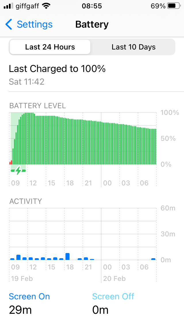

So, the result of this is interesting:
69%-65% from 08:00 to 19:00 by switching off Mobile Data (no other changes). This is similar to the result of switching on Airplane Mode (see above), so I'll leave it overnight to see whether the massive drain while I'm sleeping occurs again.
