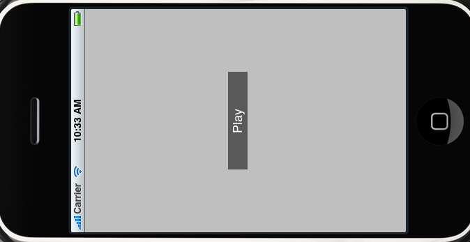

EDIT: I've done this:
Code:
[self shouldAutorotateToInterfaceOrientation:(YES)];
Nothing rotates, it looks correct if the device has the home button at the bottom, but if I turn it to the left it looks wrong, no rotating.
EDIT: Image attached.
That's not it.
In your view controller add this code:
Code:
- (BOOL)shouldAutorotateToInterfaceOrientation:(UIInterfaceOrientation)interfaceOrientation {
	// Return YES for supported orientations
	return YES;
You do have a view controller don't you?
Subclasses of UIViewController must or may implement various methods that are called by the system. This particular one reports to the system what orientations the view controller supports.
Normally when you create a project from a template it creates a view controller and it has this method in it. The stock version of this method works only in portrait orientation. Like this:
Code:
	return (interfaceOrientation == UIInterfaceOrientationPortrait);
You should be able to make that work with landscape instead.
FWIW, apps that only work in landscape are a bit of a pain to set up. Is that your goal?
