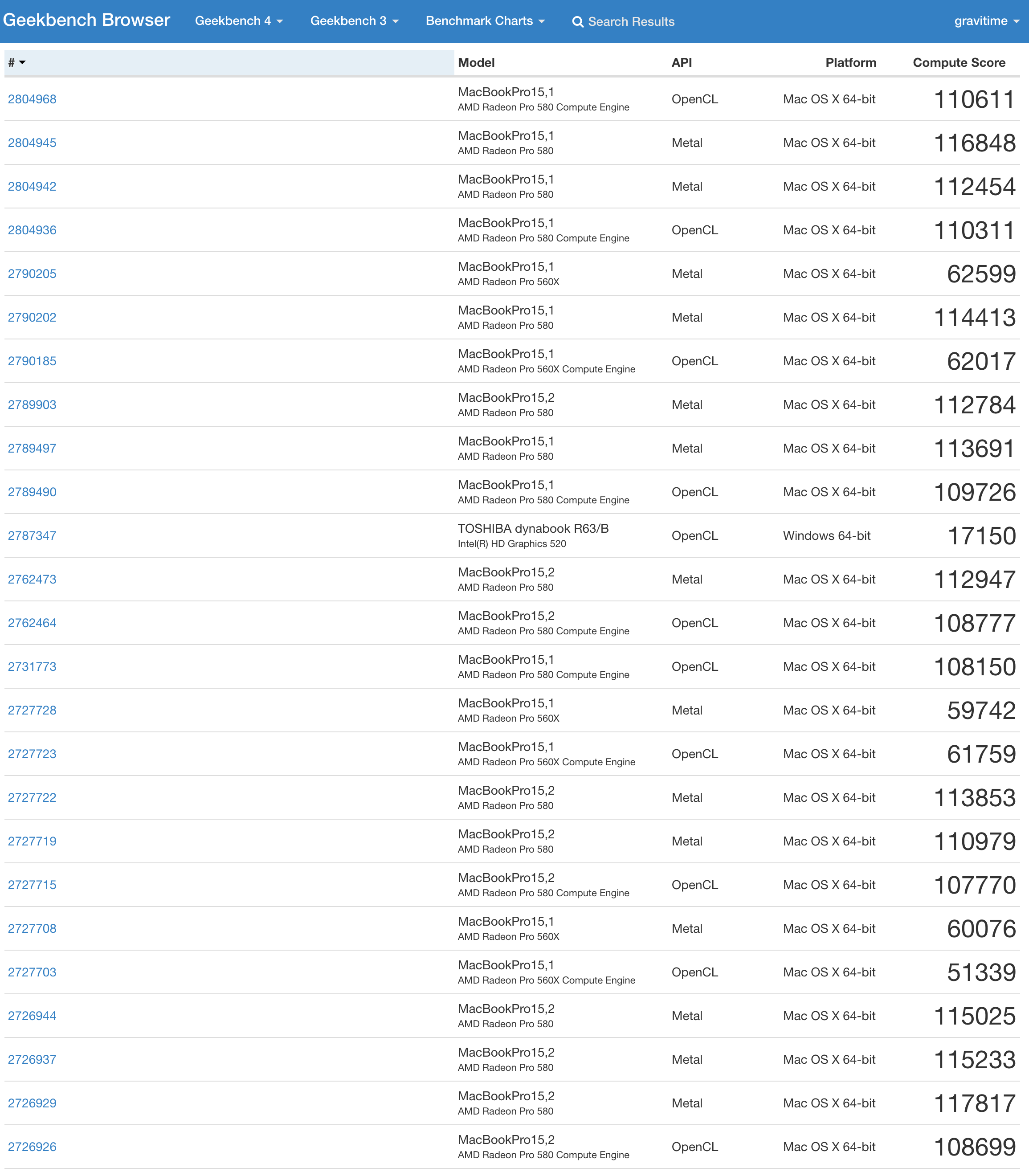

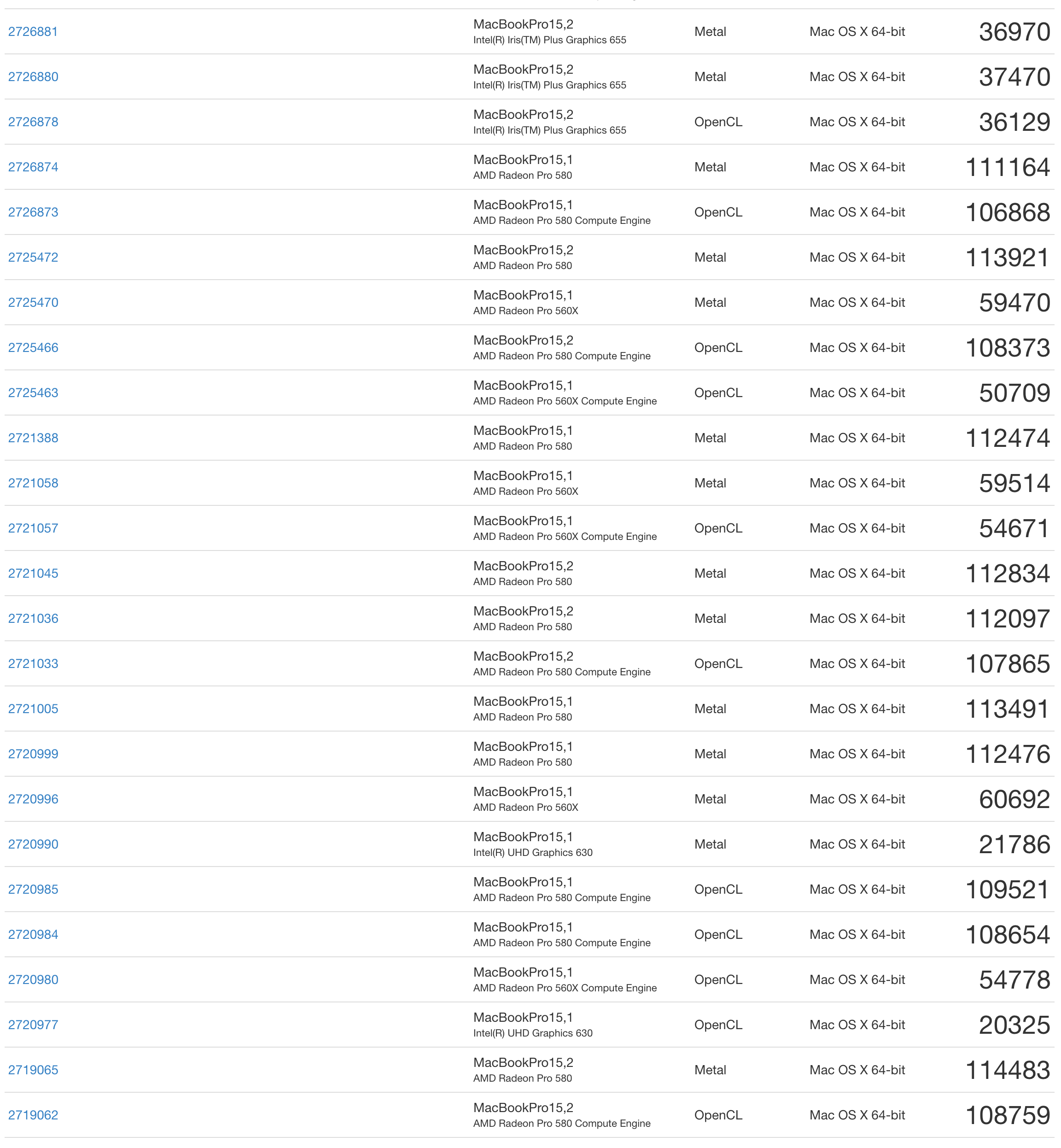

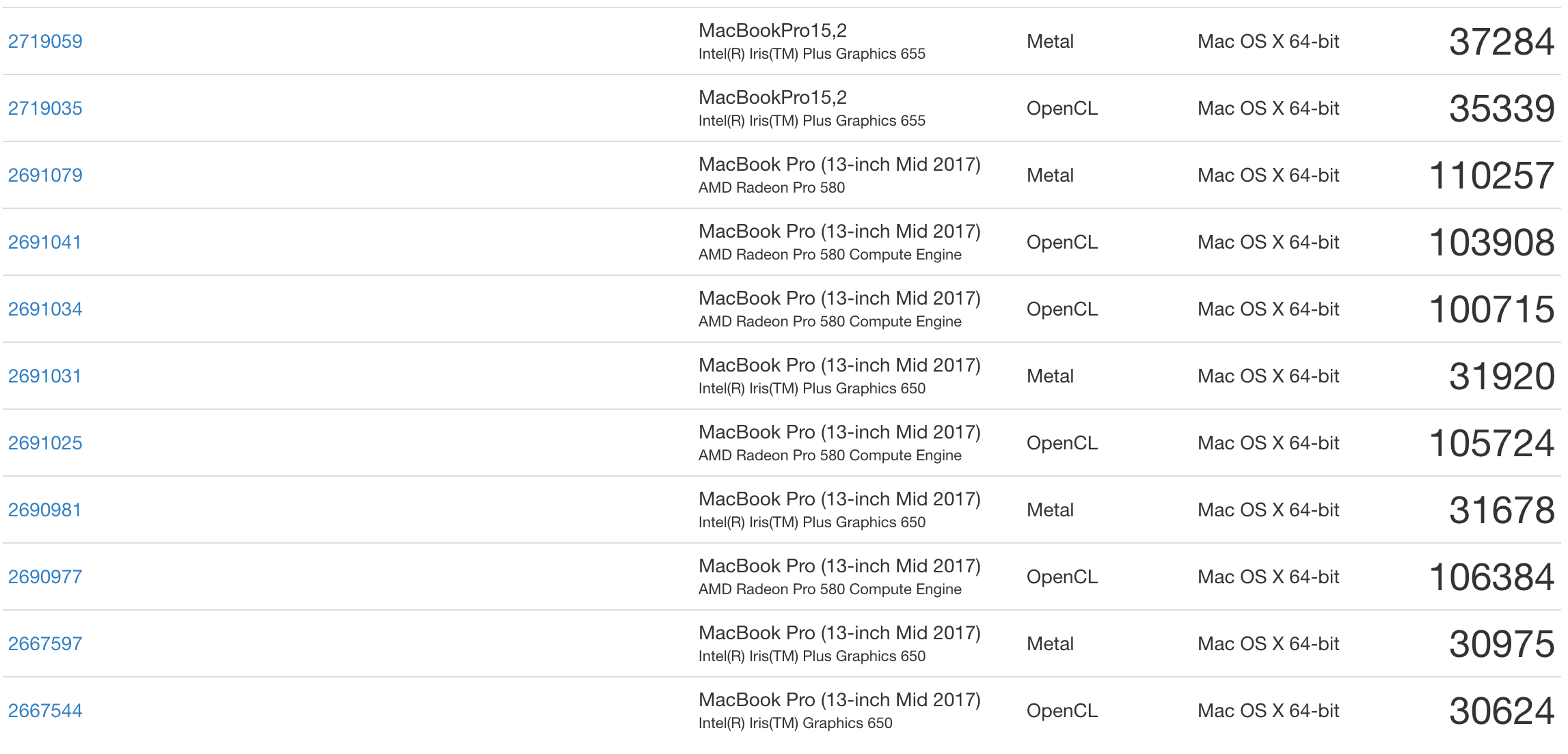

If you care about benchmark scores about eGPU (tested with my old mac and other three new macs), I've run Geekbench 4 many times and here are the scores:

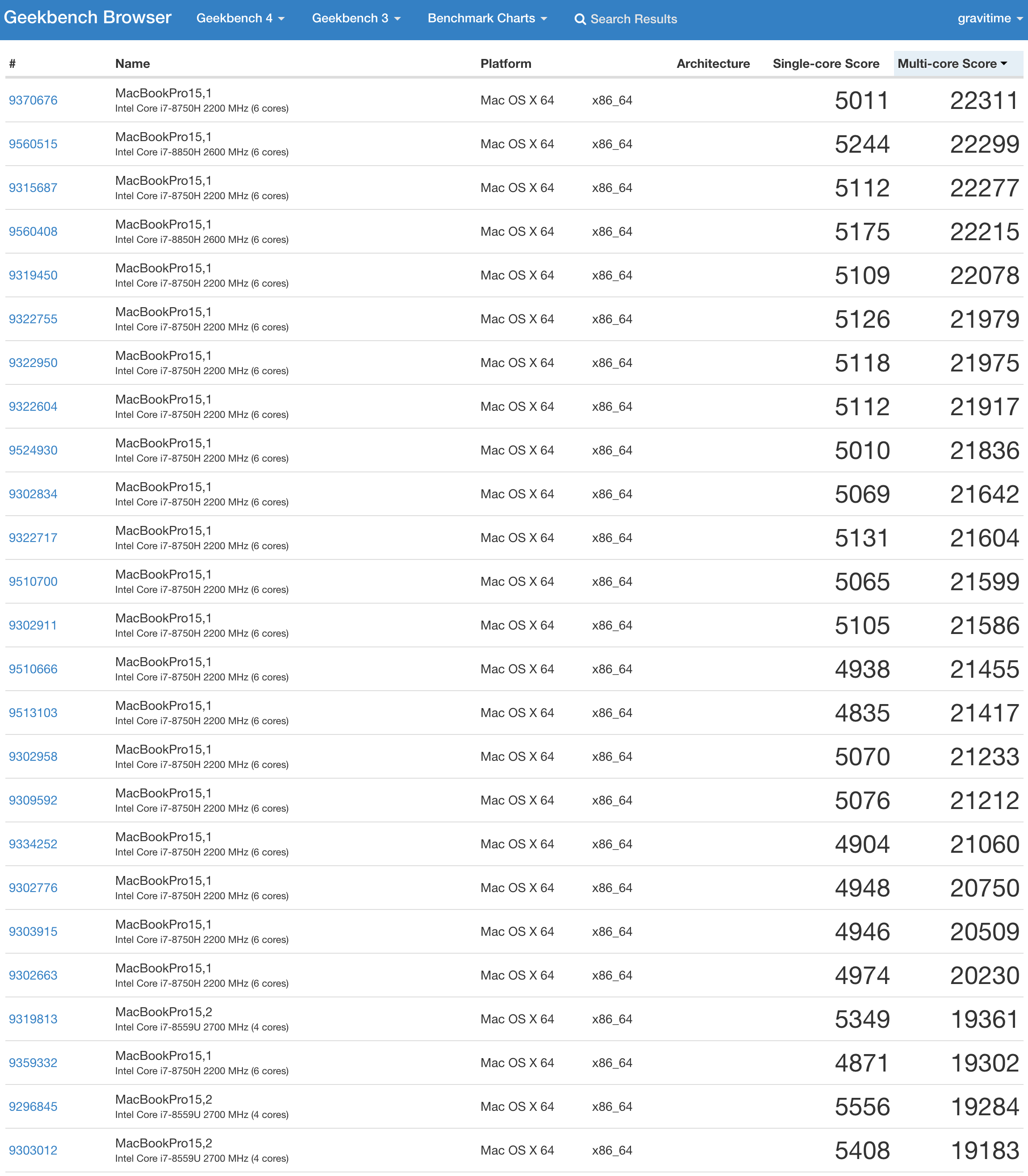

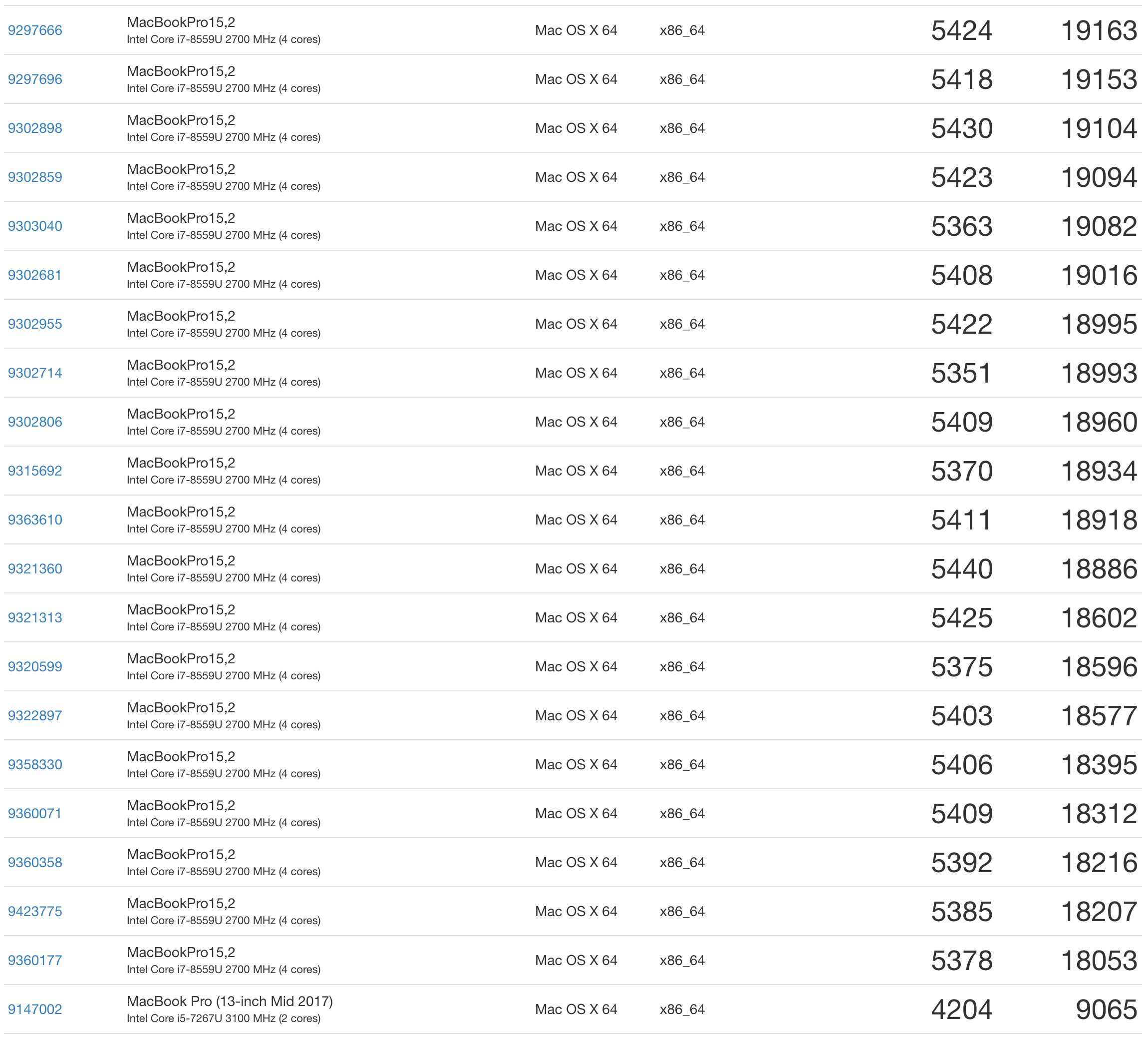

If you care about cpu performance about new 13' and 15' I've got, here are some Geekbench4 results (I know there are already tons of test results, but more info is always better I suppose):

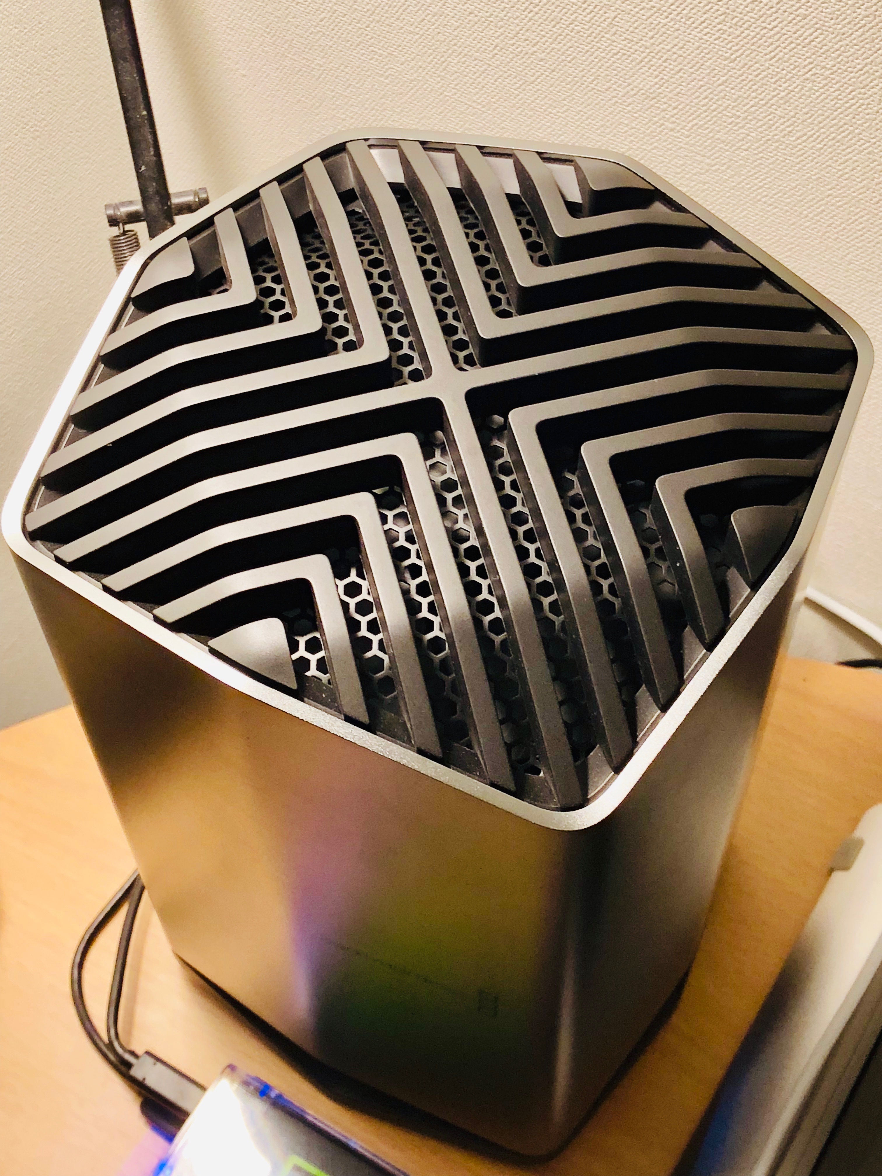

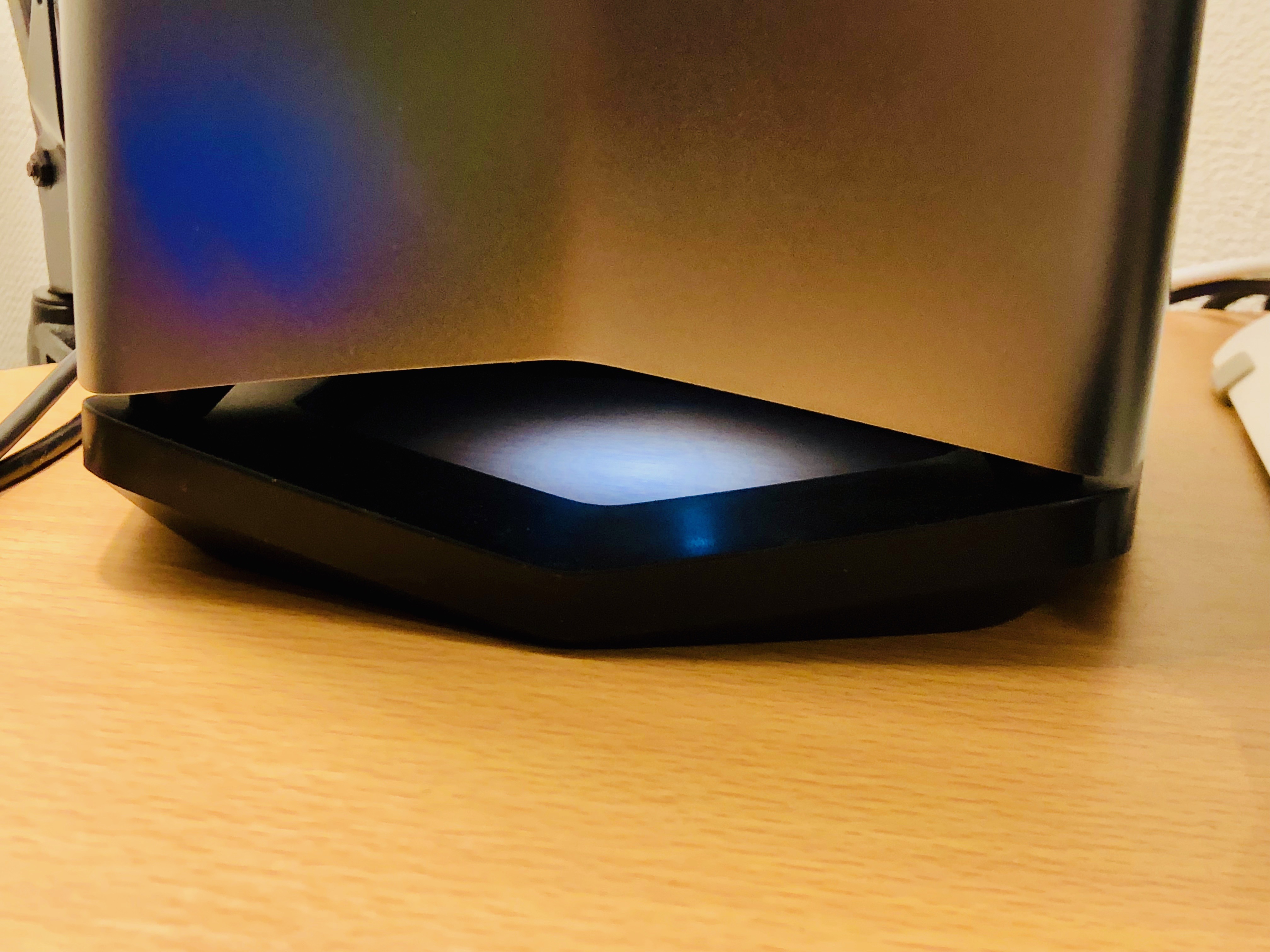

There is no power button on eGPU, you can only tell if it is ON by looking at the indicator light at the bottom. However, I have found that the Blackmagic eGPU actually has three power mode:
Powered off: the status when power cord is not connected to the eGPU;
Standby: when power cord is plugged in, but not connected to any mac ;
Powered on: working as it should be.
I believe it has a standby mode because even when eGPU is disconnected from Mac, the external HDDs are still running (indicators on HDD's case is on) and you can feel a very gentle wind blowing out form the top of eGPU's enclosure.

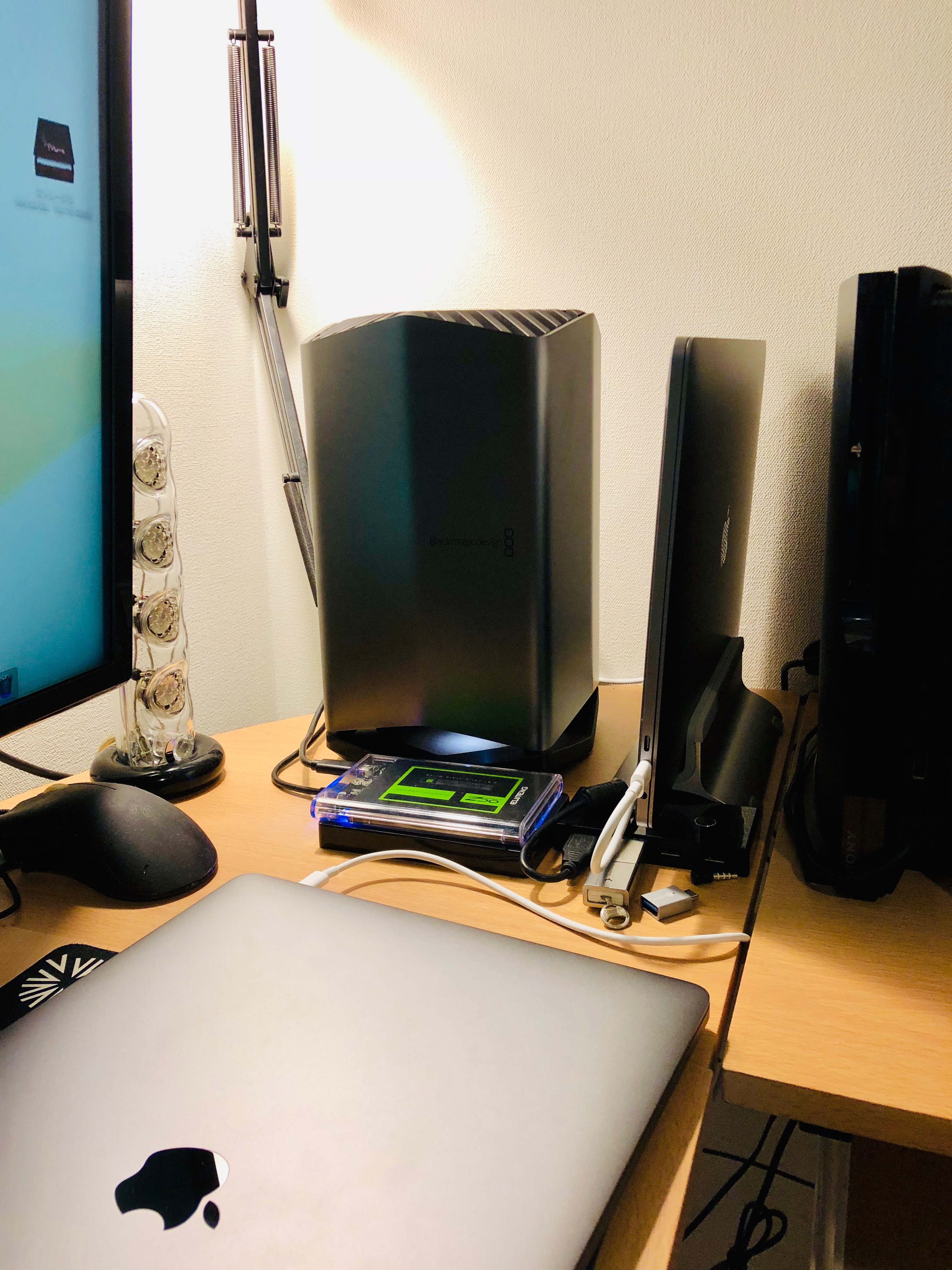

Reason one, A very good docking station:
Had to mention this feature first. I know no one purchases a eGPU just for its expansion ability. But after few days of actual using, I feel that it is a very handy 'nice to have' feature. With Blackmagic eGPU, I can use single thunderbolt 3 cable to do everything. From charging my mac, to hooking up everything I needed, without any unnecessary wires.

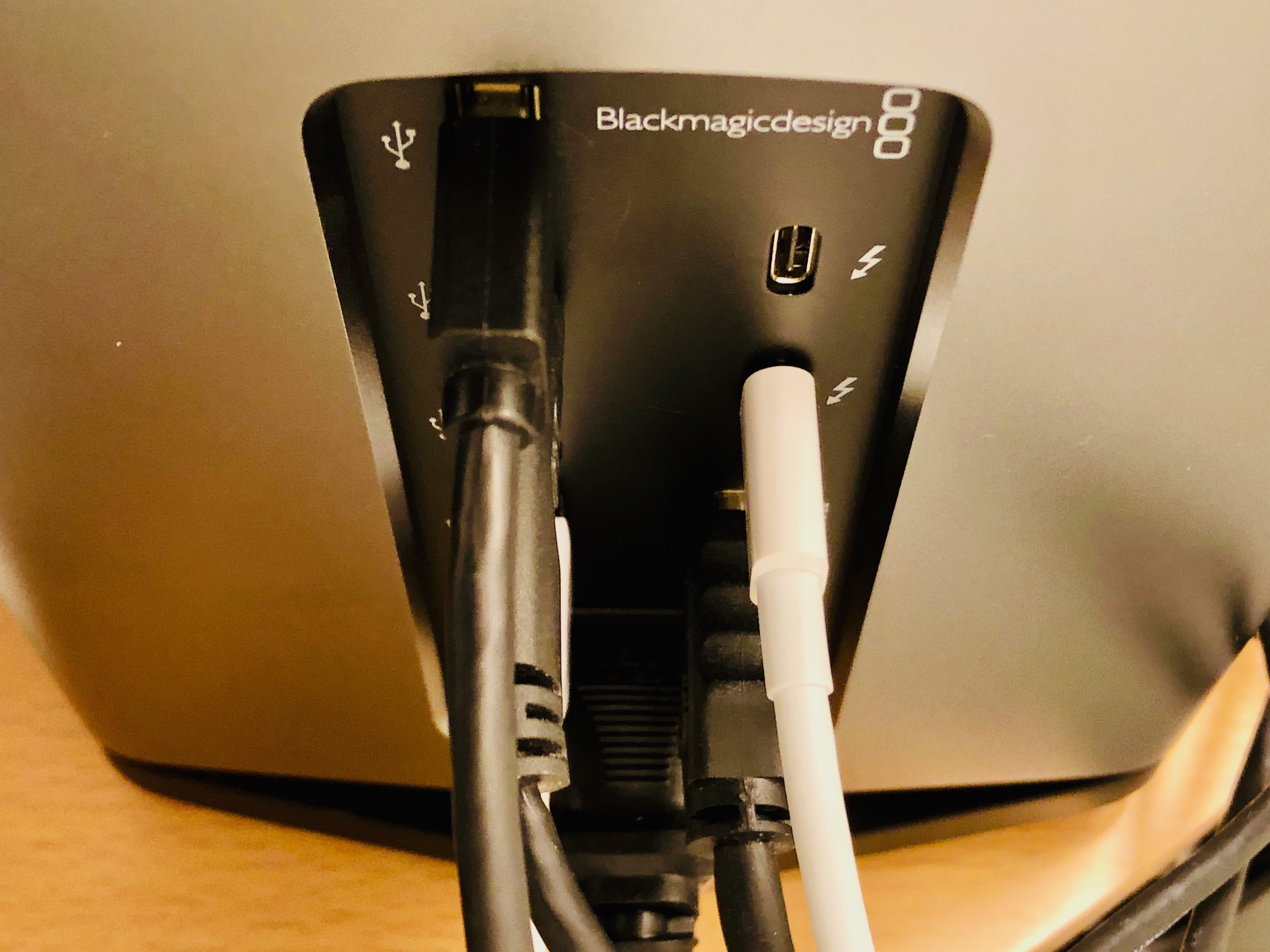

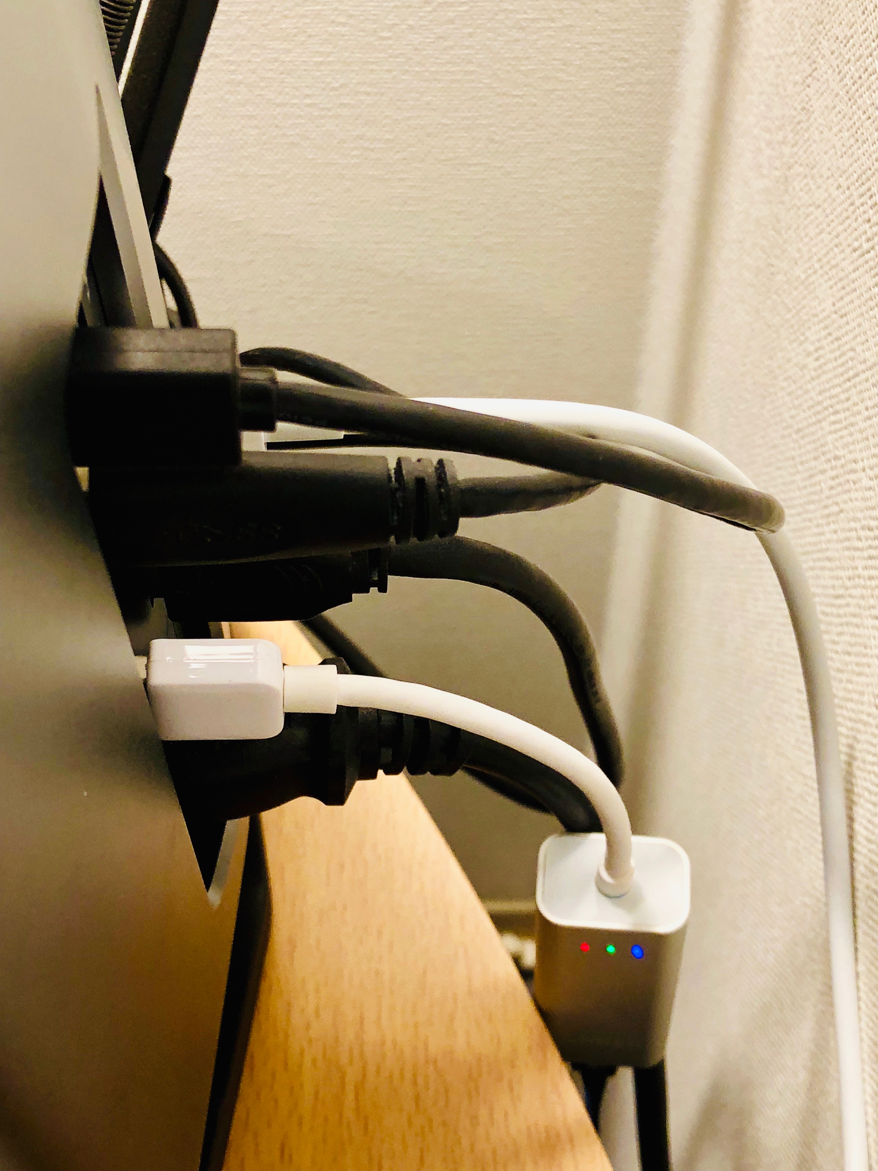

I use a 1Gbps ethernet-USB cable plugged into eGPU and my Time Capsule. Now I can get a very stable 20mb/s internet download/upload speed, along with the Time Machine disk reading speed now up to a stable 60mb/s. The Time Machine backup now is much faster than before (about 3X faster). Before eGPU, I have to plug this dongle to another thunderbolt port.
I connected all of my hard disk to eGPU, now when I connect the eGPU to my Mac, everything shows up immediately. I have two USB-A 3.1 HDD and a thunderbolt 3 SSD. The SSD can reach 550mb/s read speed though thunderbolt 3 port. I installed a backup macOS on the SSD so if anything goes wrong, I can immediately boot up from there then get my work done, then do a system recovery.
The SSD takes up the thunderbolt port. But since I don't have a LG 5K display so that's fine. My LG 4k monitor (actually it's a WebOS TV) hooked up via HDMI on the eGPU and can up tp 4k 60Hz. If you use LG 5K display you can connect your fast SSD to the display so that won't be a problem either.
(BTW when I connect my mac to the TV through a HDMI-thunderbolt converter the TV can't tell what kind of device it is, but when connecting to eGPU it can tell it's a PC.)
Now I have one USB port left. I connected my Apple wireless keyboard through a USB-Lightning cable. So I can charge my Keyboard while using it.
Some might think this is a very expensive eGPU, and the worst is the graphic card can not be swapped. But think of it this way: Most of the 3rd party gpus doesn't have so many extension ports. Even if they have, they are very limited in many ways.
With Blackmagic eGPU, you get four high quality full-speed usb3.1 gen1 ports (up to 10Gb/s I think) and one thunderbolt 3 port (up to 40Gb/s according to Blackmagic Design's website). With one cable you can charge your mac, connect to ethernet (with a dongle, but the good thing is it's hidden behind the eGPU), connect to your external HDDs.
So you can put the power brick into your bag incase you need to use it outdoors (you don't have to buy one). You can save some money for a USB hub (a good quality dock with 4 USB-3.1 and a thunderbolt 3 is not cheap).
And let me say it one more time: One cable for everything is so elegant! Considering all of these hassle you can save, along with saving you least 120$ for unnecessary accessories, it's not that unacceptable.
