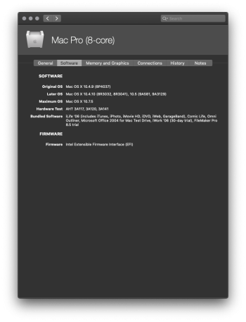

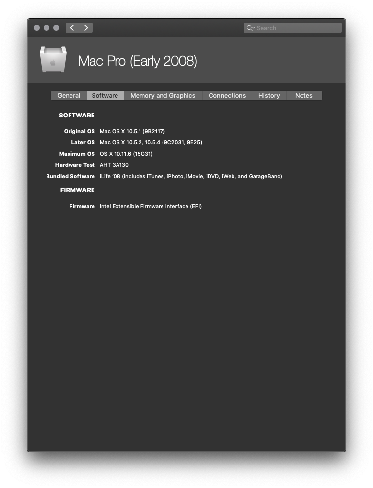

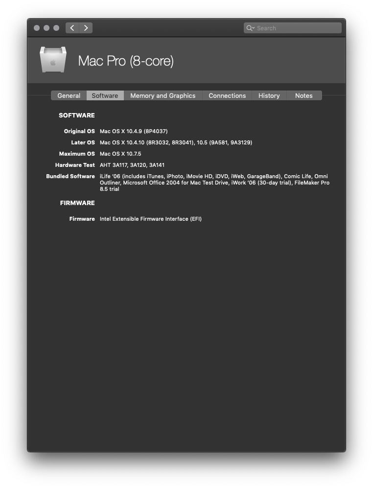

Actually, the fastest leopard machine would be the mac pro 3,1
and the fastest tiger machine would be the mac pro 2,1

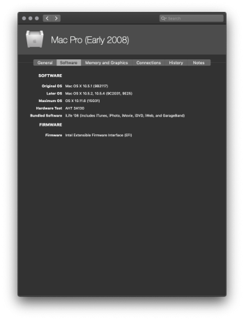

Screen Shot 2023-02-15 at 7.43.41 PM.pngScreen Shot 2023-02-15 at 7.43.30 PM.png
Sorry what? I already started a thread called “Most Powerful Leopard System” and it was concluded that a max’d out 4,1 would be the official winner, though the 5,1 unofficially boots Leopard no problem.
I’ve also read here that Leopard doesn’t generally check hardware and will attempt to boot and the only thing preventing it from doing so would be unsupported hardware such as the Nvidia 320m. For instance, I will be checking if I have an Nvidia 9400m in my white unibody MacBook and if so will attempt to boot 10.5. Officially, this system was released with Snow Leopard as a minimum but it seems to have complete similarity to a Leopard-era Mac.
I’m running Leopard on my 2.26GHz 8-core 4,1 Pro and I’d be surprised if the earlier Pro’s come close in performance.

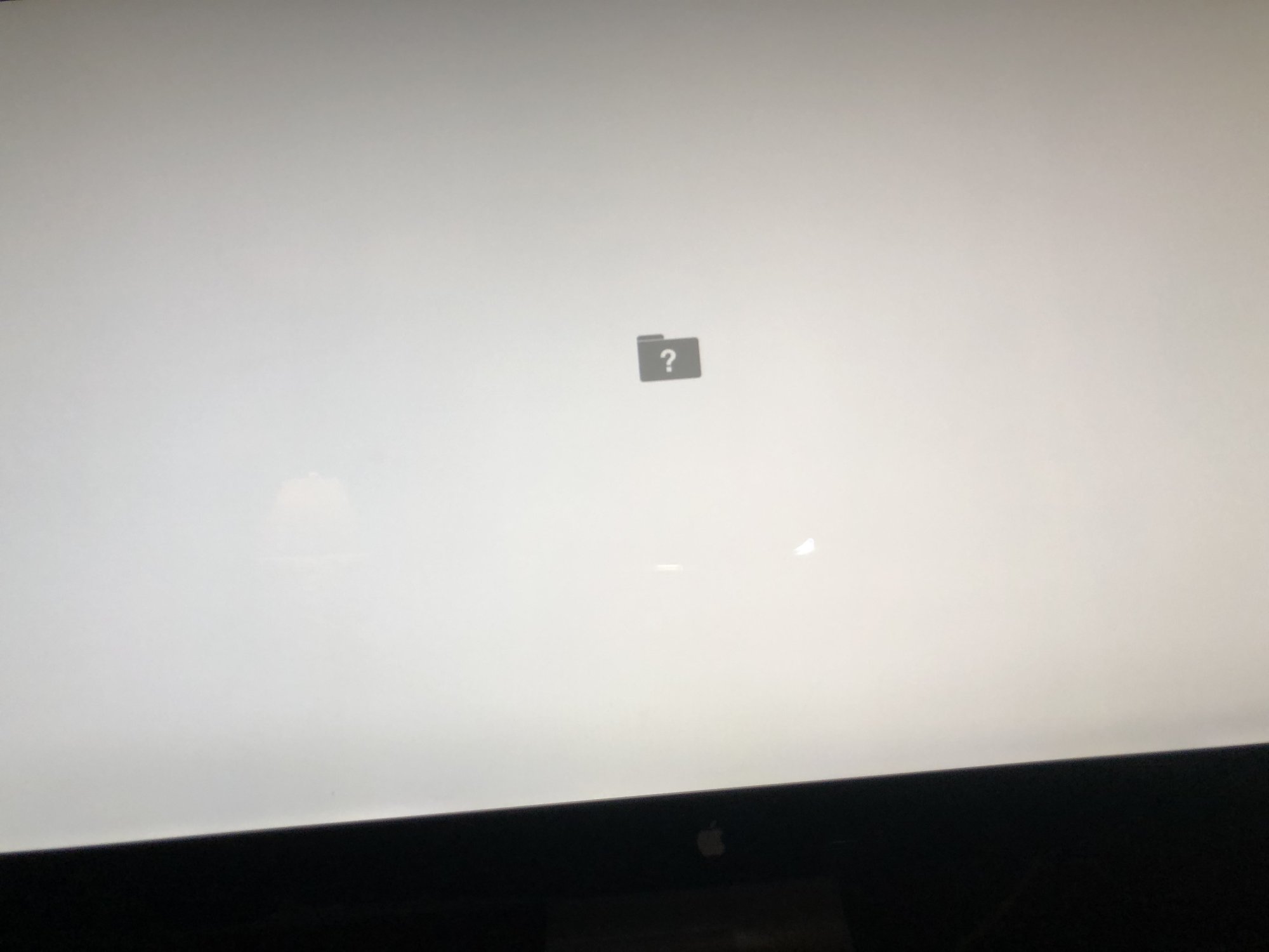

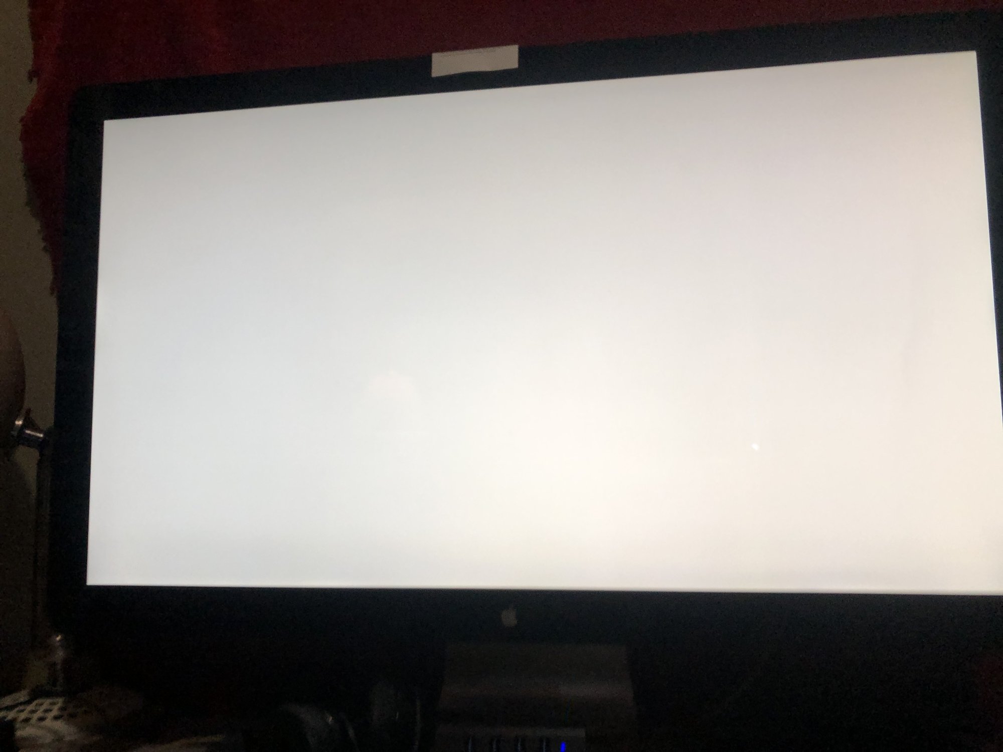

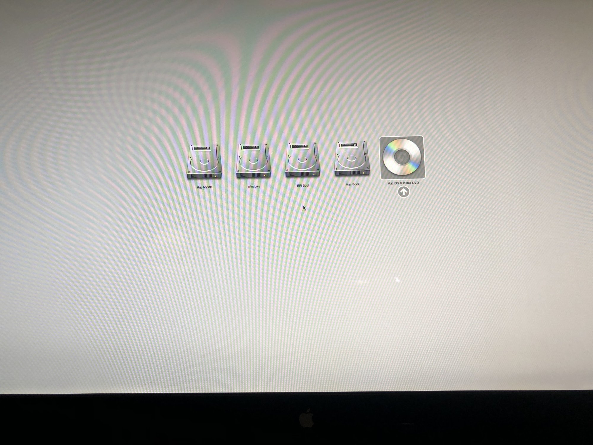

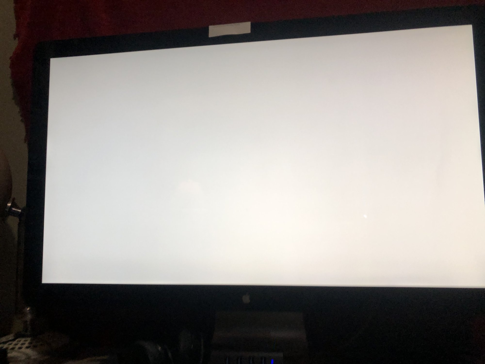

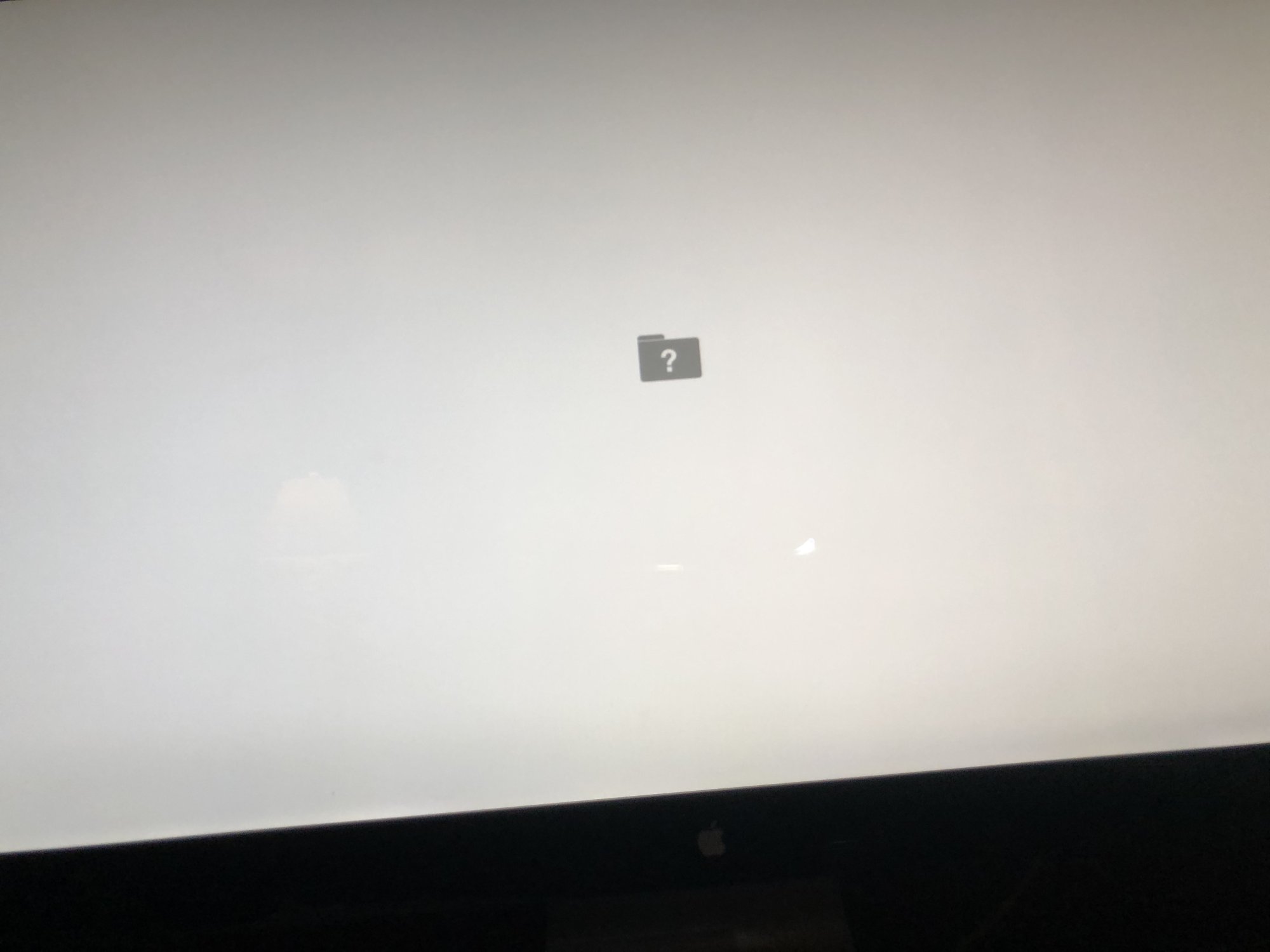

well, trying to boot from my old cd's and im getting a plain white screen, though i do hear the cd access a littleED813AE9-BB8B-44DF-85E0-3F5EE0162054.jpeg95F420A5-A1E6-43BF-ABB9-2727C042D9DE.jpegimage.jpg

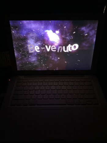

I have booted Leopard on a late 2010 MacBook Air with the 320M. I just had to remove the GeForce-related kexts to prevent a kernel panic.

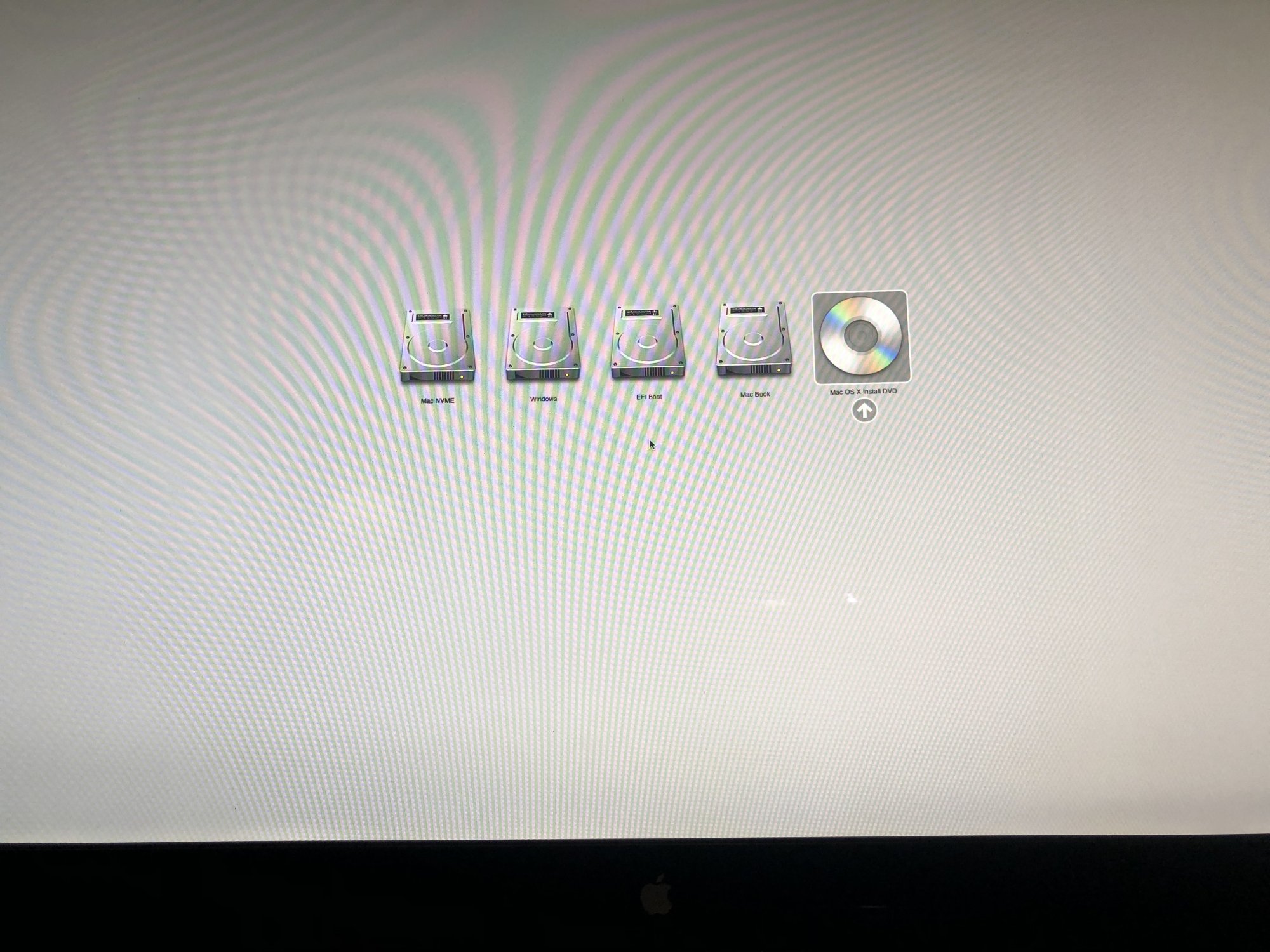

able to do a pram reset finally, but even with an external apple keyboard, this is all im getting now
Hopefully you’re not saying that your partitions are no longer showing up.
If you’re interested in skipping the install process and just want to do a simple image restore, I could make a fresh Leopard boot image, compress it and upload it today. Do you have a hosting site you’d recommend?
As I said, the whole install deal just will not work. I feel it isn’t worth the time editing the installer, troubleshooting, starting over etc.

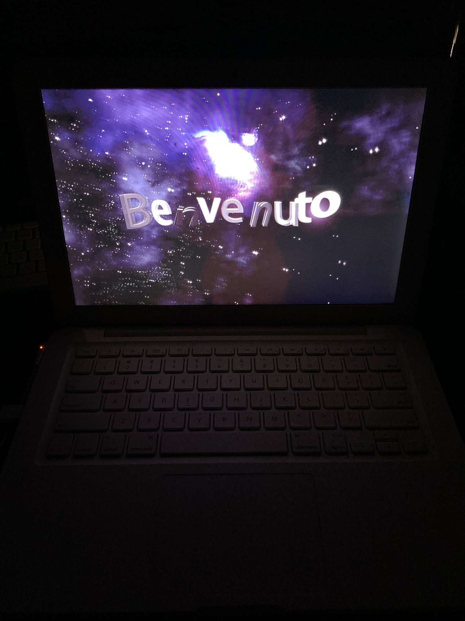

Well it actually installed and booted on a Poly Unibody MacBook, which shipped with 10.6.1.
It does not check the ID of the board, just the CPU. Since the white Unibody MacBook uses the same Penryn chip as so many Leopard notebooks, it had no trouble recognizing the ID and continuing.
I now have a Leopard Boot image that can be restored to any drive using any Mac and then tested by simply allowing it to boot or mounting the drive to a booted machine and editing any kexts or such that must be modified. I could upload the compressed image, or does somebody know of a good reliable 10.5.8 Hackintosh build that could be restored to a drive similarly? I think 10.5.8 is best because there are some Macs that will simply KP if using 10.5.6 or earlier, even different builds of the same point release.

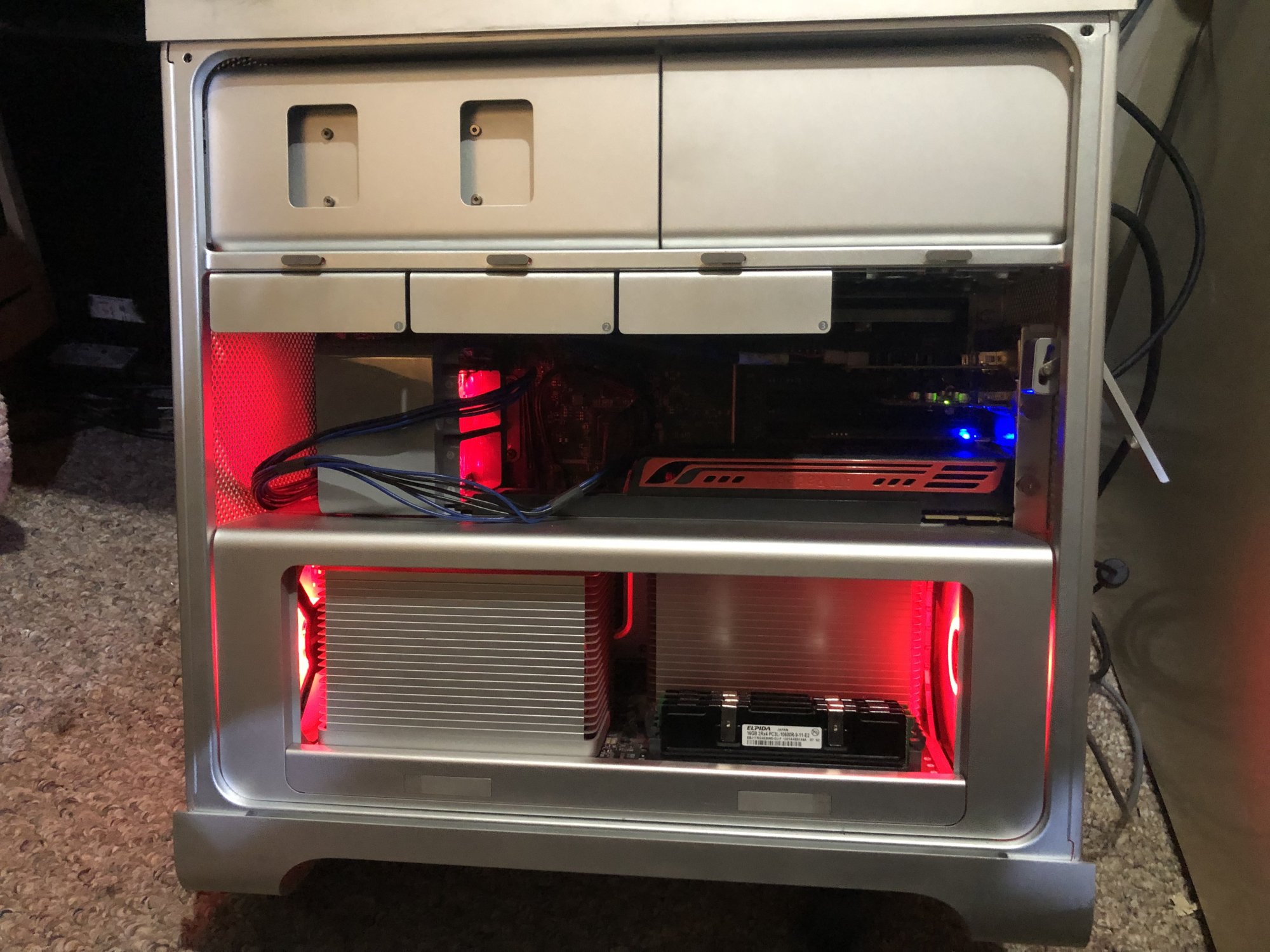

no, after putting my rx570 and my nvme back in, it behaves properly again. could be just my cd's since they are not original leopard cd's, just burned ones
