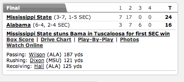

Since you brought it up...how 'bout them Bulldogs!!!
