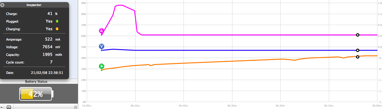

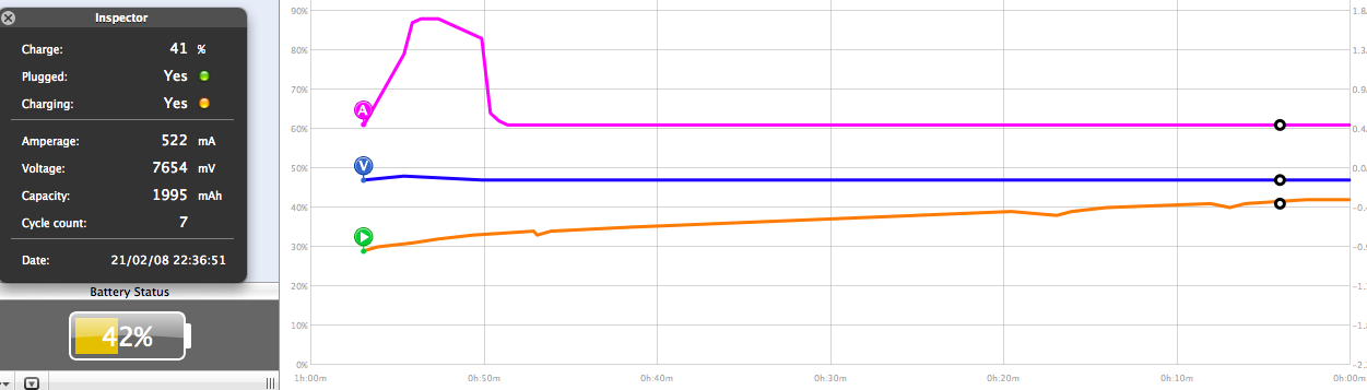

Hey, I have some interesting updates here. I found the software on google groups very easily.
I did cops and then OS X said the usual 7.5 hrs to charge...then I installed the software and the battery was getting charged with around 500 mA. Now, all of a sudden, it shot up to 1655 mA and OSX says it will be charged in only 2 hrs (it's currently at 25%). I will let you know on the accuracy of that shortly, and I'll also post the graph of the charge.
thanks so much!
Edit - seems as though the issue is not fixed. Check out the battery logger graph below...it seems to be trickle charging at 500mA all the way through.
