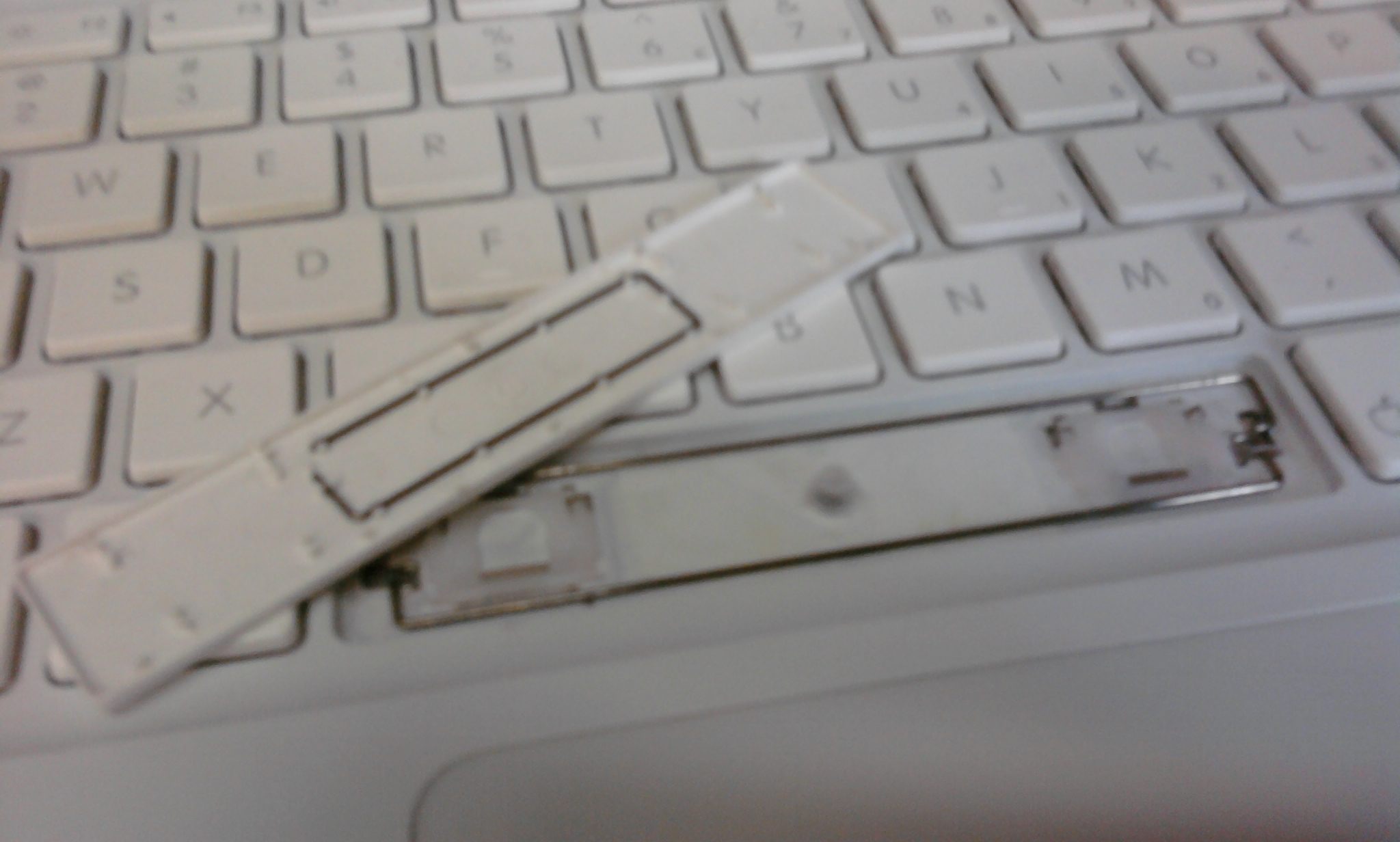

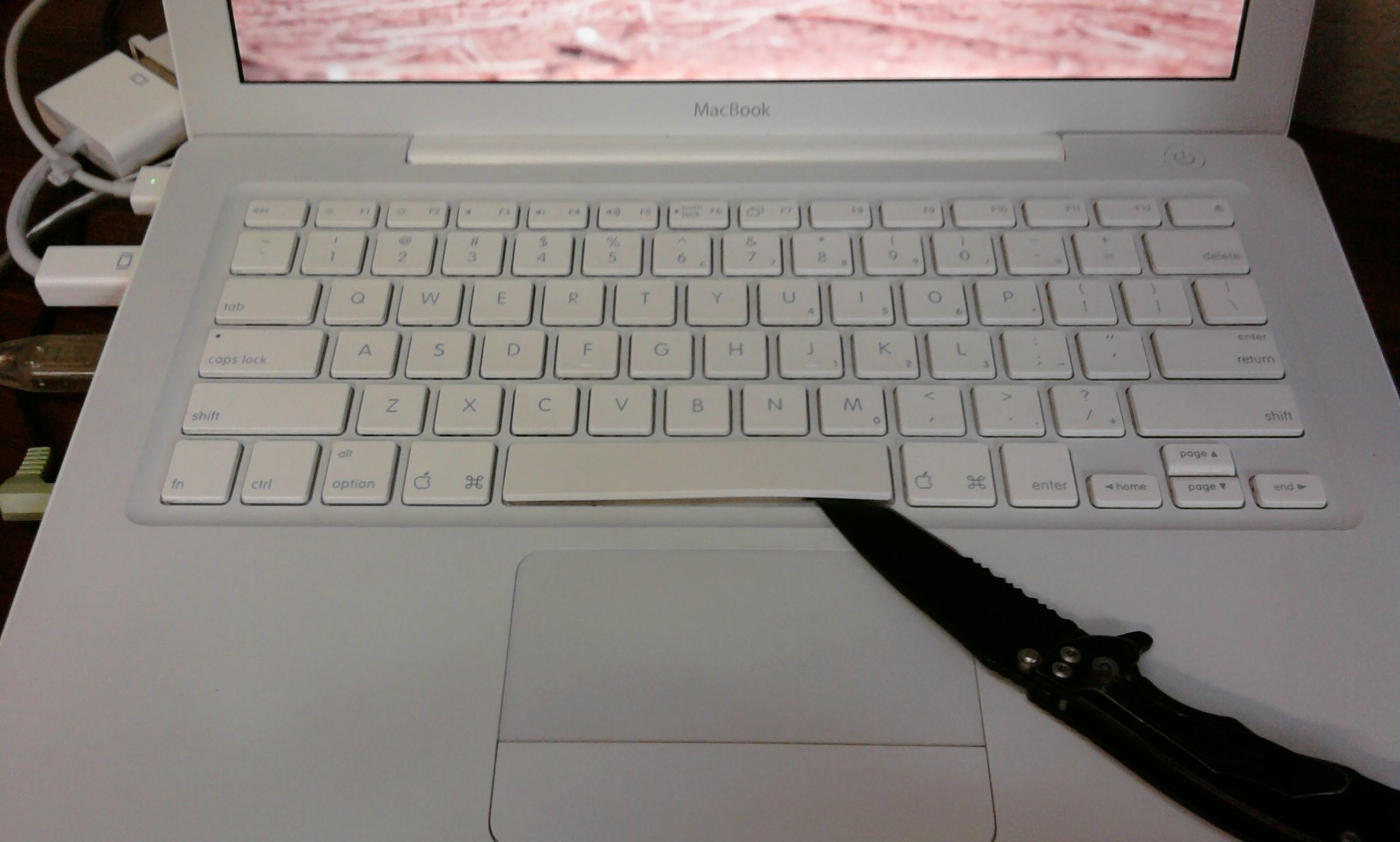

If you happen to spill a sticky substance on/in your Macbook, do not fear. Contrary to what some say, the keys pop off just dandily to allow cleaning. You have to be pretty careful, as the keys are certainly held in there differently (better and stronger, IMO) than they are on other computers. Simply use anything you feel comfortable with to get under the key and slowly pry up. Again, be careful, especially of getting the object wedged under the "scissor" mechanism that holds the keys up. Once the key is off, simply use a Q-tip or something to wipe out the stickiness, and be sure to dry up. You will notice that the actual contacter is shielded under a plastic "nipple", so you shouldn't have to worry about any liquid getting into the actual circuits, unless you really take your laptop for a swim.

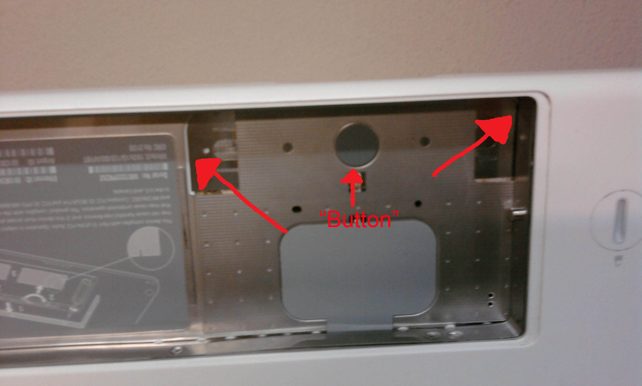

As for the button itself, it is more difficult. The best way I can see right now is to remove the battery. You will see a small grey rubber dot, about 1/2 inch in diameter (about 1cm for the rest of the world 😀). This is the actual button for the mouse, and if you depress it with some force, it will "click" the mouse. To the left and right you will see some symmetrical, shinier metal. Click the trackpad itself, and you will see that this is the actual key. In my experience, the stickiness was mostly taken care of by wiping around the edges of this surface, where you can see a little bit of the white polycarbonate of the case peeking through. If this does not help, further disassembly may be required. It appears as though there are screws holding much of this area around the battery compartment together, and I am sure that by removing most of them you might be able to expose the entirety of the button. I do not want to try this myself just yet, as the above mentioned wiping seemed to fix most of my problems.

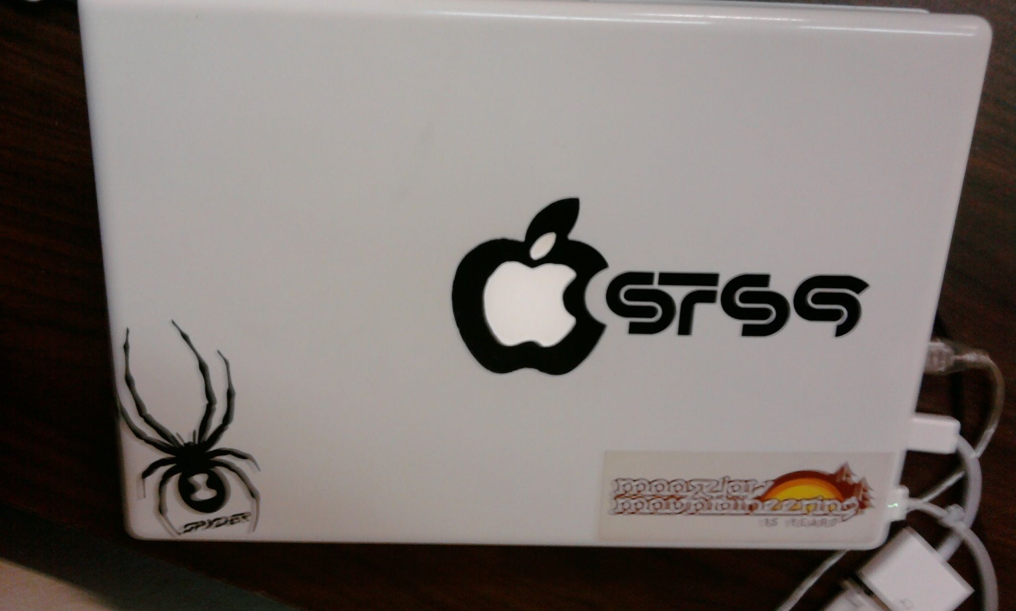

Personally I am a fan of "pimping out" my Macbook to some degree (see attached pictures).
The area behind the screen has seen a good few stickers on and off. Unfortunately, many of these have been the pain in the @$$ ones that leave behind that sticky residue. There really is no other effective way to remove these than to use a liquid of some sort, your fingernails, and a paper towel. Just moisten the paper towel with the solvent, dab at the residue, and use your nails to scrape it off. I can personally attest that lighter fluid does not have any negative effects on the case, however, I recommend that you test whatever it is that you are using in a less conspicuous place, shall we say, the bottom?
