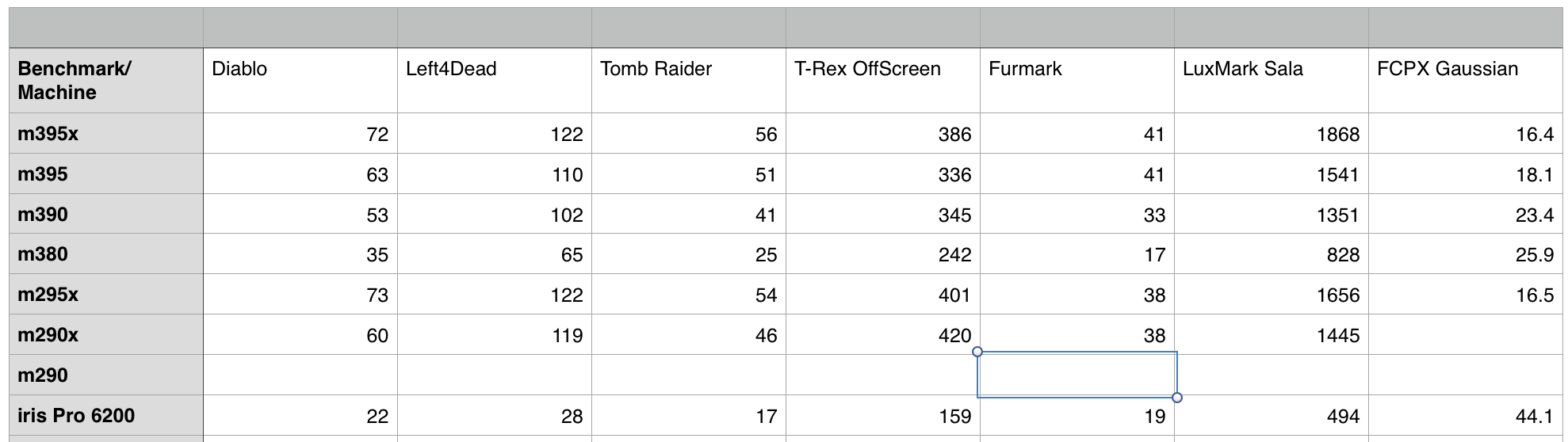

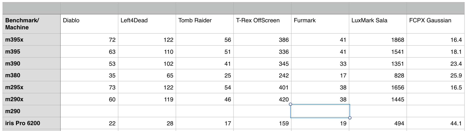

Cobbled together from barefeats tests done previously, my own tests (I did run furmark on my m290x), and so on. Apparently, no one cared about the m290 machine, which is understandable. The Trex offscreen is a little strange, but I don't think it makes much difference. Note that some of these tests involve the CPU.
So t

You're welcome. Thanks for the sacrifice so we could get the benchmarks while you had it!
I still think the 395X is overrated though, look @jerwin's table from barefeats' benchmarks. The 395 is the sweet spot.
It's what I'd get if I were getting an riMac (going to try wait out for Thunderbolt 3).
But if you have the money, of course go for it!
Thanks, I chose the m395x for the 4gb of ram. That's the main reason. I realized the 5k display is using 1gb just for the display. Hopefully the imac will last 5 years or so.
