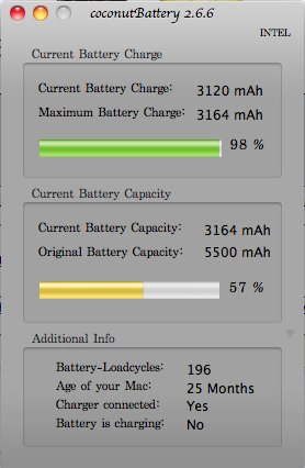

Below is the battery capacity on my 40 month old Black MacBook that I use as a desktop replacement. It only has 45 battery cycles because it primarily sits on my desk, plugged in 24/7.
1c0vzb
