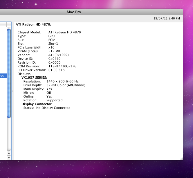

So finally, thanks to fouel, I got the power cables for my ATI HD4870 512MB a few days back!
- Today I fixed the ATI card in SLOT 1 and my old NVIDIA in SLOT 2.
- Then I connected both the power cables to the back of the card and to the board.
- I connected the DVI cable to the right most slot of the nvidia card and powered on my MAC PRO...it started with the chime and then it froze.
I started it again and the front white light keeps blinking rapidly. I tried to Reseat the RAM etc. but it keeps blinking. I then removed the ATI card and switched on - it could boot into SAFE mode like before.
Is there a specific manner to connect the power cables of ATI to the board?
Help! 🙁
Switch the cards in their slots. If it doesn't help, remove the GT7300, boot to DOS (CD/USB), reflash, boot to OS X.

You don't need to have the 7300 in unless the 4870 has a bad BIOS and won't boot at all. Put only your ATI card in and boot from your DOS CD by holding C.

Hmm I was thinking of doing it via Zeus flash tool because I'm not very well versed with DOS booting. Secondly, the mac pro doesn't boot at all except in safe mode - in which the superdrive is disabled. You think the USB booting should work? Any links on how to make that possible?

Thank you Fouel and Cindori for all the guidance and help! 🙂
I could successfully flash my Ati HD4870 512mb to my Snow leopard osx 10.6! 🙂
Initially the mac pro wouldn't boot to the OSX even if I removed the ATI card. I figured that there was a little loose connection in tightening the screw plate around the graphic card slots. Later on, the ATI power cables seem to obstruct some capacitors I felt. So i neatly arranged them around the 'fan' cabinet and switched on the mac pro. It booted via safe mode (since the nvidia couldn't boot the main os). I then used Zeus to flash the ATI with the ROM that fouel had given (thanks fouel 🙂 )...2 minutes later the message blinked that it was successfully flashed.
I switched off, removed nvidia and put ATI in slot 1. Connected by DVI - DVI monitor and it booted directly into OSX 🙂 I have attached screenshot of the system profiler!
I opened an FCP project and then put in some heavy filters and it rendered smoothly and quickly! I also played a movie and it worked fine! 🙂
Currently its connected to two displays - DVI to DVI monitor and DVI to HDMI LCD TV screen!
Thanks so much! Saved me from spending huge money to apple! 🙂

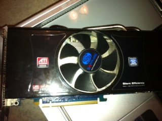

help..
WTF? Fail? 4870 sapphire radeon flashed with ati flashing tool in osx 10.5.8. with sapp-512-4870.rom. thought i had an handle on this, but i was wrong. i don't have bootcamp so it's hard to any thing with this card cause when installed all i get is a black screens and repeating mac start up chime...
sincerely,
up a creek..
