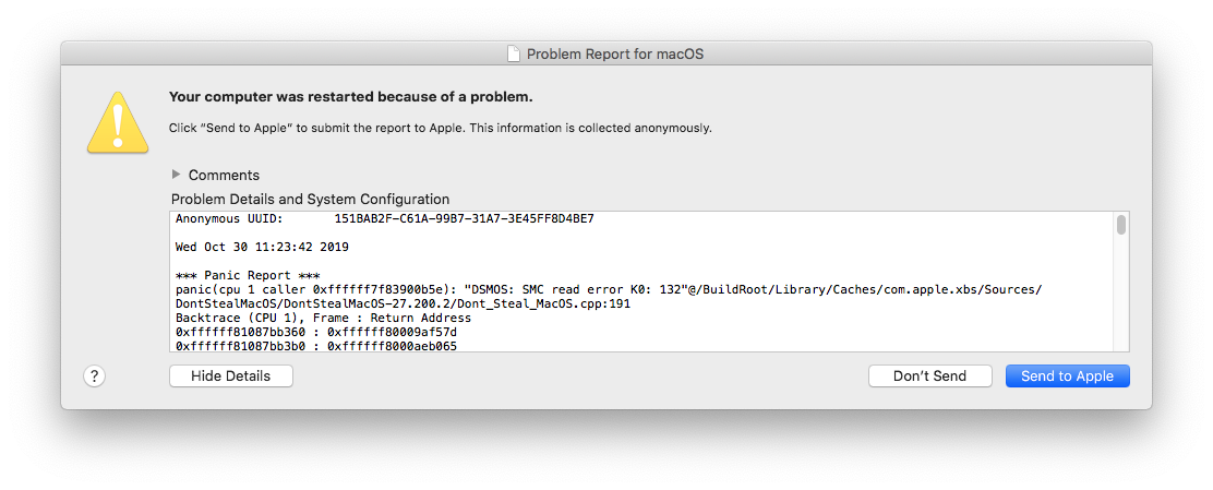

Who is the guy who wrote this? I want to meet him in person.
