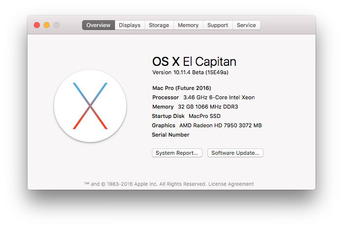

I've checked the serial and "about" screen it says 2010. It's a single quad 2.8 with the 5770. Asking is $350, which from what I'm researching is a steal? Please correct me if I'm wrong
The "About this Mac" is meaningless. I can easily give you something like this.
By the way, the serial number check should be accurate. And yes, if it's in good condition, it's a steal.

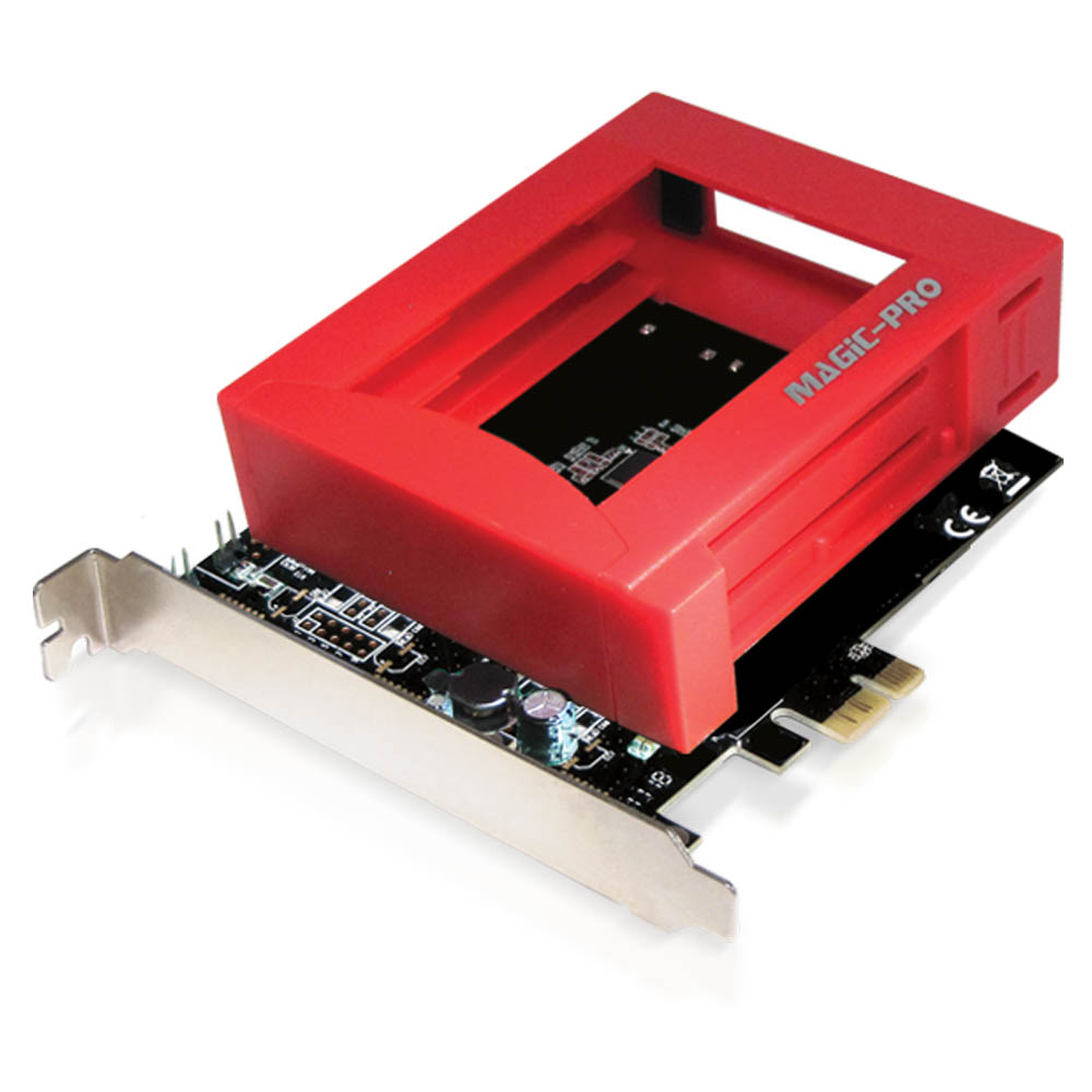

Excellent info and those look to be really cost effective upgrades! I think I'll do the SSD first and take it from there.
Regarding the size of the SSD, and bare with me here because my knowledge on this is next to nothing;
Can I just go with a 128GB(only $50) and only keep the OS on that drive along with a few select programs I use most often and basically get the same performance enhancement as using a large SDD for everything?
For example I might put the OS and a small video editing program on the SDD and I would keep all my media on the 500gig that's already on there along with backup...
Larger capacities of the same model are generally faster, but any size is going to be vastly better than a traditional HD. Personally I wouldn't go less than 240GB for a system drive. With video editing I'd think you would end up with cache and temp files on the OS drive. (Though you could maybe set it to use the media drive, but that partially defeats the purpose of having an SSD.) If you do iPhone backups to the system drive that will eat up space. If you are downloading movies you'll have to constantly monitor and empty your downloads folder.
It generally isn't much more to make that step up - the Sandisk I linked is $44 for the 120GB vs $64 for the 240GB.
