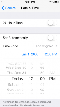

You may have noticed that the latest system time you can set on an iPhone is on January 1, 2038. But why does it have to happen on a time when we’ll probably still be alive? Will we be able to continue using our iPhones 23 years from now? To answer these questions, I researched and conducted an interesting experiment based on I found. Read on to find out what will happen!
Why the Maximum Date is 2038
The iPhone keeps the time by calculating the number of seconds passed since January 1, 1970 at midnight GMT. Many iPhones store this particular number as a 32 bit integer, and the maximum possible 32 bit number is 2^31−1 (or 2,147,483,647). This means that after 2,147,483,647 seconds since January 1, 1970 (or January 19, 2038 at 3:14:07 GMT), the iPhone's system time will overflow, at least for the 32 bit devices, causing various problems to arise.
In other words, the 32 bit (and possibly the current 64 bit) iPhone's world will terminate on January 19, 2038.
You may be thinking, then why is the maximum date January 1 instead of January 19? That date is probably Apple’s method to prevent casual users from breaking the clock too quickly.
The Experiment
To find out exactly what will happen to the iPhone on January 19, 2038, I put my iPhone 5 on iOS 8.4.1 to the test. I set its system time to January 1, waiting for 18 days to see what would happen. For additional fun, I started the stopwatch in the Clock app at the earliest system time (1970) just to see what the clock would look like 68 years later and beyond.

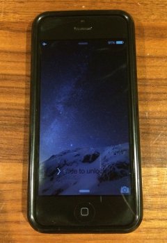

When I came back, the clock must have struck 3:14 AM, but I’m not exactly sure if it did. That’s because the clock started glitching sporadically. For some odd reason, the system time suddenly became 8:48 PM GMT. That’s when I put the iPhone 5 to sleep and re-powered it on. What I saw right after that was rather astounding:
That’s right: The iPhone’s lock screen STOPPED displaying the time altogether! Fortunately, I was still able to view the current system time by swiping into the Notification Center.
So then I proceeded to unlock my iPhone. I entered my 4 digit passcode correctly, but absolutely nothing happened after I tapped the fourth digit. This meant I could no longer unlock the device. It didn’t completely freeze though; I could still swipe back to the lock screen and swipe again to reenter my passcode. I tried entering the wrong passcode for the heck of it, but instead of telling me the code was invalid, it did absolutely nothing as well.
Even though I couldn’t unlock my iPhone 5, I wasn’t completely locked out. Fortunately, there’s Control Center which I could use to access a few apps. The stopwatch, calculator, and camera worked just fine. The brightness slider, however, ceased to function. I should have but forgot to test the flashlight and WiFi capabilities.
After testing enough of that, I figured I’ve came to my conclusion: that the iPhone will still operate but not to its full extent. Little did I know what would happen next when I plugged my iPhone 5 to the Lightning cable…
