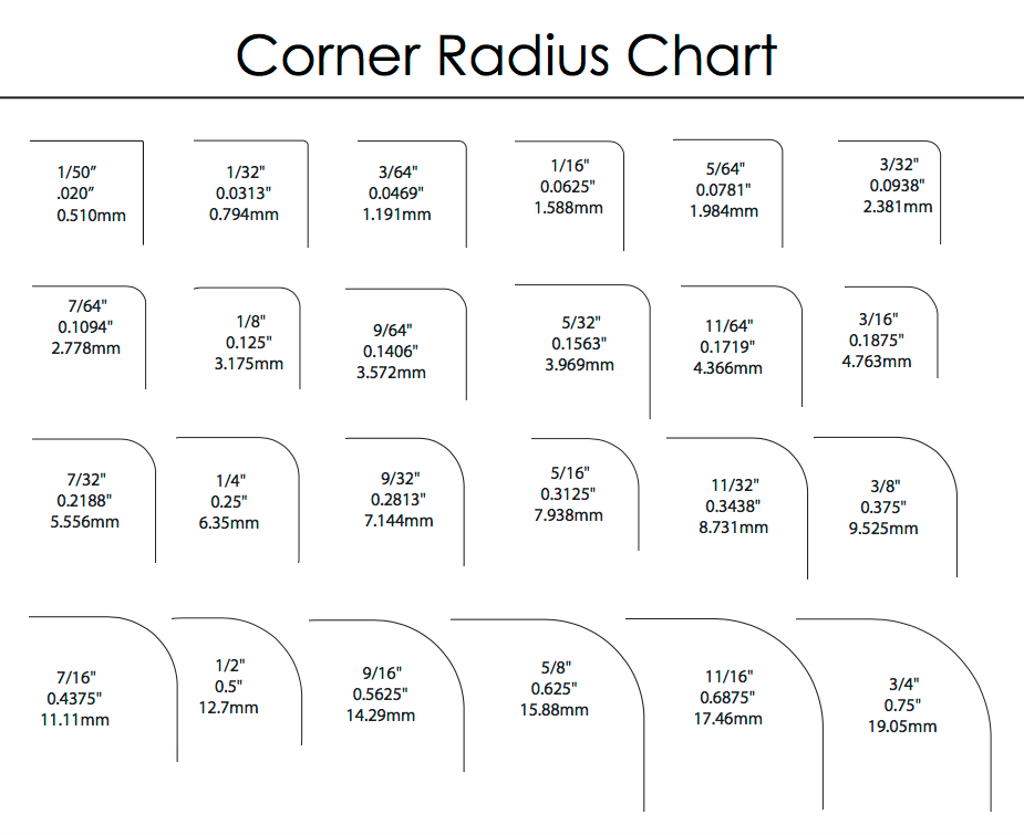

—reduce the roundness of those rounded corners. The body and the screen can have rounded corners without them being quite that rounded. Very rounded corners make a larger part of the screen less useful.

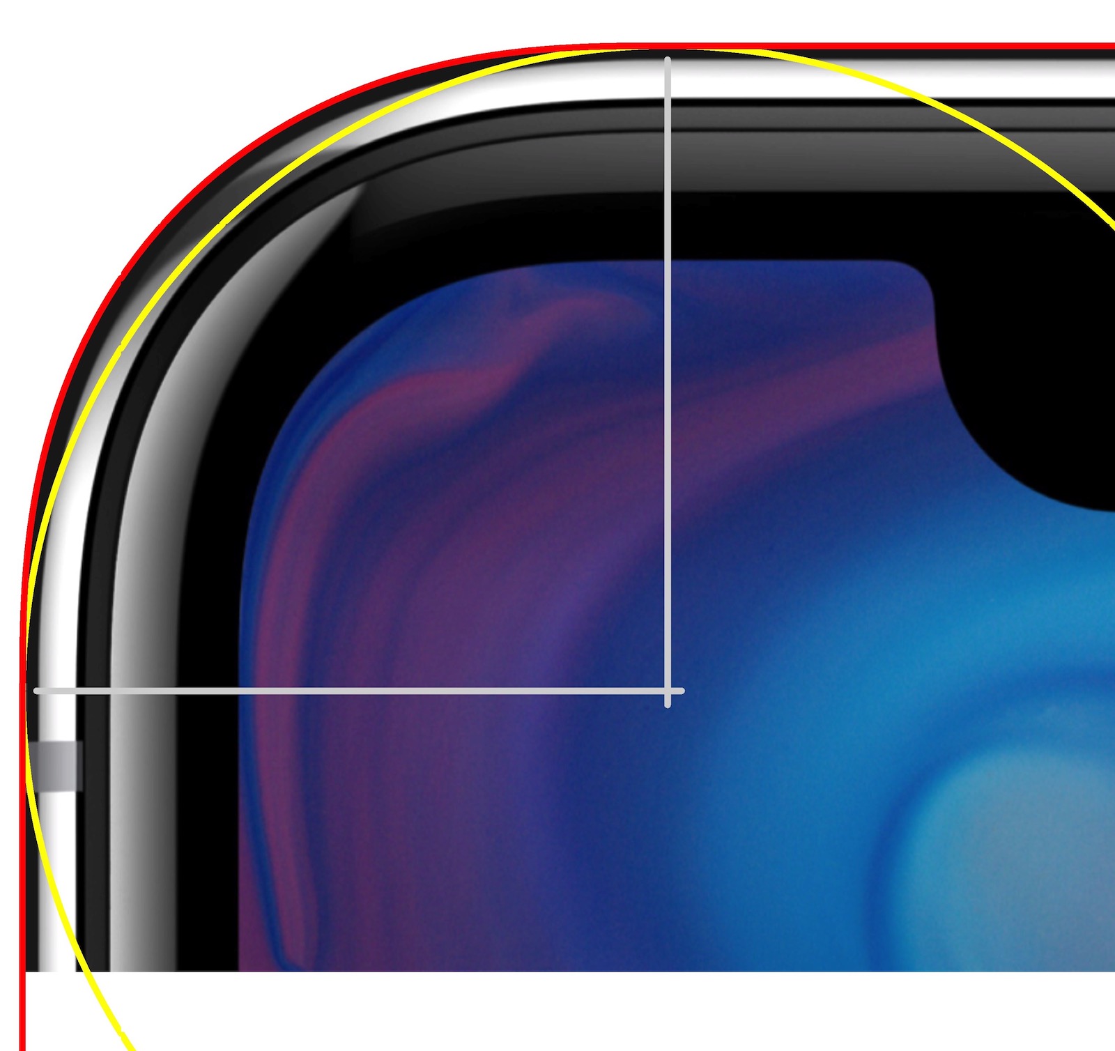

this is mostly on topic but doesn't address many of your points/ideas..
regarding the corner roundness and the radius chart image..
Apple doesn't use radiuses anymore.. they use curvature continuous nurbs..
these are smoother curves/surfaces/blends than G1 tangency..
how any of that relates to what you're saying about reducing the roundness can (hopefully) be seen in this image:
• the yellow curve is a circle/radius.. like the things in your chart..
• the red curve is not a radius.. it starts the blend very relaxed then tightens up near midpoint then loosens again.
so they're effectively doing what you're wishing for just in a different, and arguably much more elegant manner.. both the arc and G2 blend are intersecting the top&sides at the same point.. they're affecting the same pie(?) of the corner.. but the shape Apple uses there does actually lessen the amount of infringement upon useable space.. or again, effectively, it's doing the same thing as using a smaller radius would do except it looks better..
granted, this is a super fine detail (that's much harder to manufacture than arcs, fwiw).. not many people will recognize what's going on there.. but i do think when people have it in front of them, in various lighting etc, they're going to appreciate the look even if they don't know exactly why.. it will be details like this which is (part of) the reason.
the look, and the reflections, is the main reason they do this.. secondary bonuses are that it doesn't eat up as much pixels/space where at first glance, it may seem like it does.
also, a little difficult to judge in this image but it appears the corner of the screen isn't a direct offset/mimicry of the outer curve.. i think it might be pinched up in there a little more than the white crosshair demonstrates with the outer curve.

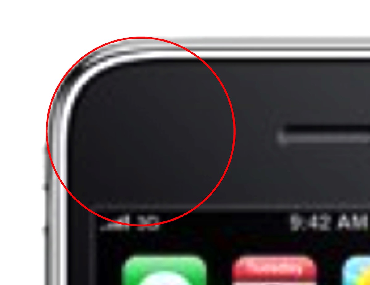

for comparison.. here's a 3GS corner.. those corners were radiuses
(couldn't find a high res shot of that thing.. didn't look too hard but... 😉 )

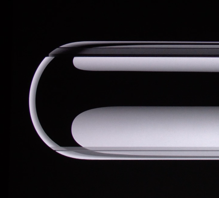

another one of those details from a slide at the keynote.. without getting into another technical breakdown of this view.. i'll just more simply say.... that's industrial design porn right there.. 😉
moreso than the previous example.
(but i will add this.. those two prominent horizontal reflections we see.. those are being shaped like that because of the curvature details described of the top view earlier.. (well, the 'front' view i guess most people would think) )
