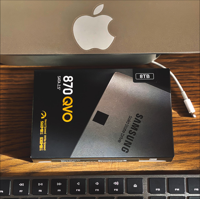

I have always used the Samsung 870 QVO series and I have not had any problems with them.
Probably worthwhile looking at the reviews on Amazon to get an idea as to how they perform.

Just took possession of a Samsung 870 EVO 1TB, which I plan to use to replace the primary drive in my 2012 Mac mini.
I was going to buy the Crucial MX 500, but there was a really good deal on the Samsung which I could not pass up.
