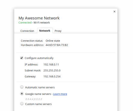

If I can't reach the connection page (like you mentioned in the OP), then usually the store's network connection to the outside world is completely down. A some places, that don't have a login screen, I often get a network connection but then the browser doesn't go anywhere when I type in a URL. In these cases, I sometimes find that switching to (using) "Google name servers" under the network tab solves the problem -- in other words the place's DNS server isn't working properly or hasn't been setup properly. See image below re: switching DNS:
So, you could try that. Click on the bottom right of your screen and then click "settings", then click on the name of the network, which will bring up the panel shown in the image above. More detailed instructions here...
