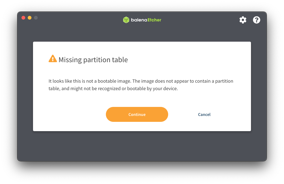

I also tried using Balena Etcher instead of Disk Utility and got an error saying the image was missing a partition table.

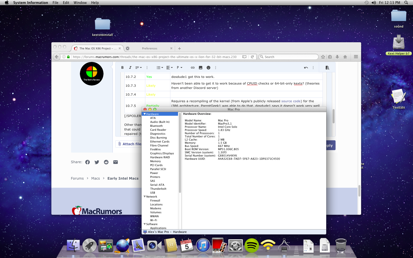

Got my CoreDuo HP Compaq nx7400 running with full graphics acceleration on this build of Lion. Hello from said 32 bit HackBook with GMA 950 graphics! Ignore the fact that it identifies itself as a Core Solo... had to disable one core in the BIOS or else it wouldn't boot (or else I had to specify cpus=1 in Chameleon with the second core enabled, resulting in Lion identifying it as a Core2Solo lol)

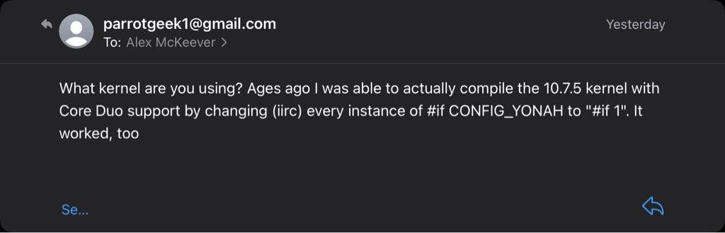

Ethan (ParrotGeek) has came through for getting 10.7.5 working on CoreDuo based Macs and Hackintoshes. Y’all might want to try this to compile the 10.7.5 kernel for 32 bit.
Not a bad idea, it should work I’d imagine. The question is that would we still need 32-bit kexts from a Lion developer preview? I know the Finder will.
I might try to give building this a go soon. I don’t think I have a 32-bit Mac that’s Intel though, unless you consider the first generation Apple TV as one.
As for Apple TV support, that might be difficult. I’m trying to get the kernel that the current image ships with to work, no luck yet. I’m unsure what the problem is with it, but I couldn’t get it to boot even with a Nawcom kernel for Atoms? (with 32-bit support). I wonder if other patches/modifications would be needed in order to run ANY version of Lion on the Apple TV.
