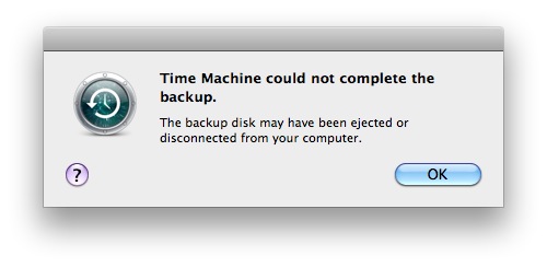

Also one of my hard drives DOES start connecting, but when I try to do a backup via Time Machine it gives me this message:
Ok it says that there are no problems...I even did the extended test...
So now what? My other hard drive that doesn't work on my Mac now works on my PC, by the way.

My external hard drives are normally connected to the Dell U2410, but they also don't work when plugged directly into the Mac. The input source is set to either DVI1 or DVI2 whichever one I have it plugged into.

So my MiniDisplay Port-HDMI cable came today. And...it works!!! I can use my Dell U2410 again...but my external hard drives still don't show up in finder or at all...
So 2 odd things to try.
I've had problems with my external HDs on my macbook pros, due to a not tight connection. When you plug in the drives does the usb cord feel solidly in? If not, I like to take the cable out and push down on the plug end a little which makes it tighter and then plug it back in to the macbook. This has solved my HD not recognized or disconnection issues. I can draw a diagram if you need.
