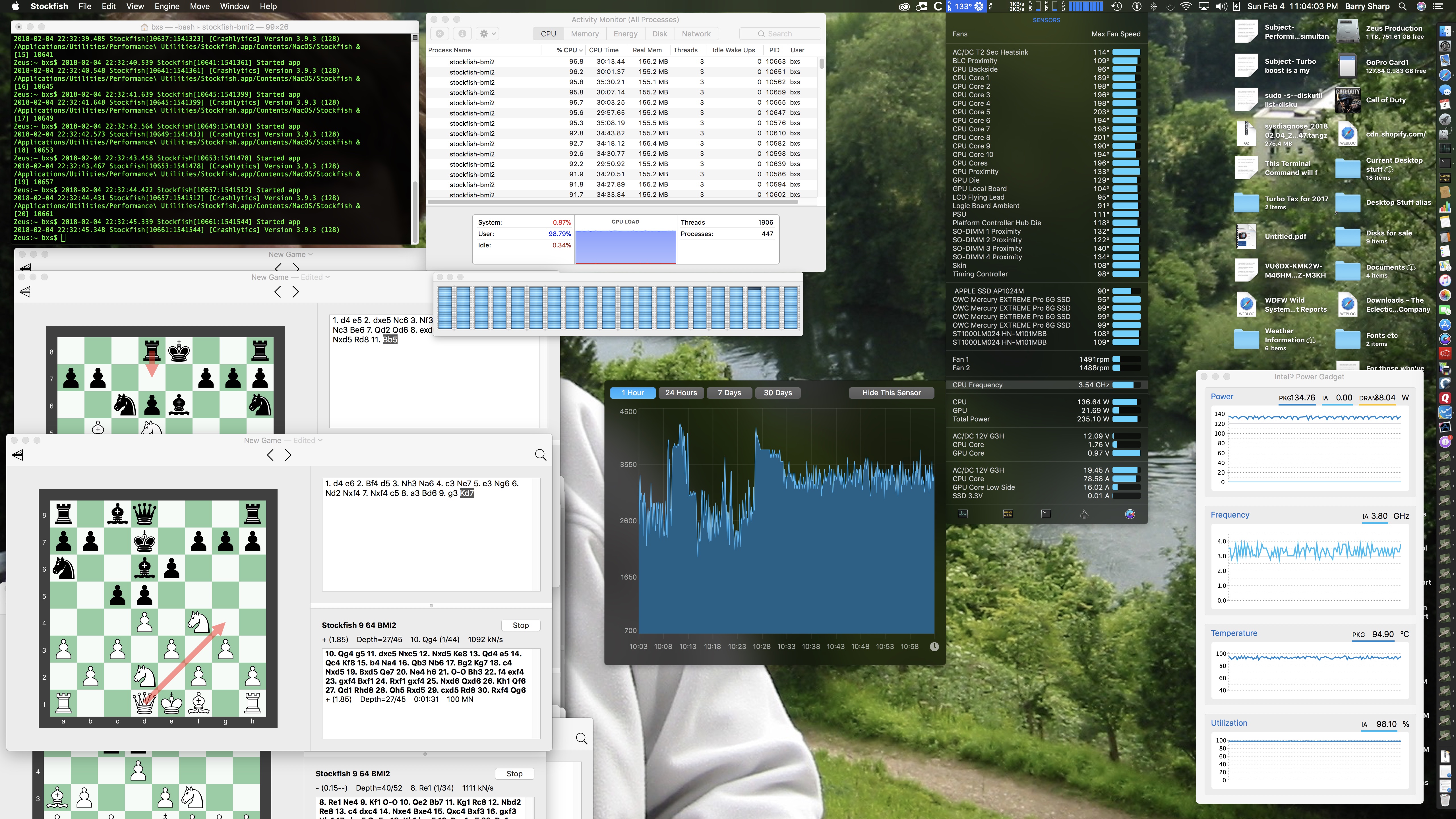

Trying to get my iMP to heat up with fans running above there idle RPM of around 1100 is very difficult. I can get them up to no more than 1600 RPM running a full CPU intensive load across the 10 cares and the 10 logical cores. Temps are always maintained at around 93ºC with a slight up and down trend of no more than 2ºF. With this kind of load running for around 1 hour the iMP simply does not overheat nor do fans run at high RPM.
I'm guessing I will need to introduce some heavy workload for the Vega 64 to get some more heat generated.
I attach a screen shot of my load test having run for around 45 mins.

Curious about hitting 93C. That seems really high. I wonder what the back of the PCB reaches, and what might be nearby. Personally, I’d be more comfortable with much lower temps and more fan noise under load.

Yes, the first iStat I used was not reporting I had 10 cores for my iMP with 10 cores. It reported only 8 cores. I contact Bjango about this and they directed me to download and use below...
https://s3.amazonaws.com/bjango/files/istatmenus6/930.zip
This version (is Version 6.00) corrected the # cores being reported as well as displaying the fan RPM. This iStat version does not provide a means for controlling fan RPM even though it has controls for doing so.... I guess that will come a bit later. I would like to have fan control to evaluate ramping the RPM up to lower temps and maybe avoid the core frequency throttling.
BTW.... I had 20 copies of Stockfish running to get all cores (physical and logical ones) ramped up to 100% along with a few traditional "yes >/dev/null 2>&1 &" running just to fill in and use any spare CPU cycles. 😉
