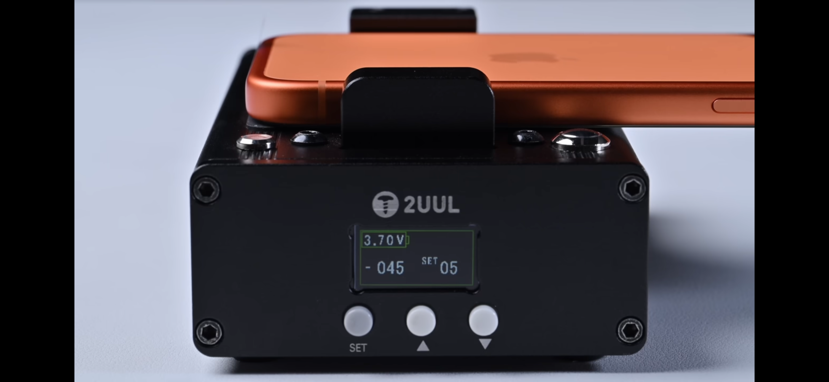

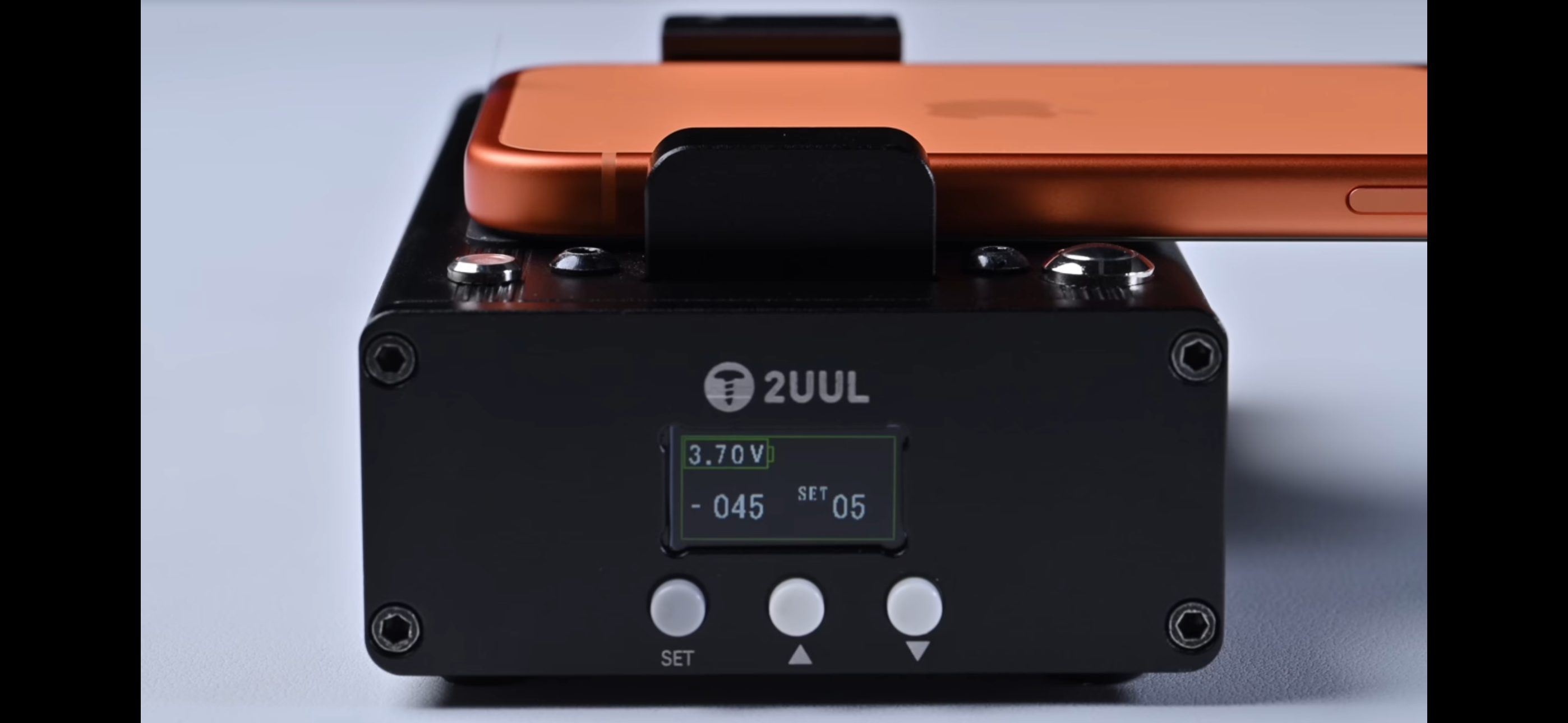

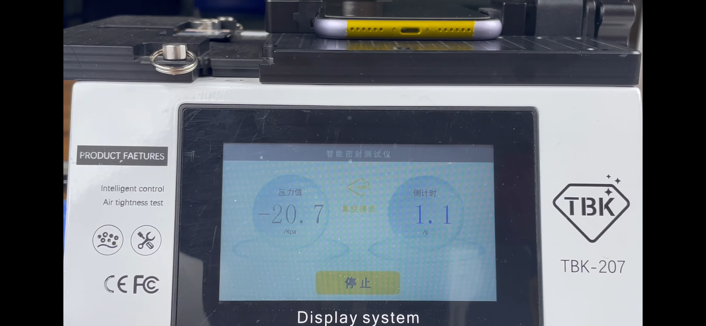

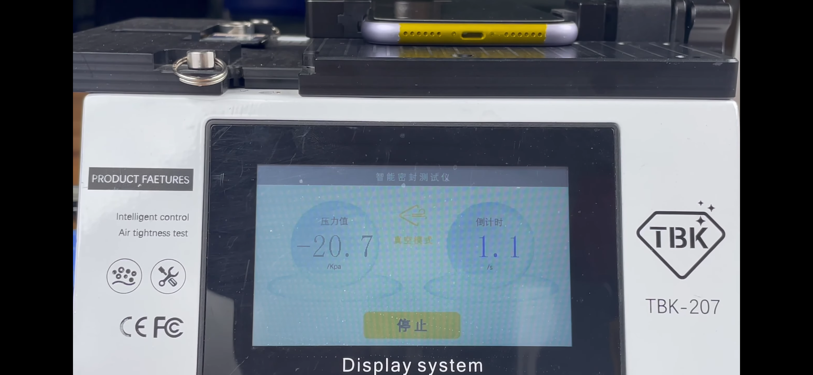

This is standard procedure for professional repair shops to test air tightness via the SIM slot after opening the iPhone. This ensures water resistance. Obviously, technicians don't normally use their mouth and use dedicated machines, but OP did a good job unless he wants to spend $400 on equipment.

Hey there! The first picture is the water resistance machine that DirectorFeng, an iPhone and Apple technician, uses! He frequently uses it when inspecting iPhones for any damage. You should check out his YouTube channel; he has videos showcasing various models from all Apple product families.
