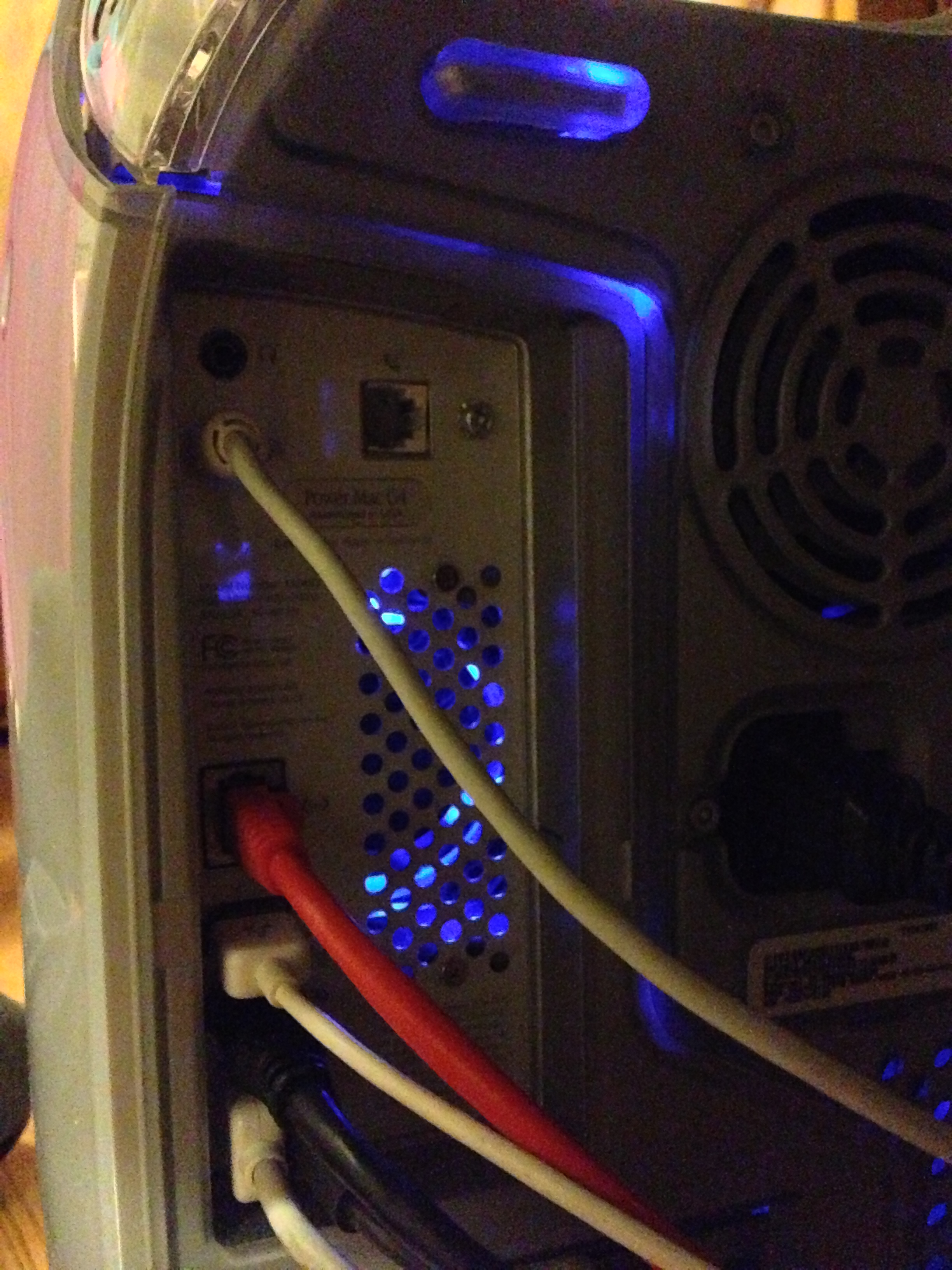

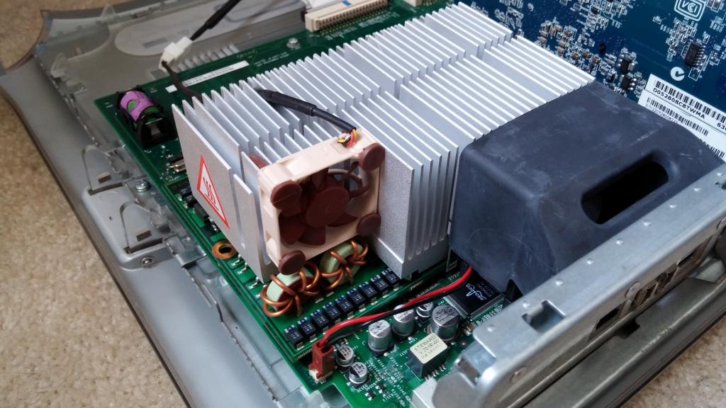

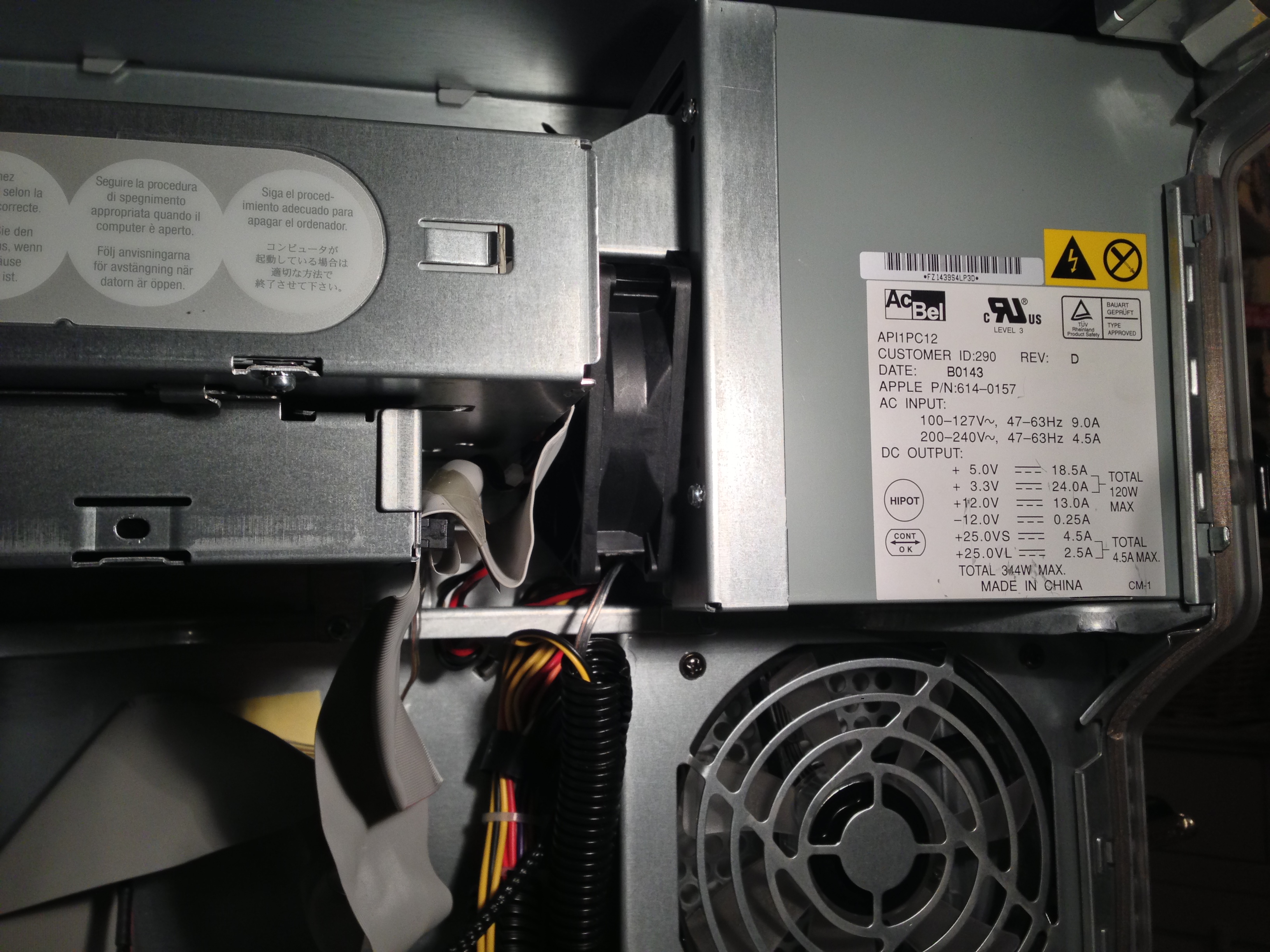

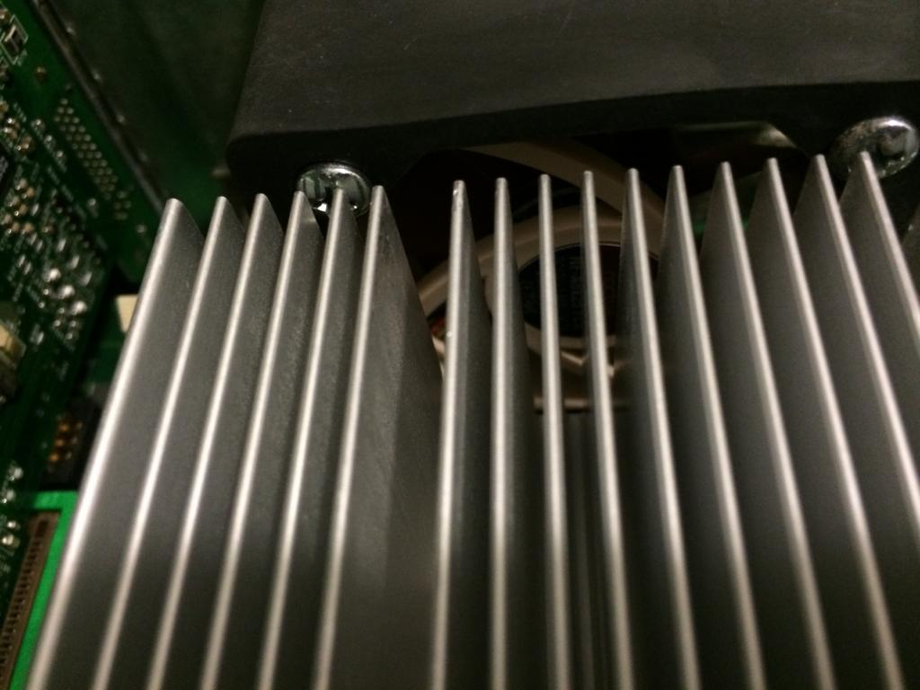

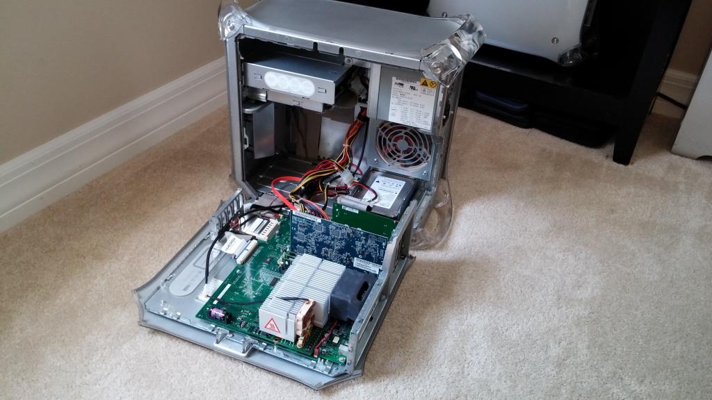

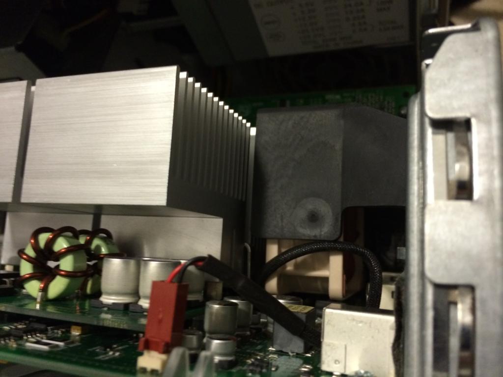

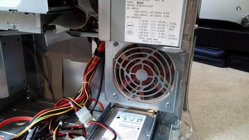

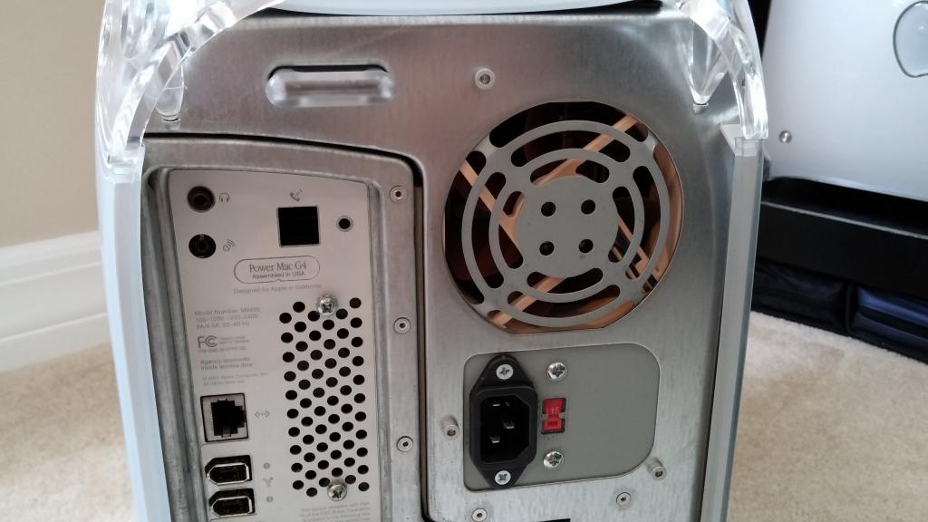

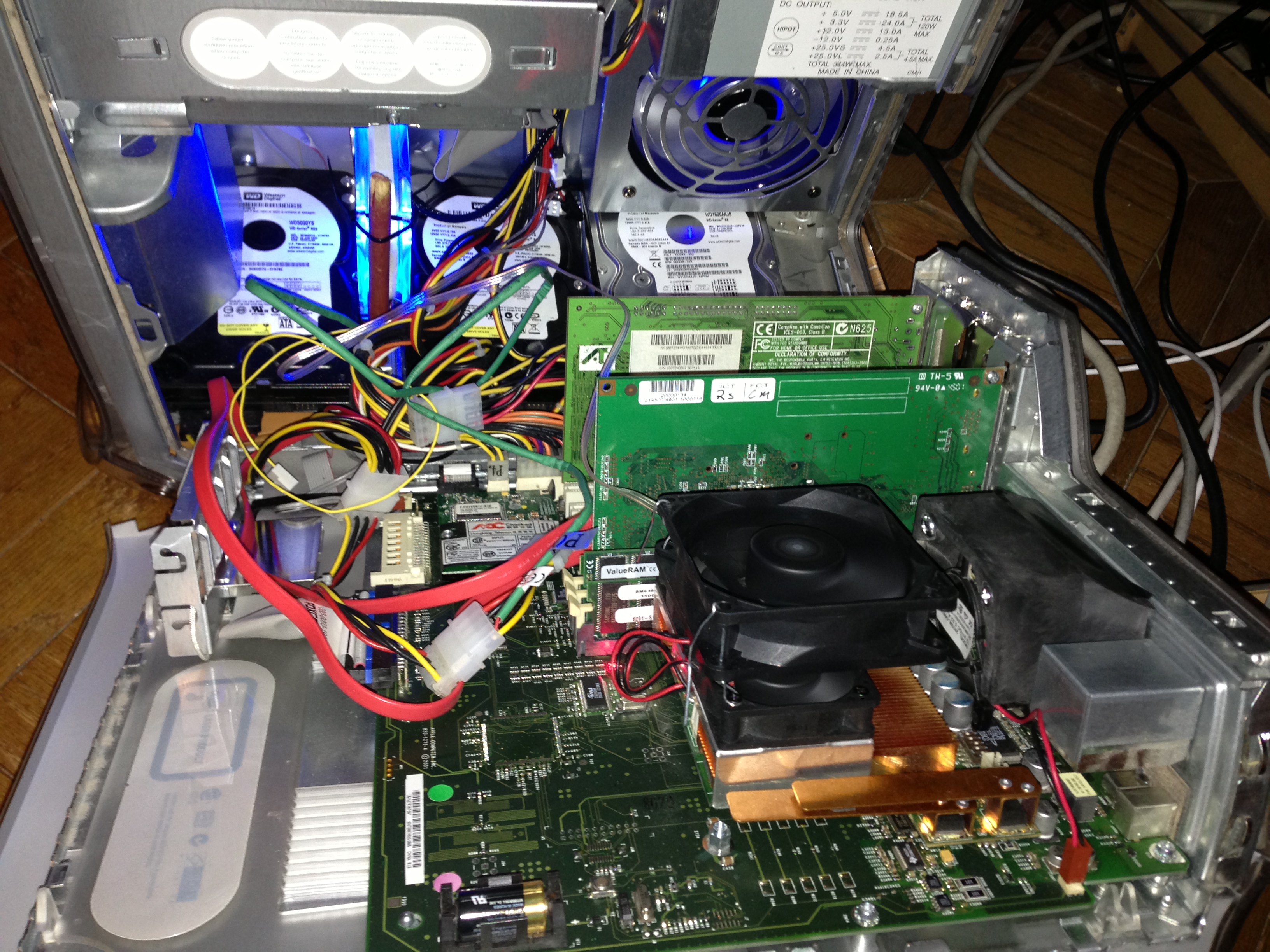

Added all Noctua fans to my Quicksilver. So much more quiet and better airflow. Good investment. Here are some pics.
Very nice, must have cost quite a bit to change all the fans! I'm still looking for quiet fans that can shift enough air for my MDD, so far nothing has kept it cool enough (that machine is spectacularly loud, especially with the Radeon 9800XT fan going full blast as well!)
Cooler Master for my main case fan. b-blaster for my top of CPUs fan and my PSU fan and two other fans as I need (I change internal fans which I have loose in the case around from time to time), one of which is a Thermaltake.
I went with whatever brand I could find with the highest CFM in the size I needed at my local Fry's Electronics. In most cases this involved a certain amount of splicing wires because of incompatible connectors.
Note that these are not current pics (my QS is down right now) but the fans shown here are the ones I use.
Cooler Master 95CFM and b-blasters 62CFM.

I like the LED lights. On the connectors, I take a needle and poke the connector so the wires slide out. I then put that connector on the new fan. Keeps it nice and stock looking.

Hehe, you didn't change the original CPU intake fan. 😀 😉 (I don't even know, if there is a similar fan by Noctua).
Did you do stress test, before and after? By what number did the temperatures drop or did they stay the same?
I have a noctua in my PSU (G4 AGP) and if I do longer work on my Mac, I add a 120mm fan by Noiseblocker (could be even quieter for my taste) in front of the PSU. I tend to believe that at least with the graphite G4s (AGP, GE and DA, maybe the quicksilver, too) the PSU is the most vital part to clear out hot air.

I actually did replace it but I put this one back because I needed it for another project. Yes, noctua makes a fan for every size in the quicksilver. It's a 60mm fan. In that pic I also have a 40mm, a 120mm and an 85mm. The 60mm fan is the same exact size and is so much more quiter.

Thanks for all the links, I'll have a proper read through them. The replacement fan I tried was an Arctic Cooling F12. Connected directly to 12V it didn't really make any difference to the noise situation. Connected to the motherboard fan connector, it didn't run fast enough to move enough air for my liking. I have tried PCI slot coolers in the past, but all my PCI slots are now occupied 😉
Using nap mode, my CPU board temperature usually idles around 38C in winter and 42C now in the summer. Even under heavy load I have never seen it go above 56C.
The graphics card is running with the stock cooler. Unfortunately due to the flashed ROM from a 9800 Pro, the variable speed fan doesn't work, so it's on 100% all the time. What makes matters worse is that the fan bearings are rather worn out, so it's already much louder than it should be. I do have a brand new 9800XT fan coming in the post though, so I'll have to see what difference that makes.
@ BJonson:
Thanks for the pics! I wonder, how big the max size of thickness would be for this small fan. It seems there is 5-8mm more space.

42°C in summer sounds great and it is still that loud?
