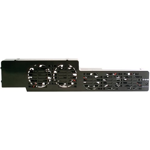

Dont give intec any idea's or one of these things will be released in aluminum.
