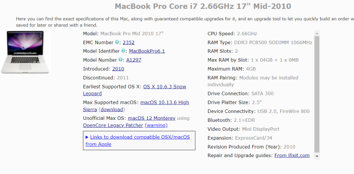

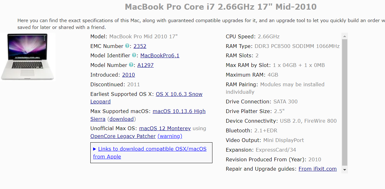

Can you be more specific?
Sorry! I can't believe I thought I had given enough info. I've attached some more info. Thanks!
A few things come to mind.
Try booting from the USB installer, launch Disk Utility and run First Aid to determine if there are any errors that can be repaired. While you are in Disk Utility, what is the current format of MBP internal drive? High Sierra was the first macOS that transitioned from Mac OS Extended (journaled) to APFS.
I'm not sure if your MBP supports internet recovery since the original OS was Snow Leopard. How are you starting internet recovery?
Another possible problem is the SATA cable to the internal drive. The cable is old and could be having degraded performance/errors, but has not completely failed yet.
