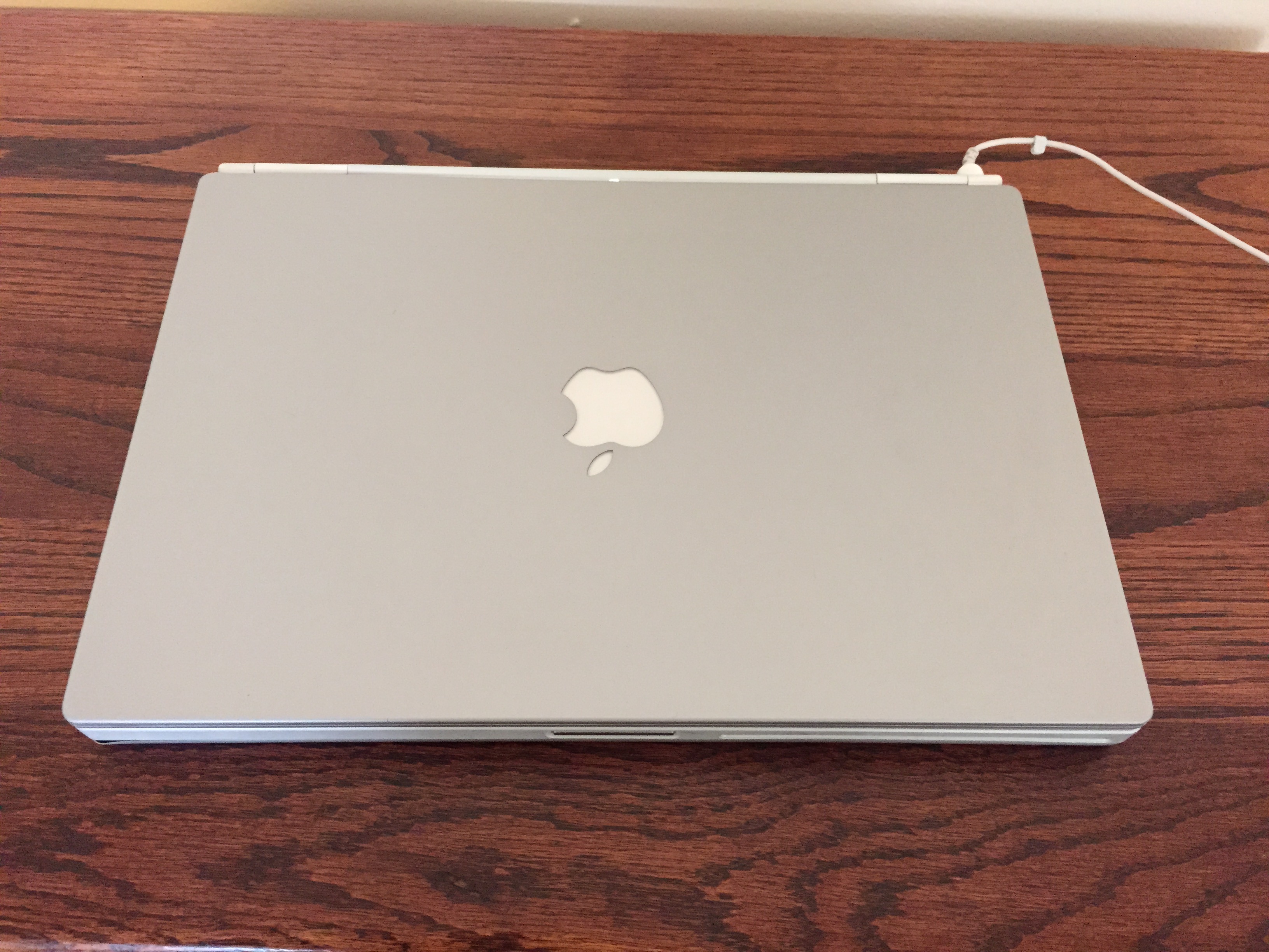

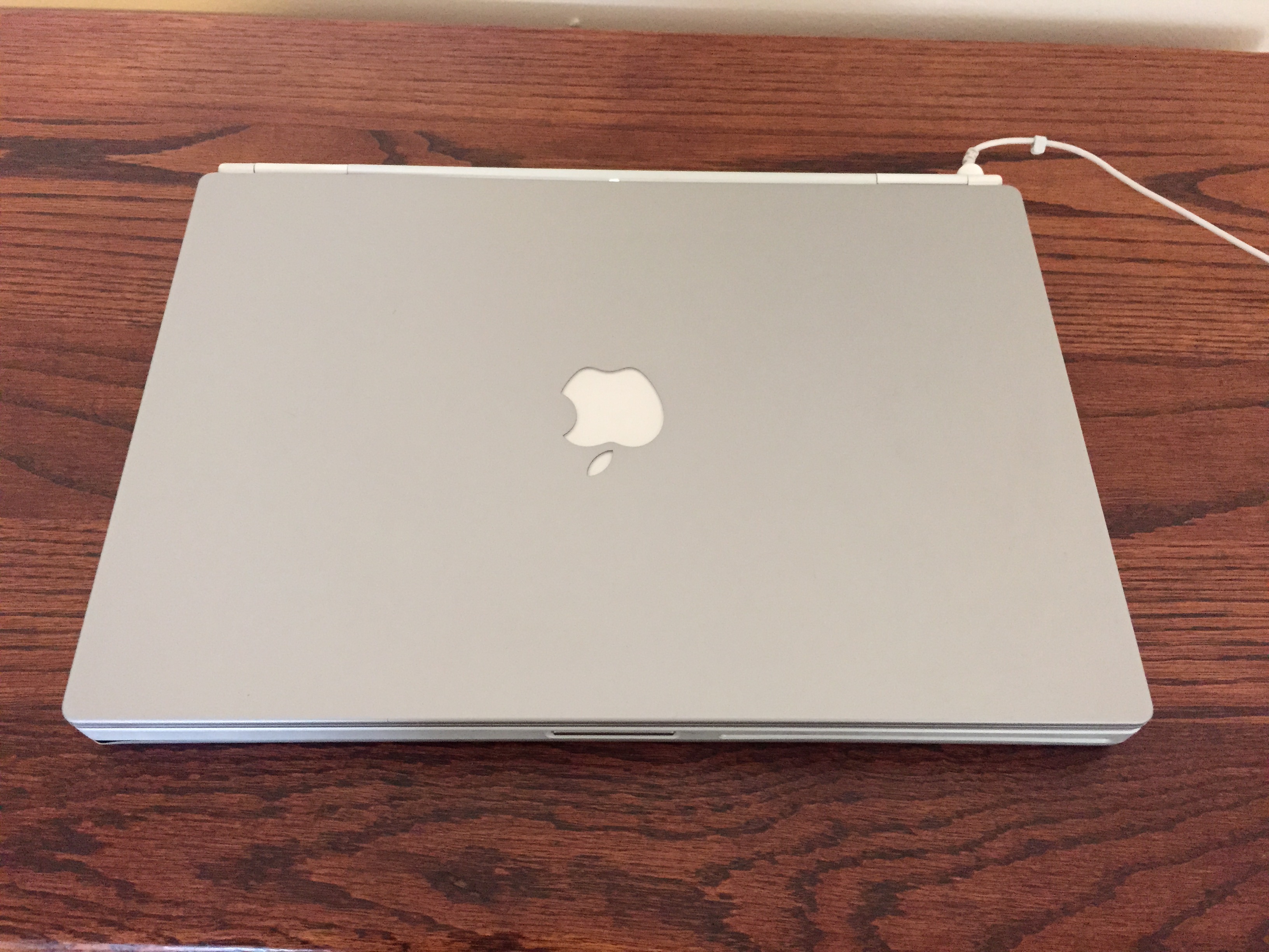

Hi Everyone,
So after a 9 day delay and literal side trip to Hawaii, my 15" PowerBook has arrived in the mail. It's the Titanium 1Ghz, 512MB, 60 GB HD, SuperDrive model- the last of the TiBooks. EBay Link. Full Description: "computer excellent condition.no cosmetic damage. comes with power cord.however battery does not hold charge."
I'm looking for some advice...
1) The overall condition is very, very good physical considering what most TiBooks. There is one little area of cracked paint but nothing too serious. Hinges and great. The charger was still wrapped in the original plastic. After unpacking it, cleaning it up, and firing it up, I have noticed a few issues that are apparent to me but were not disclosed. Reference pictures attached.
  • Screen has white spots.

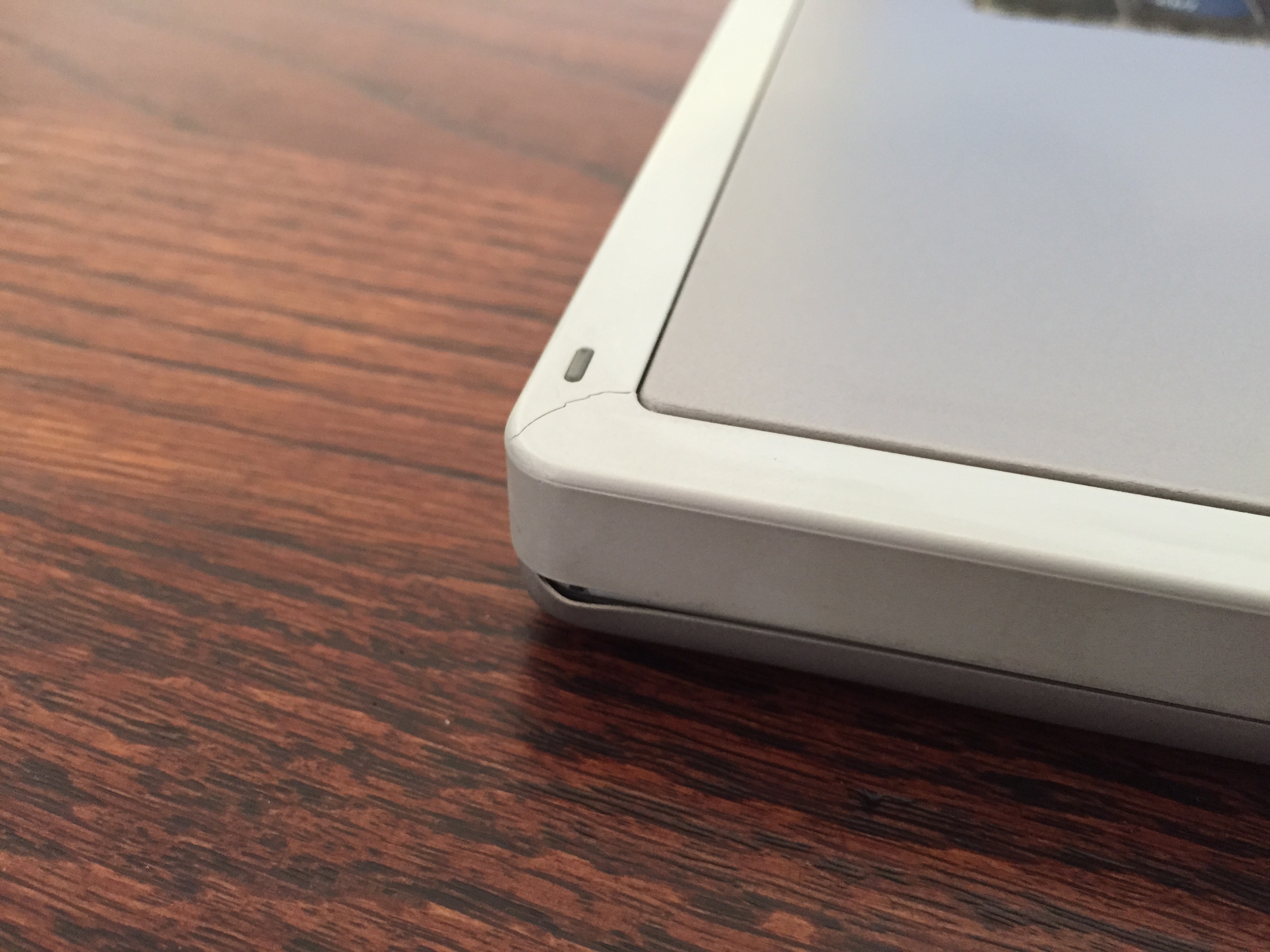

  • Bottom case has small but noticable defect on front corner
  • Numerical button "2" does not work correctly
  • SuperDrive intermittant functionality (about 50% of the time). Sometimes it just spits out the disk
In reality I don't want to send the computer back. The screen I can fix eventually I imagine, though not currently a priority. It's not terrible but it is present. The case defect is minimal but it looks like he intentionally avoided photographing that corner. If I could be fixed with simply a new bottom case. I'm just annoyed these two visible issues were not brought up. The 2 button likely means a new keyboard unless you can still buy the replacement scissoring mechanism. The DVD drive needs a replacement, but so does the PRAM battery (you have to take out the DVD drive to replace the PRAM).
I guess the question here is do you think its worth bringing this up these problems with the seller? I don't believe this was his personal computer so he may not have known about a couple of these functional issues (#2 key + DVD). Have you guys had any luck renegotiating pricing on issues like these? I didn't expect the computer to be 100% being a TiBook and 12 years old, but I would have expected the screen an case to be reported. Ok now the ugly part is out of the way.
2) I'm probably looking to upgrade the ram. Right now were at 2x256. I'd like to upgrade to 2x512 (max is 1GB). Anyone have any recommendation on where to find this RAM at a good price?
3) The battery is completely shot. Any recommendations on a replacement brand? This is kind of a sketchy subject because battery quality can't be assessed over the internet and I've read about aftermarket batteries not fitting correctly.
4) Where's a good place to pickup a PRAM battery for this guy?

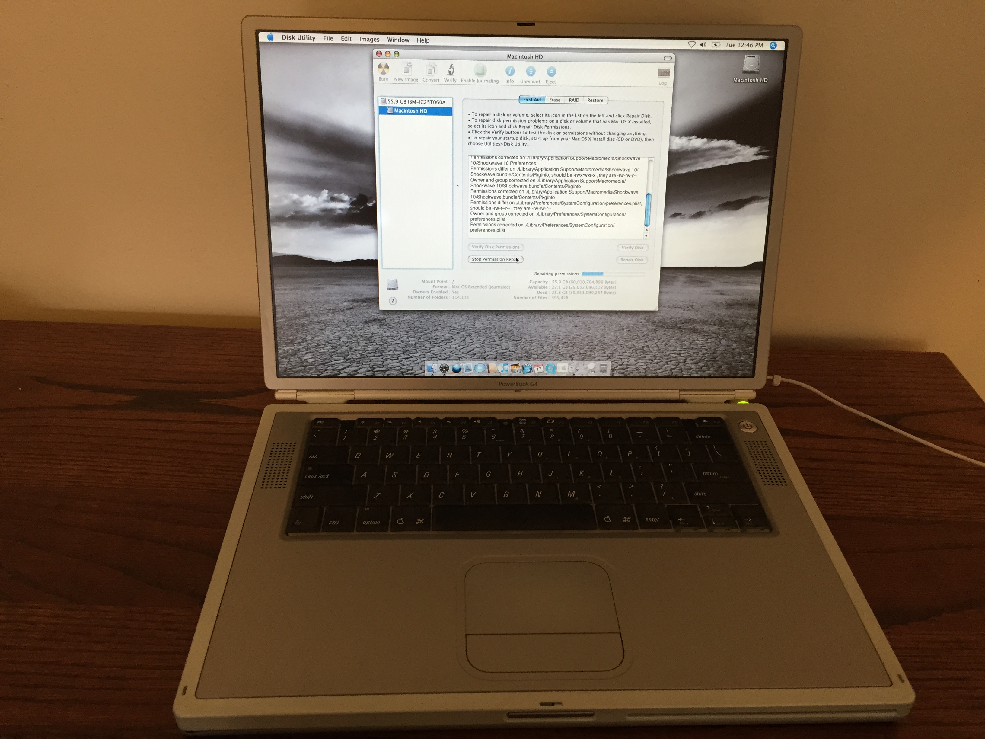

5) OS 9 is installed which is what I want play around with a lot. I can boot into OS 9 but it seems as if there are no drivers? The volume buttons and sound don't seem to work. The screen will flash instead of warning noises. It doesn't seem to recognize the CD drive (when it decides to be function). I'll begin here by making a bootable clone of the entire HD, but where should I start to work out this OS 9 glitch?
6) The computer reports about 1/2 the hard drive being full. It appears 27GB is dedicated the OS X system folder. The hard drive only has one partition. I forget how this works but does this have something to do with space dedicated to OS9 and space being dedicated to OS X? I haven't investigated this very seriously. I don't see any previous user files though.
That's it for questions for now. Here are some pictures.
Many thanks,
Ari

This is pretty good for that old. You should see the case on my son's TiBook. You have a good case.
The cracking just goes with the TiBooks. It will get worse. My case on my old TiBook 400 completely crumbled on me when I went to get the LCD out for my son.

5) I'd reinstall OS 9. Sounds like a bad install or not the correct version for that machine. There's a restore set on Macintosh Garden you could try the OS9 CD from. I used it on mine successfully even though it's from a later DVI model.
6) The default dual boot setup has OS 9 and OS X on the same partition. Giveaway is a "System" for OS X and a "System folder" for OS 9. As far as I can work out you have to pick via the Startup Disk preference as both don't show with an option boot.

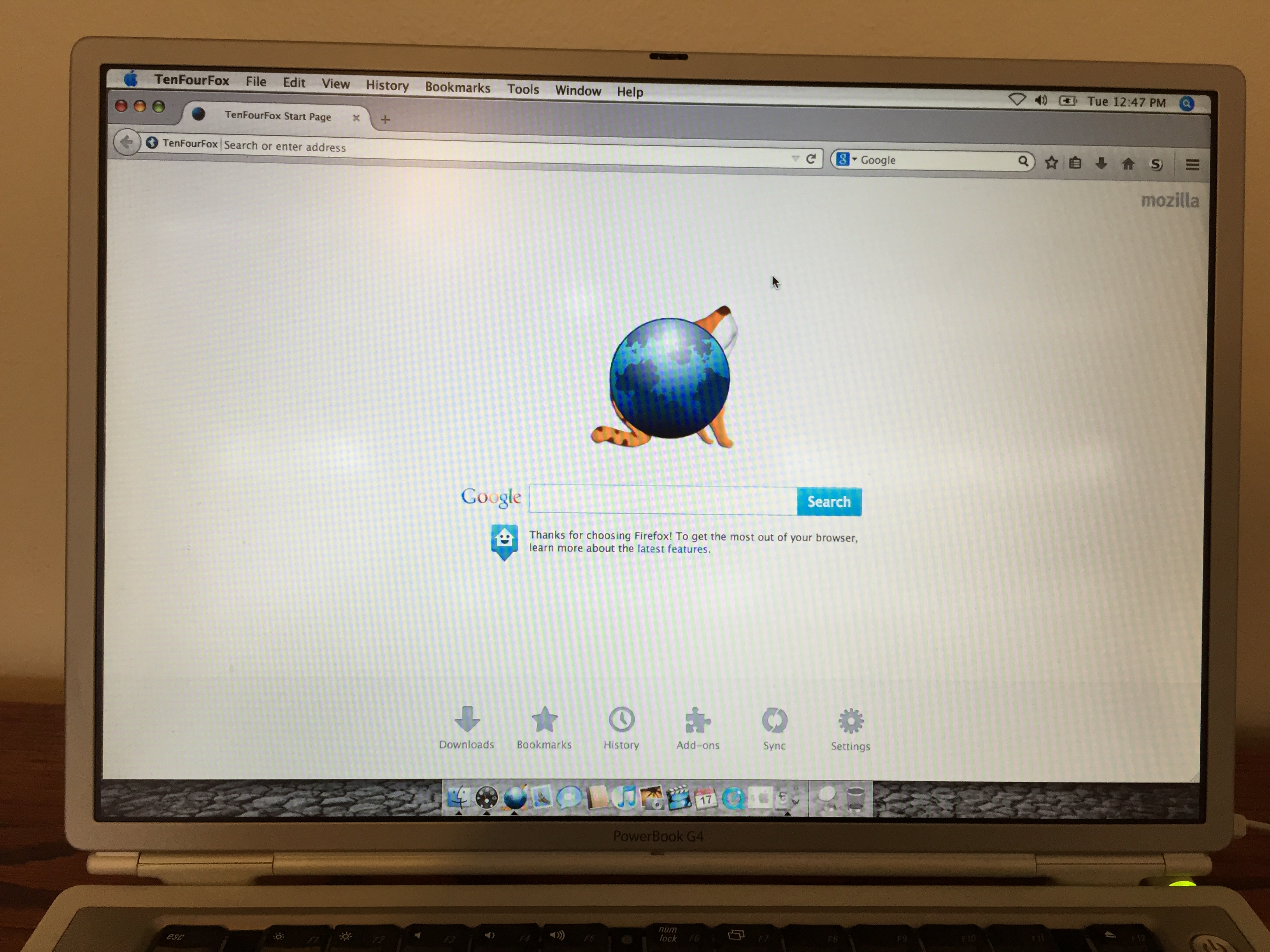

So I got $25 back from the seller which is decently fair. The optical drive held up long enough to get OS 9 installed. Earlier in the day I just played through a music cd to give it some action. I thinking a cleaning will hopefully solve the issue.
I had some trouble getting online via ethernet but I guess the problem was I had to fake my way through the internet setup, which I did and everything runs good.
I tried to download Classilla but their download isn't working. I tried to get if off macintoshgarden.org but they reject my current Internet Explorer browser. So I'll have to do some hopping around between web browsers and OS' tomorrow.

I know you're having problems and that sucks and I'm sorry but that is one sexy TiBook in outstanding shape I would have paid more for it than you did.
I'm very happy with it despite the little issues. The I have essentially reinstalled OS 9 so thats working well. The DVD drive after playing a CD through and doing some burning appears to be working much better. I've ordered a cleaning CD.
The keyboard is a $10 replacement and a quick fix.
The screen I can live with for now. Cheap part, ridiculously annoying repair but when I do it I'll just buy the whole screen assembly.
The bottom case isn't terrible. It's barely noticeable. A new bottom case will do the trick.
New battery is on the way
I'm happy that the logic board and inverter are good, the hinges are clean and straight , the paint is in tact, and the latch works.
And I am getting $$$ back from the seller.
So it's all good.
