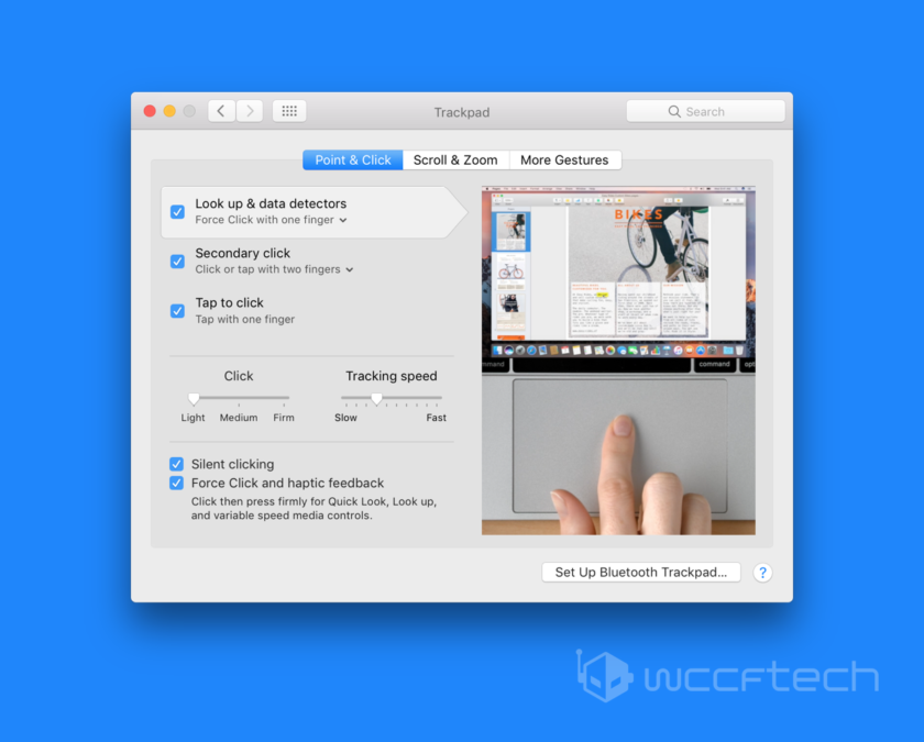

Probably be a stupid question, but just double check the trackpad settings, is silent clicking on?
Not a stupid question but that has nothing to do with haptic feedback.
This controls whether or not your Mac makes a sound when you 'click'.
This image isn't mine. On my Mac, Silent clicking is checked—haptic feedback works just fine (mine is set to Medium and Tap to click is off).
It does bring up a question. Does playing with the Click settings have an effect?
Hmmm, I can definitely feel a difference between light and firm on mine (with light being almost undetectable, especially if silent clicking is on), but now I think you have a bigger problem than that.
