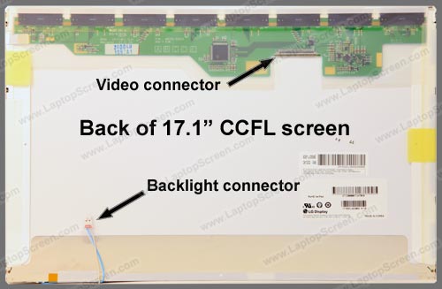

Hi, I'd recommend cutting the metal (as described here) no matter what LCD panel you're using since putting the display assembly together with all the hooks (which will get severely bent in the process of disassembling) is a very hard task. At least I've found it impossible to get the backlid and the front bezel back together otherwise. Also I wouldn't want to unhook all the clips again in case I decide to swap the panel again. By removing/ripping out the metal clips and reglueing some of them you can swap the panel in matter of minutes and it has come in handy for me again when I built my second WUXGA PowerBook. Moreover, the mod will not really impact the sturdiness (meaning it will be held together just fine) With that said, regarding the correct CCFL cable length you have to look at the backside of the panel where the CCFL cable comes out. Let me explain with pictures:
You want to look it like that:
The CCFL cable comes out very near the edge of the LCD.
You do not want to look it like that:
The CCFL cable is much further away from the edge of the LCD and that makes routing it through the intended hole impossible.
If you decide to cut the metal like I'd advise you to do anyways, you can also put LCDs like above in (because the metal clips are no longer in the way and that makes routing the CCFL cable in other ways possible). With the metal sheets still in place you would most likely pinch or even cut the CCFL cable when you try to route it in a different way.

I took a trip to ebone and indeed, many LCDs have backlight cable, that comes out not at the corner. I also got an impression, that the cable is simply taped to the LCD panel, but the real opening is more or less close to the corner. Since you have seen several 17" panels in person, is it so or am I just imagining things?
You are right. On most LCD panels the cable is taped to the LCD panel making it appear even more away to the corner than it actually is. What you need to pay attention to is where the cable actually comes out. LP171WU1(TL)(A1) is a good example where the cable comes out perfectly for installing it in a 17" PowerBook G4. The LP171WU1(TL)(A2) isn't but you can still install it when you mod the lid.
To be honest I have yet to find a 17" panel that didn't work with my 17" PowerBook G4. As long as the LVDS pin count matches and the panel is CCFL backlit you should be good to go.
