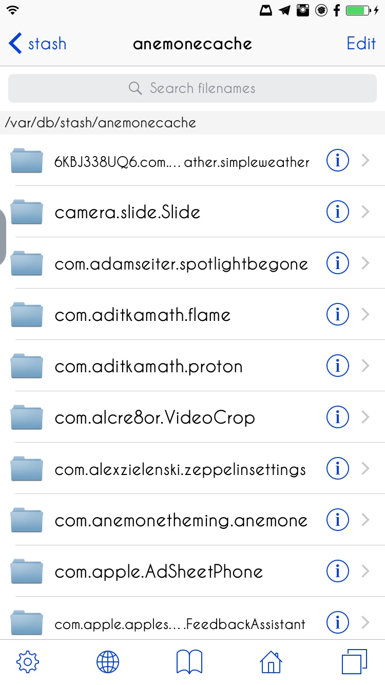

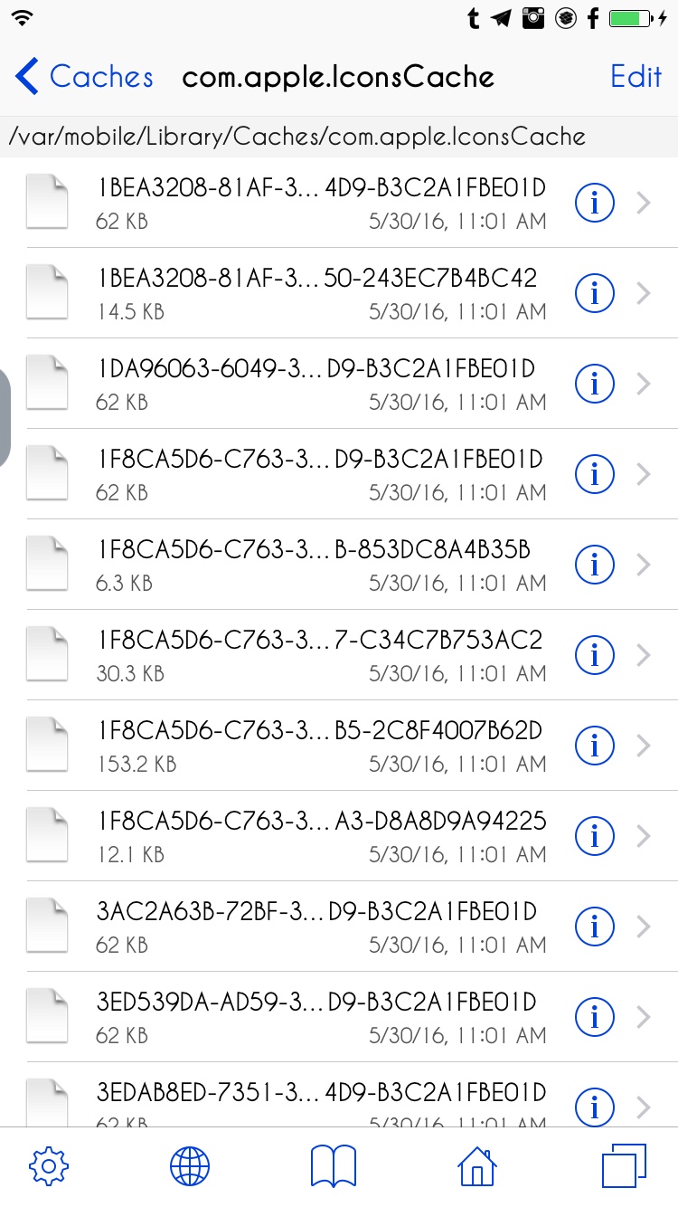

I found that also..... And then this..... But to be honest I don't know what will happen if you mess with them. Weird thing is iCleaner should work.
Also, there have been changes to iOS's file systems since 7.1.2 ..... I'm on 9.0.2, so things may look or be different for your device . Hope you get it figured out.
Also found this..... Might be named winterboard for yours. Not sure
